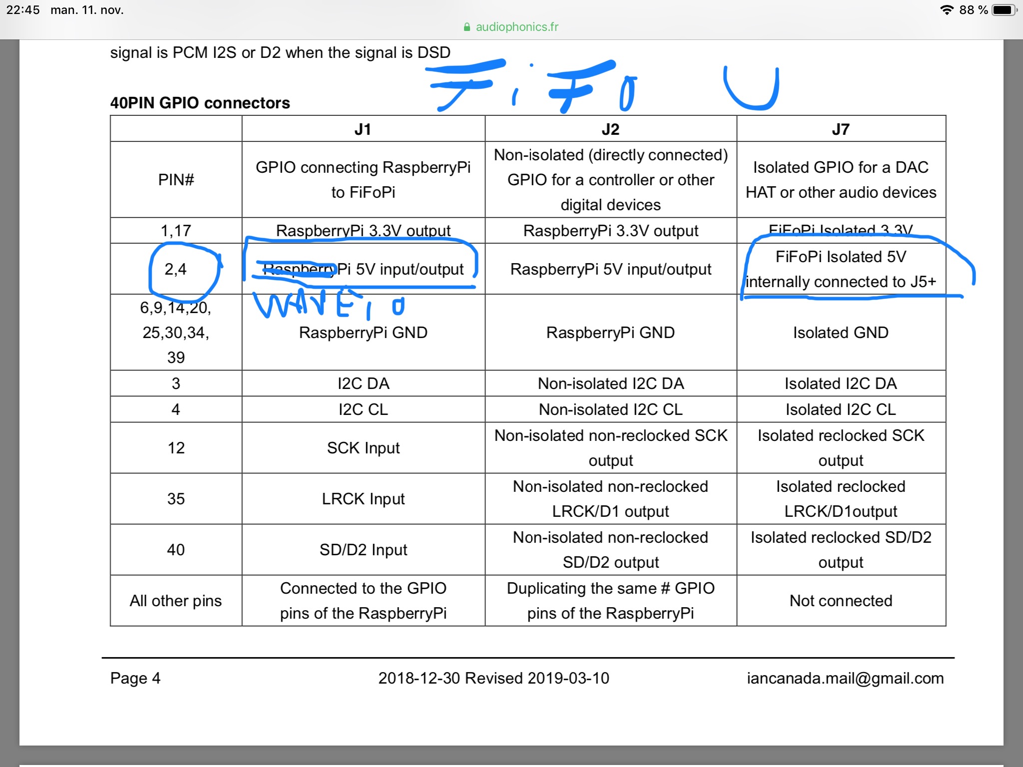

Anyone here who have tried Ian’s fifo ultimate hooked up to waveio ? My Aurender have only usb output, and I also like the sound very much, so waveio stays, and Ian’s latest reclocker with the Accusilicion chrystals look very promising.
I wonder if I can power fifo from the 5v ldo reg on dddac mainboard ? It is the same reg that feeds i2s isolated side on waveio. I think 500mA is enough for both waveio (isolated i2s side) and fifo.
Anyone ?
Fifo 40 pin connector. Read waveio instead of Rasberry (J1) Pin 2 or 4 + any of the gnd pins is what I’m thinking can be a way to do it.
Anyone ?

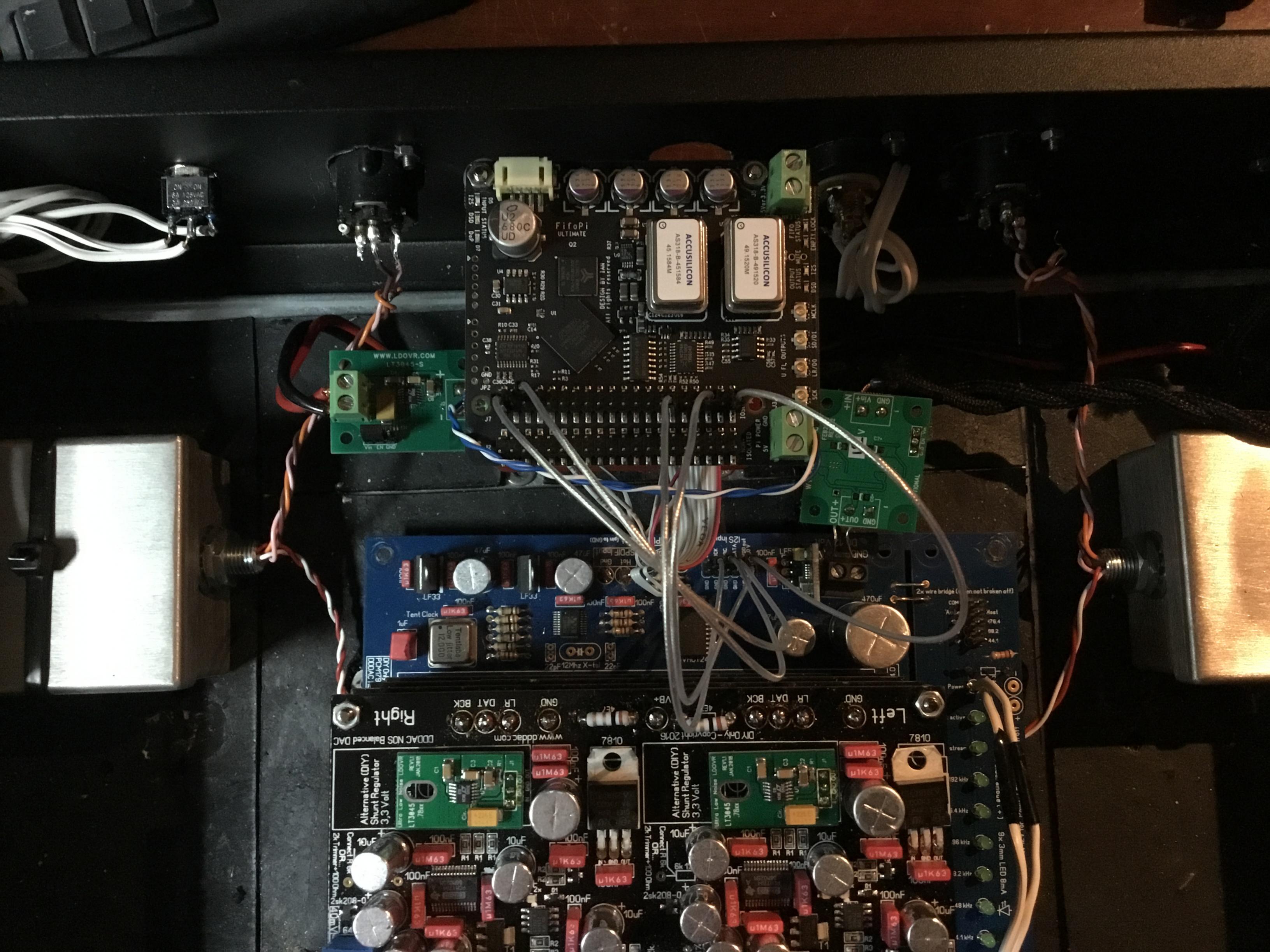

I have bought one and using it with a Pi and Roon so bye bye waveio if it works out

I tried the 22/24 Kali with my WaveIO. Powered by LDOVR LT3045 reg on main board. Sowter trf. MacBook Pro/Audirvana.
At first I thought wow this is good. More details and a bit tighter bass. After some listening it started to get really uncomfortable. Connection to music totally lost. Just a lot of details with no coherence. Nasty upper midrange. Tried running it for a week. No improvement at all. WaveIO is now back and all is fine.
