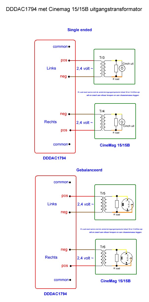

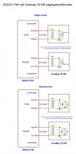

The Cinemags should not have any connection with DDDAC common; just with a positive and with a negative out's. All the static shield wires and the Cinemags' case wire, should be connected to the amplifier common/ground (or the pre-amp common/ground). This is going to provide a full isolation between dirty DDDAC common and clean analog common.

Can you or anyone please provide me with the wiring schematics of connecting Cinemags to the DDDAC so I can recheck where I have gone wrong in my build.
https://audio-creativeshop.nl/wp-content/uploads/DDDAC-Cinemag-uitgangstrafo-1.jpg
