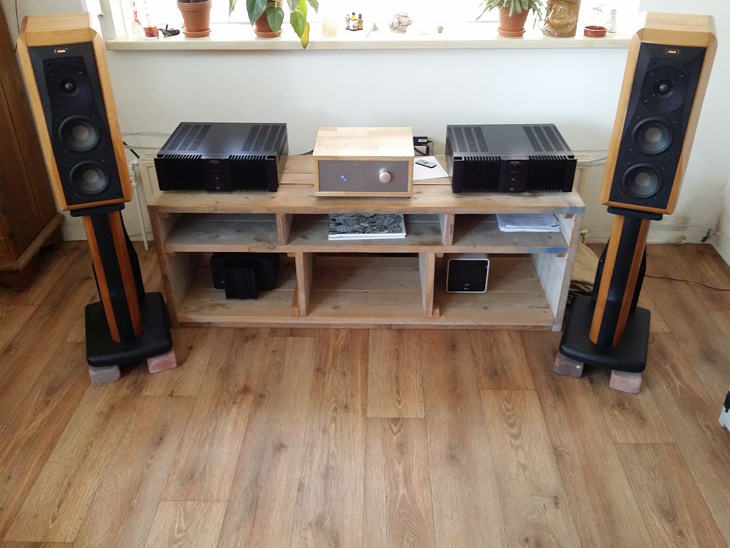

After a long building period I'm finally very happy and proud with what I've accomplished, DDDAC 1794 NOS Streamer
Just a list with most of the things I did in the recent years to create my personal view on sound with Doede's creation.
The TVC's were such a positive upgrade, I was stunned. Never heard such silence within the music, incredible. I sold my "active" pre-amp as a result.
I have to be honest, without assistance from Doede, Dick van de Merwe, Peter de Bruyn and Hans Braam I probably wouldn't got this far so big thanks to them
Cheers, Paulus

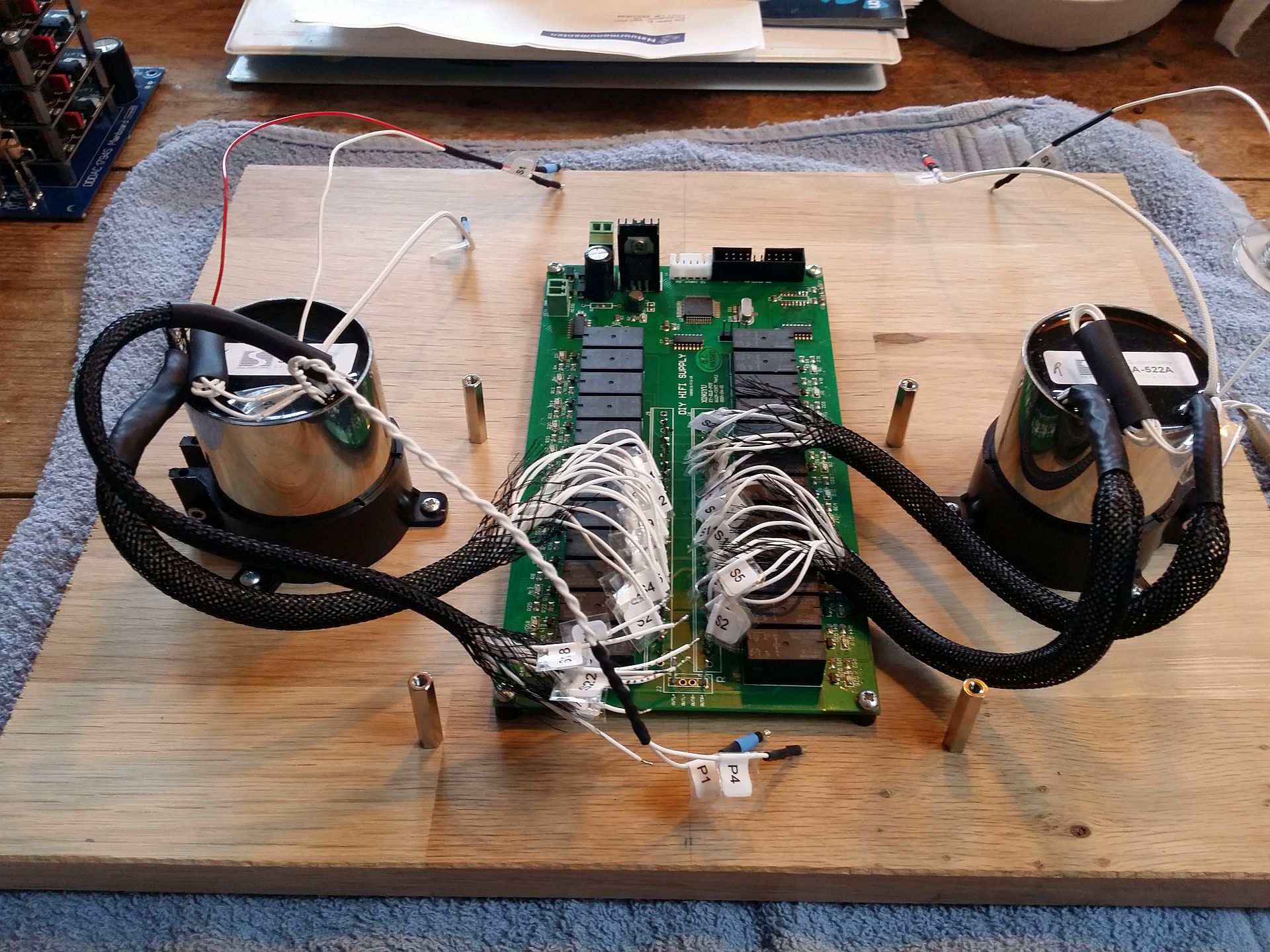

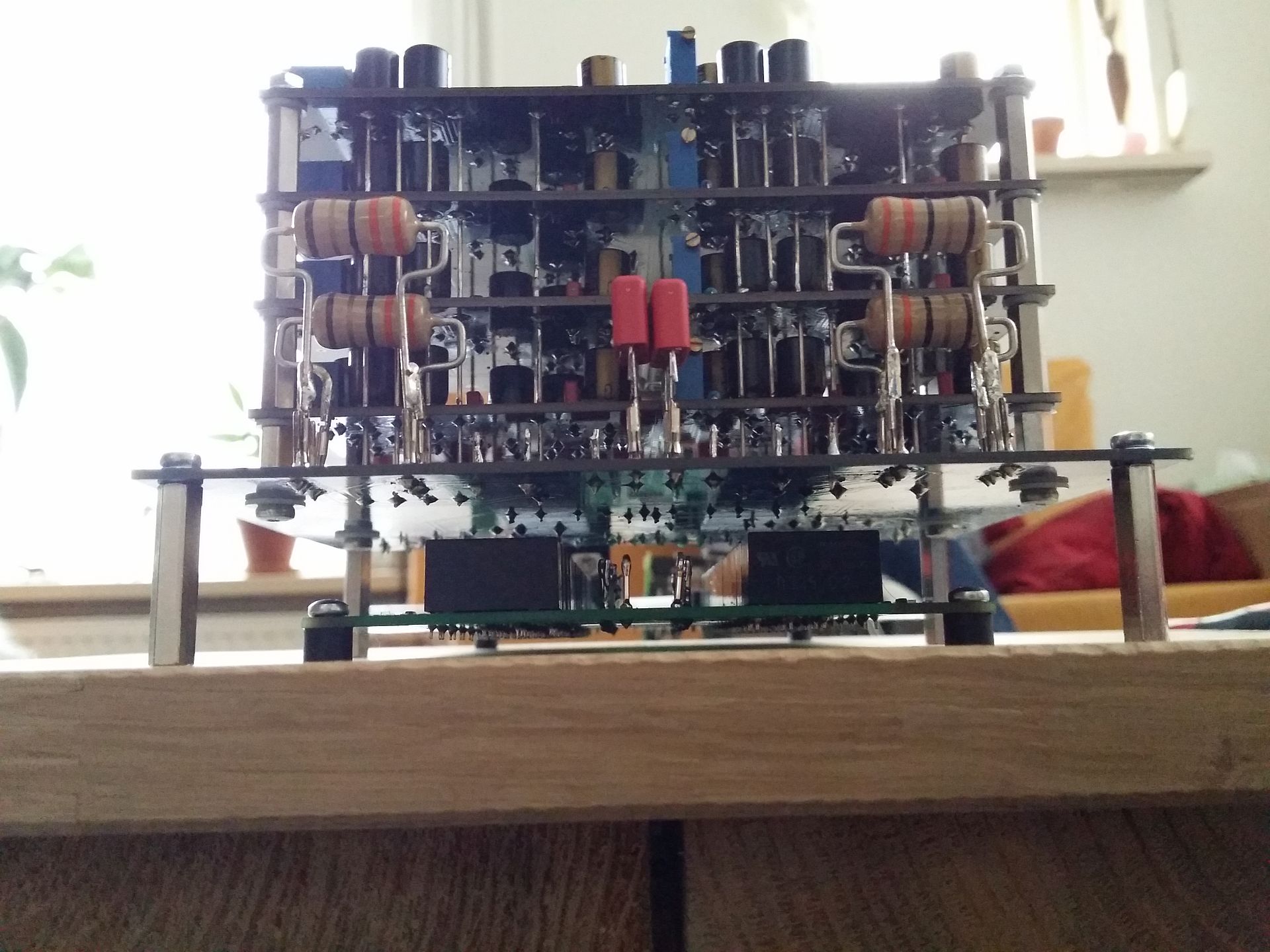

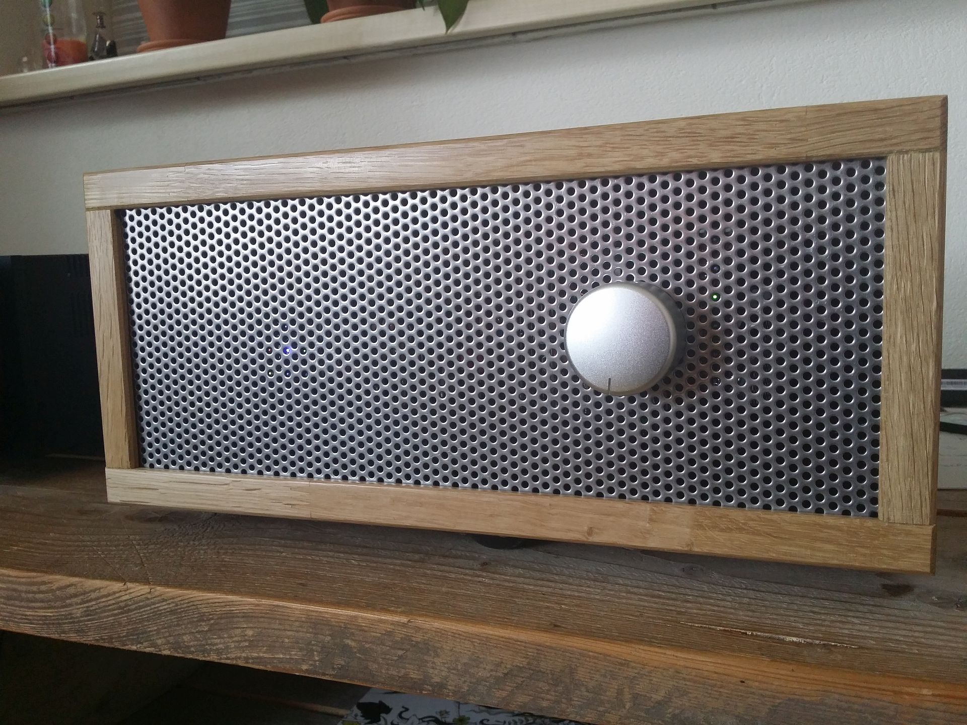

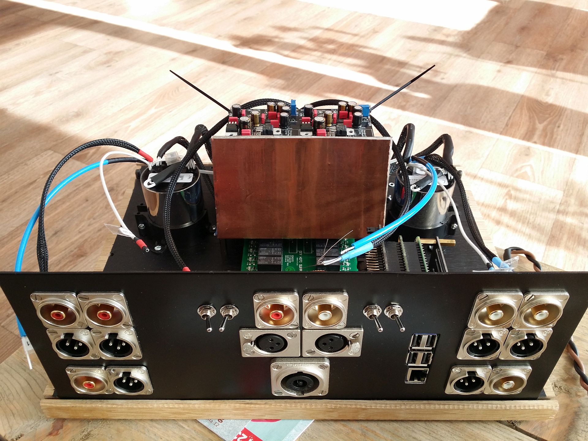

- from 2 to 4 decks
- symmetrical setup
- changed Rload from stock to Tantalum Non Magnetic (2 Watt type)
- Rpi 3b with Volumio
- ALLO Isolator with Kali
- integrated Silk TVC's
- integrated remote control for TVC's
- Almost every connection (silver) bare or with "air" interlink
- changed MBR20200 in psu for full wave bridge rectifier

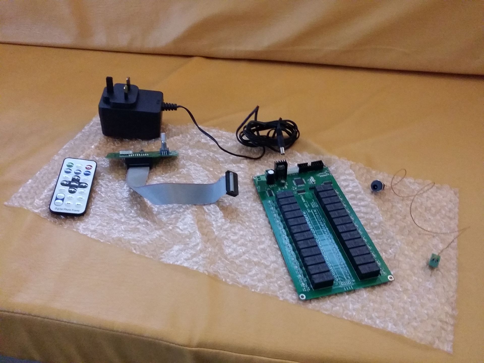

Good stuff! What relay/remote board did you use for the TVC? I made my own relay controller for my first TVC (without remote), but I might need another one for my current build...
I bought this board at Acoustic Dimension (.com) in the Netherlands.
You can find it under "modules" on the website.
Ah, 23 positions only. My Sowter TVCs need 26. Either I'll make another one of my own modules, or convince Shallco to sell a suitable switch to me. Both needs a bit of work.
Hmm, on the other hand you could consider not connecting the last 3 taps (or 3 others) of your Sowter TVC.......
I never ever reach full power, it would blow my speakers to kingdom come
I have to make my apologies.
As an amateur I was under the asumption that the MBR20200, due to the 2 diodes it contains, was a half wave rectifier, but......
The specified transformer in the stock PSU designed by Doede has a centertap.
With the ct and 2 diodes you create a full wave rectifier.
As i do not use the specified trafo and the one I use does not have a ct i needed a full wave rectifier.
Thanks to Dick van de Merwe in correcting me on this.
No need to apologize for learning new things here! That’s what it’s about. Great looking build on your DAC! I’m curious about all the connectors on the back side. Do you have multiple inputs or outputs? I am not familiar with the TVC’s. Could you provide a link or the name of the supplier? Do they run single ended or balanced? I have only 1 board at the moment in my DAC and I am considering upgrades. It really looks like you have efficiently packaged a lot of content into 1 chassis and very professionally done as well!

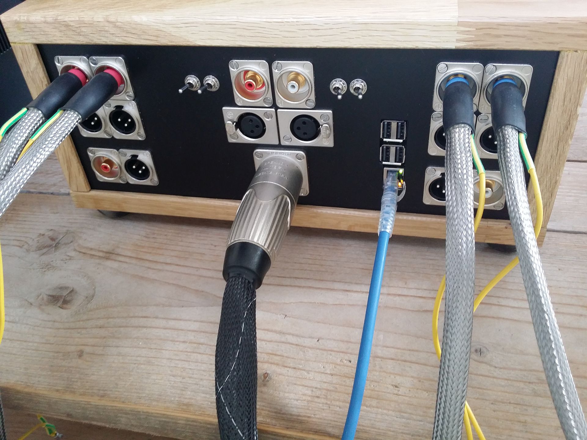

Hi there Bfpca,
Thanks for the kudos.
The TVC's were bought at: Acoustic Dimension dot com, check "transformers" and scroll down to Silk Audio.
They run both, single ended or balanced.
I have one input, thats the one just above the umbellical cord from my external PSU
I have created multiple outputs:
Straight out DDdac balanced
Straight out DDdac single ended through Cinemags 15/15b
Output through TVC's
Balanced
Single ended (connected in the picture, play bi-amp)
Cheers, Paulus
