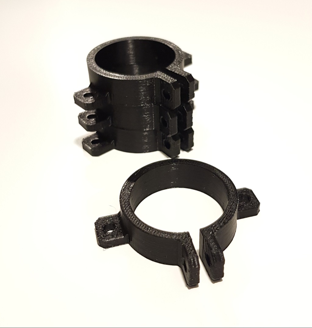

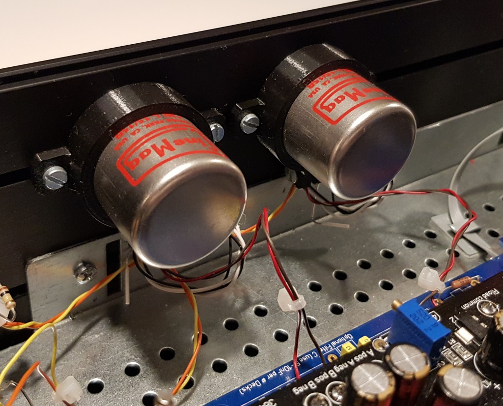

I struggled a little bit with how to mount a couple of Cinemags (in this case 15 / 15b without studs) neatly.
Looking at the forum images I'm not the only one, that's why I want to share my mounting method: a holder printed with a 3d printer by a colleague.
If you have a 3D printer or know someone, this is an easy and neat solution.

Nice solution using modern technology. When I built my First Watt F5 V3 monoblocks I just coudn’t use the cheap thin metal brackets that came with the Jensen input transformers I installed. I had some small pieces of 1” cherry so I used a Forster bit to drill a hole about 1/4” larger than the transformer partially through the wood. I then put some silicone in the bottom of the hole and embedded the transformers in it. Mounted the blocks to the bottom of the amp with 2 bolts.
3D printing is an ideal solution for his kind of low volume small part.

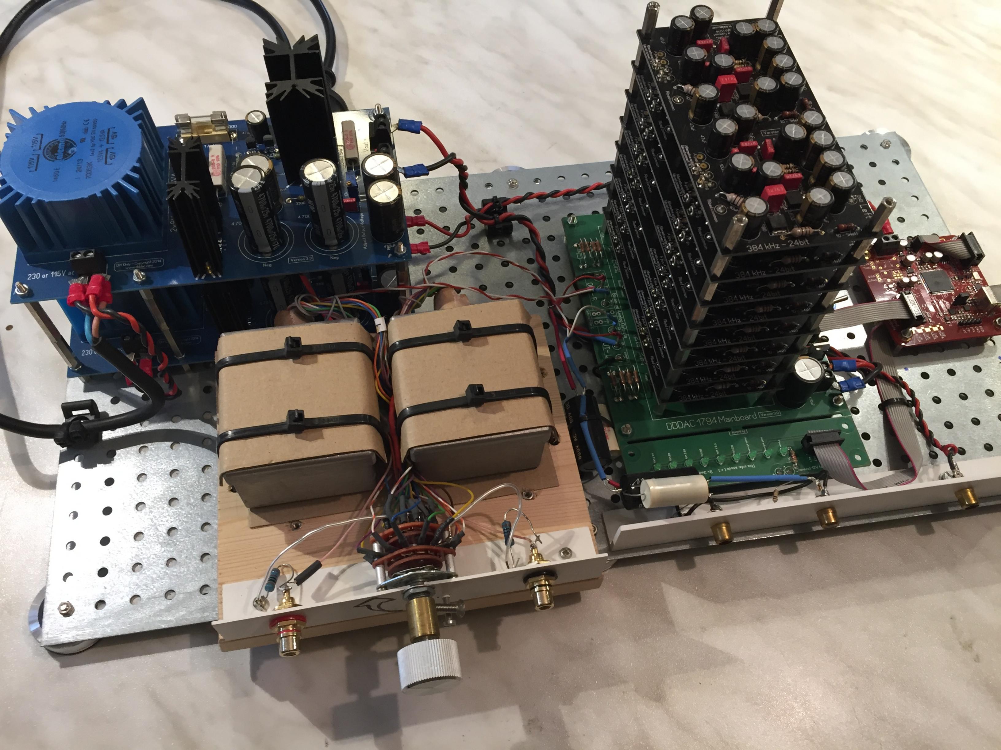

Would anyone be interested in this ? I used it for demonstrations, hence the simple build. Of course you can fit this in another chassis. It is with 8 of the "old" boards!
Of course 100% OK and it is a full system with the special DDDAC-Sowters Output - but as a 12 steps TVC version. (I use a 18 step version right now by the way)
So no need for a preamplifier, can go straight to the end amplifiers
