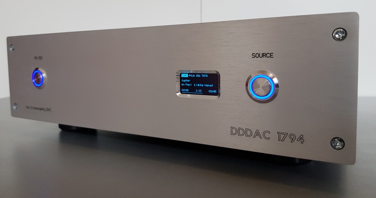

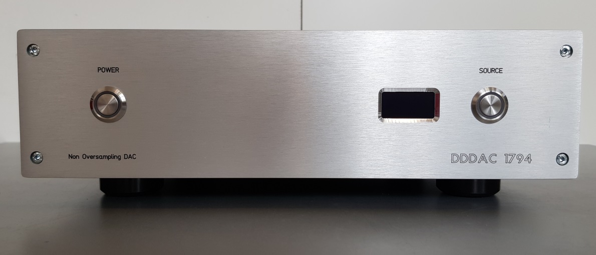

Thanks for keeping me busy last year; reading this Doedes site and the forum with more than 6000+ posts in 7 years takes some time ;-)
All due the journey isn't over yet, I'm finally reaching the level that my build is livingroom approved.
And offcourse very satisfied with the sound.
I am already looking forward to the next improvement.
Best
Marcel

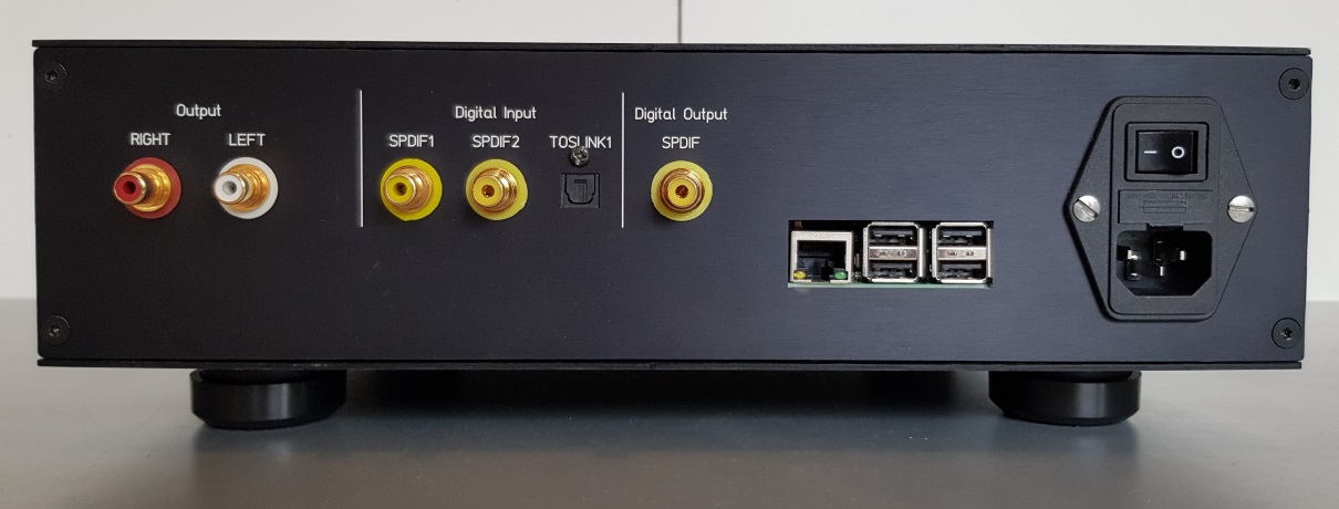

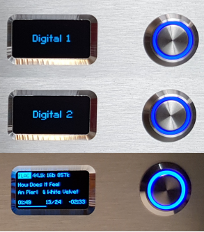

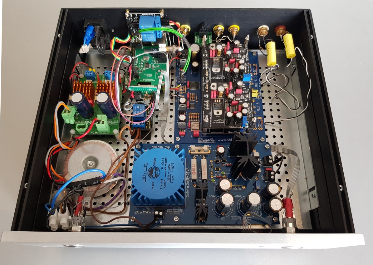

The build contains two momentary buttons for power on/off (Tiny85 controlled) and source select (Pi controlled).
An amoled display shows the selected source of stats from a MPD server (like Rune and Volumeio).
SPDIF out is used to compare the sound results with my reference.
Best
Marcel
