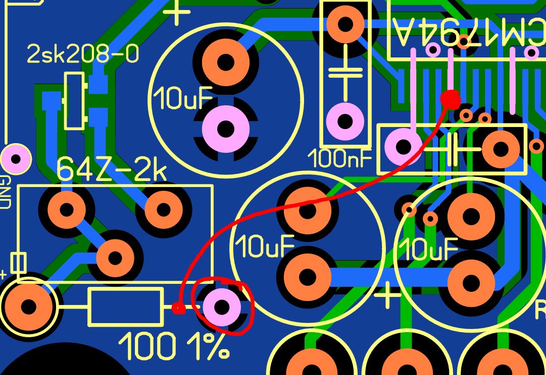

Hi All,
After all these years, I have recently been interested in 1794 DAC so finally went
through this thread - wow, that's a lot of work and the results look fantastic.
I have a couple of questions
- what is the purpose of using CCS for IREF?
There was some discussion over at TI and they recommended to connect R for
Iref directly to Pin 19 (A GND).
- By using 6k how much does OP current increase? Standard is +- 3.9mA / phase.
Looks like great DAC!
cheers
T

Thanks for the flowers 😉
The CCS is giving the same current (4,0mA) but with a much higher resistance (thanks to the CCS as compared to the 6k resistor). This helps decouple the bias system and it sounds (indeed) better. simple trick, good result

You are welcome 🙂
So higher impedance (resistance) appears to be more important than noise
per se, as the CCS will feed higher current noise into IREF which is
essentially a current IP point being of fixed voltage.
I'm just trying to understand the mechanism at work here - not to be critical.
Did you have 6k resistor terminated right on Pin 19 separate to ground plane
as recommended by TI?
T

OK , let me give some background - probably interesting for the other readers as well -
The version 1 of the dac, as described on my website, has the 6k resistor. The CCS has been introduced in version 2. Many listening test showed improved sound quality. Similar improvements as in power supply improvements.
In terms of noise in the audioband, the S/N ratio from the current source noise ending up in the reference current is -107dB. The thermal noise of the 6k resistor delivers -110dB (at 1MHz for example it is -90dB versus -93dB)
I believe more important is the ~ -40dB damping the current source is giving on any power supply noise coming from pin 20 versus using a 6k resistor for the bias current. As the FET has less gain in higher frequencies, The point where the damping is equal to a ideal resistor is 22MHz. But truly, I do not thing a resistor has no inductance at that point playing an important role, so all in all, the CCS has clearly better performance in noise and power supply noise suppression in the bias current.
And most important, listening test unanimously shows that as well 🙂

Interesting thought of course to keep the loop as direct as possible. No, the return path has been in both versions on the ground plane, which is pretty solid and not too noisy in that corner of the PCB. So hard to tell if it would have made any difference...
anyone who would like to experiment, could try what is below in image.
In stead of soldering the 100Ohm resistor to GND, wire it directly to pin 19 (Analog GND) In this case there is no ground plane in the return path...
