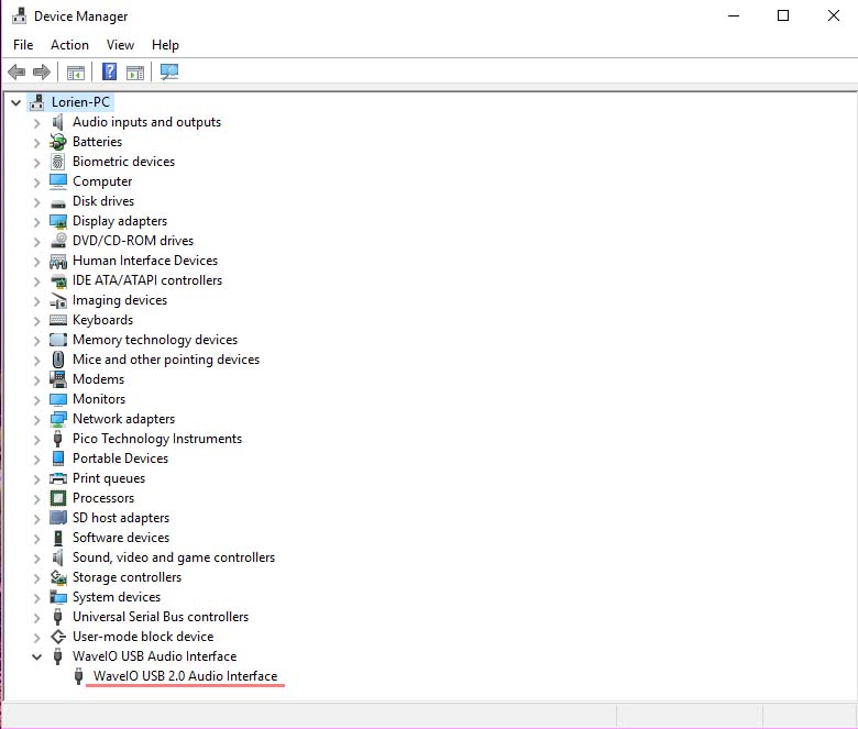

Just wanted to check with everyone, that if I am using a 4 stack configuration with the old (Red) motherboard, will my DAC be detected successfully on a Windows 10 system? I want to use the latest versions of the Bug Head Player and the new ones only work with Win 10, so want to confirm.

Yes, to be technically correct what I meant to ask is that is the waveio device detected properly in Win 10? Since originally doede shared the drivers till win7, i want to make sure that an upgrade to win 10 will not have any issues. Also, has anyone tried the bug head player?
@ Jan: thank you for support! Informations about me are correct!
@ kartick: WaveIO is properly detected on Windows 10. In fact, right now I'm testing a board for someone else and I can post a picture about how can WaveIO is shown in Windows 10 "Device Manager".
For other questions regarding WaveIO please use this thread.
