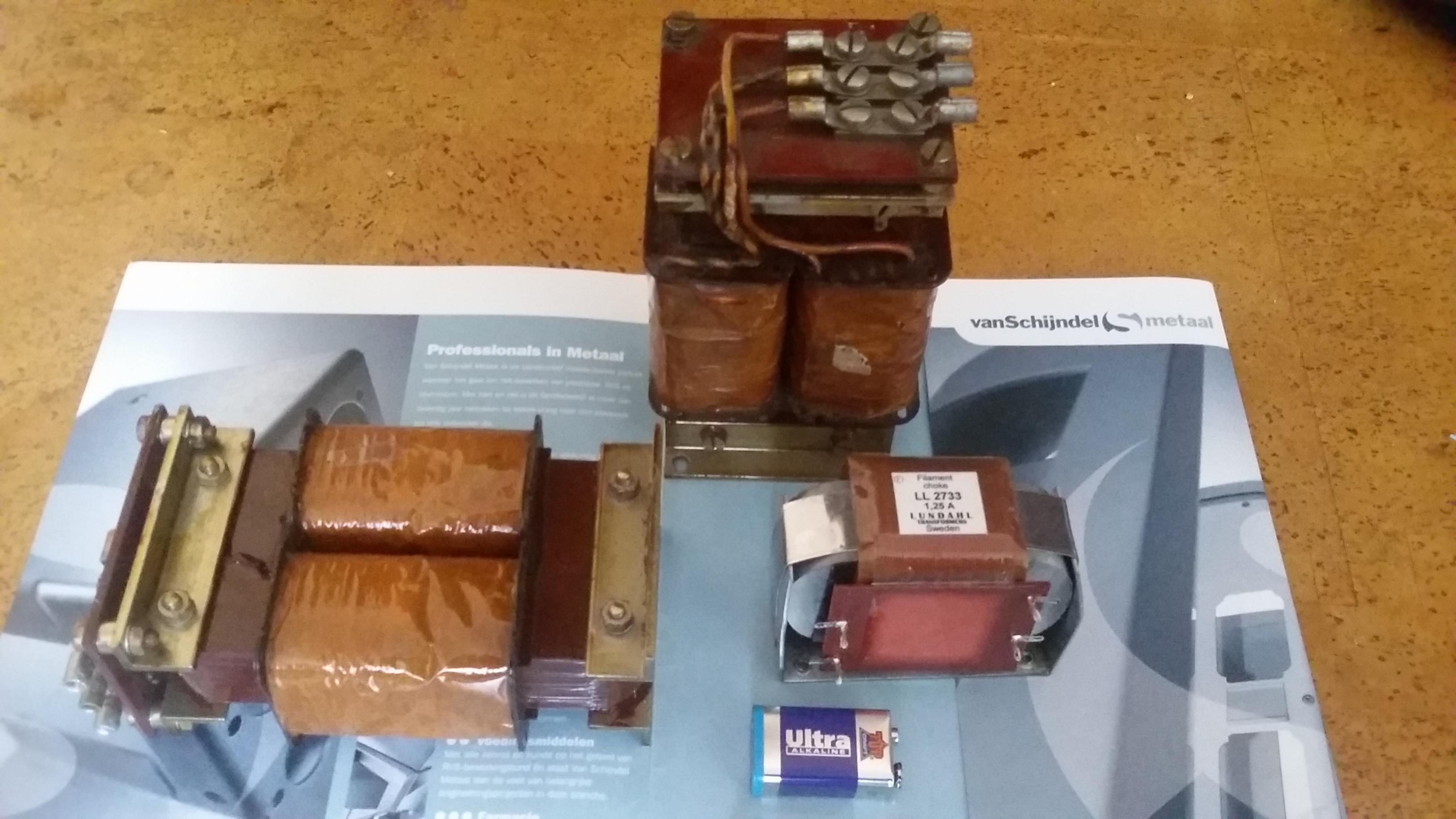

Chokes
Hello,
Because i did use or did decide to use in the near future for other projects i had to get some new chokes for my future dddac.
I did find these in a surplus store . One is 2×97mH the other one is 2×660mH . They can be connected the same way the lundahls are connected( differential mode).
Current rating is high enough to use a few boards with shunts. At the time these were made by Telefunken copper prices were not that high so thick wire was not an issue.
The lundahl in the pic is the ll2733 which will be used for heater supply in a vt25 tube amp.
Greetings, eduard
