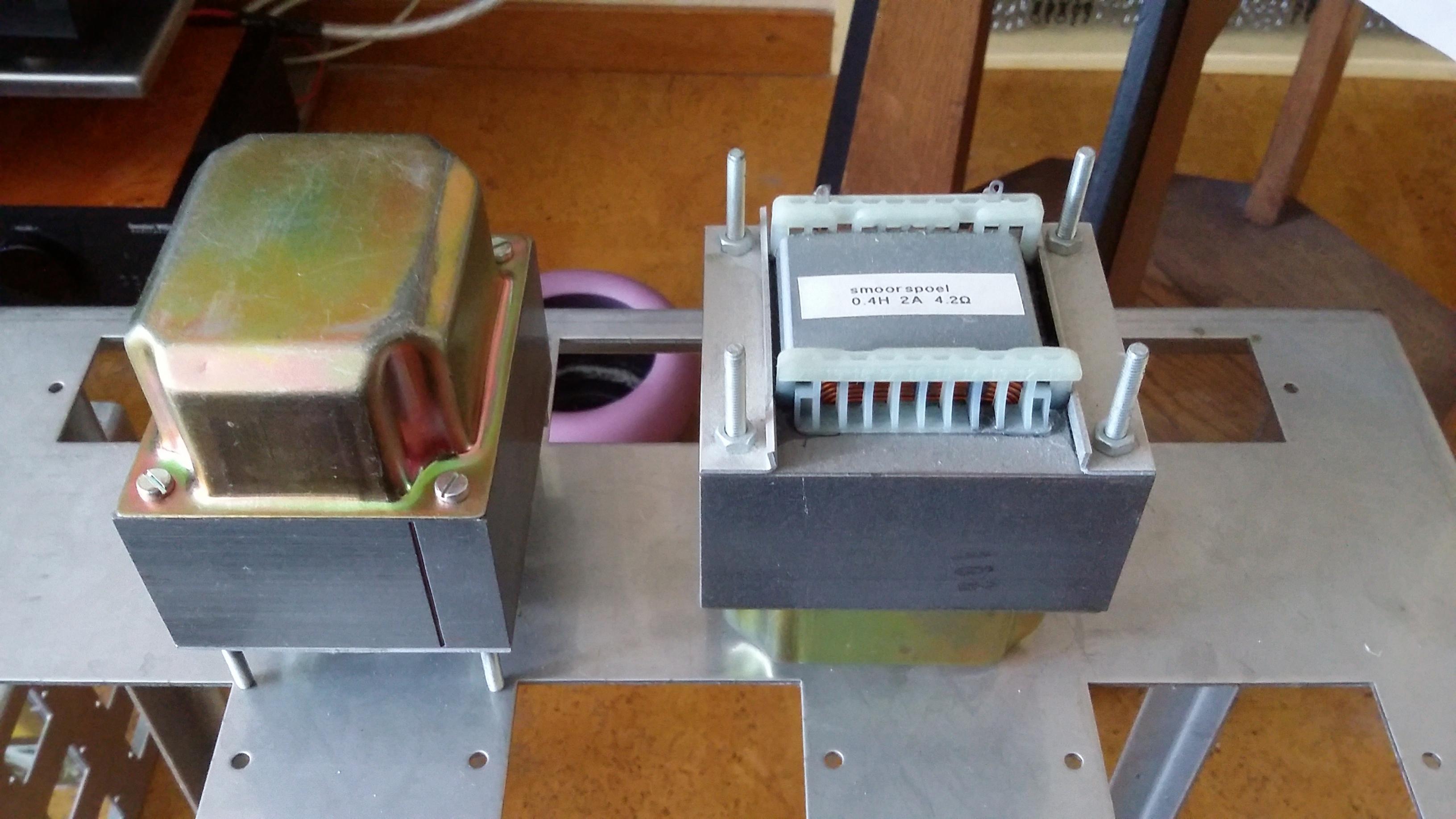

chokes for sale
Hello,
Did put 4 chokes for sale on the swap meet here for the people who think the lundahls are to expensive.
I am willing to add some metal work for the people who are afraid that they will not succeed in mounting them properly. I can make an aluminium panel that can hold one or more chokes, a big bleeder , some caps up to you.
Greetings, Eduard

Hi Edward,
I am keen on the chokes. May consider all four. Let discuss on pm?
Chanh
