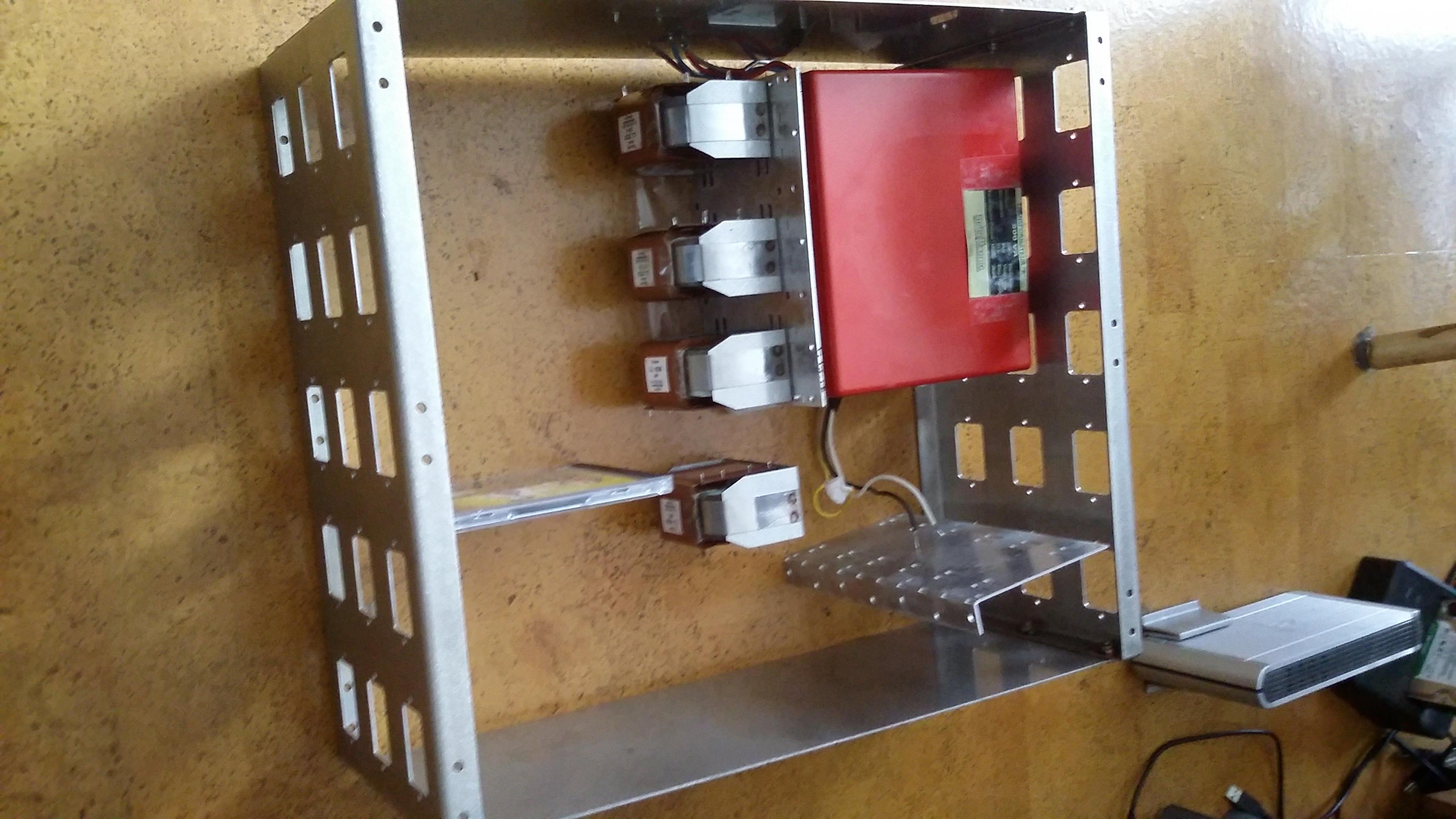

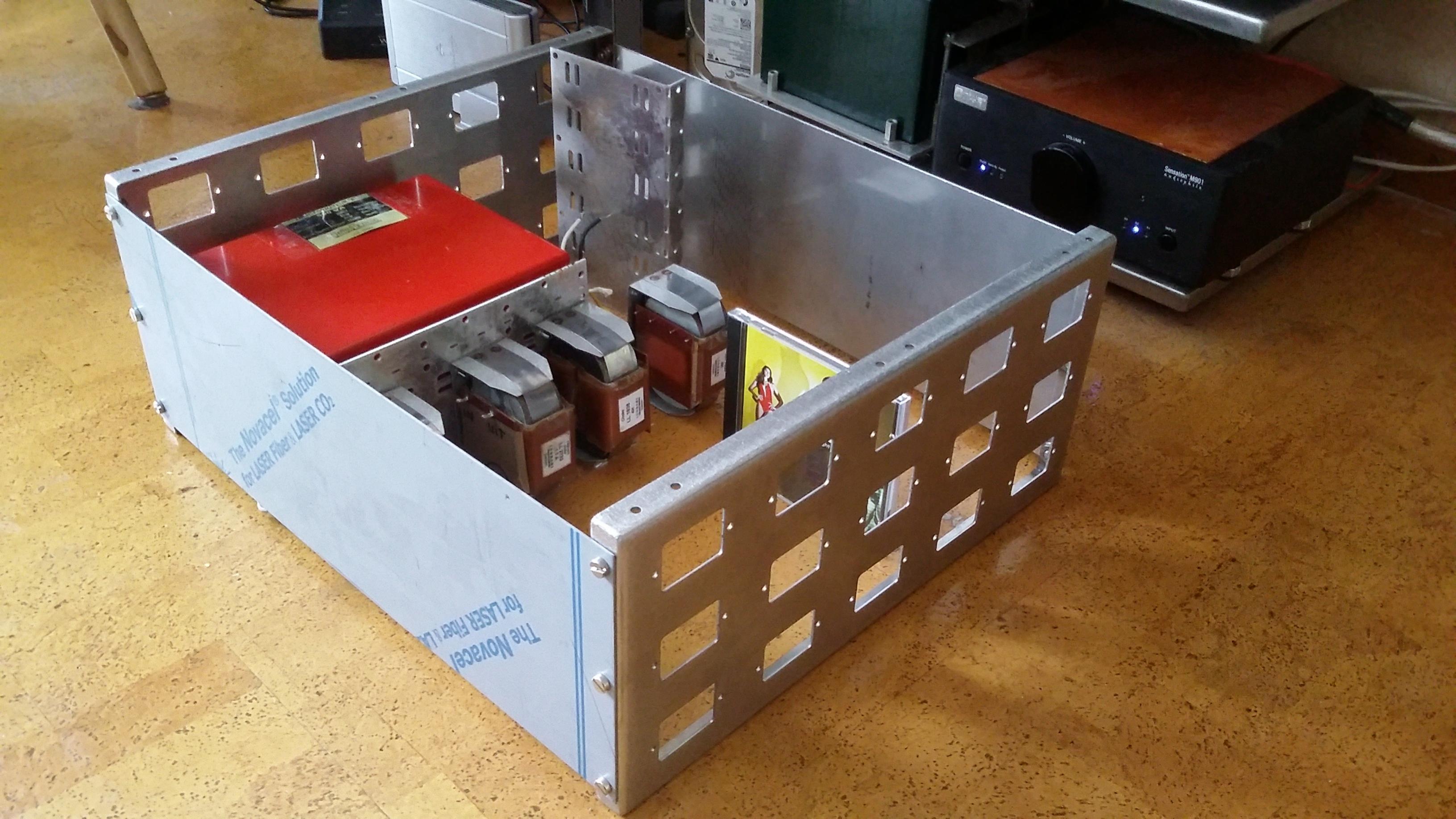

update on my chassis
Hello to all the dddac fans,
i did finish my 2 side panels for my dac mainframe. The rectangular holes will be "" covered "" on the inside with a perforated piece of metal or with a piece of metal having an iec input, bnc connector or whatever.
the two panels will be connected by 3 stainless steel 4 mm bars which will be laser cut and will be mounted with the 12 pairs of 5 mm holes.
these bars will have welded nuts each 60 mm to "" receive "" several panels that will support the different parts. The chokes will be mounted using a panel that will be attached to one of the bottom panels. First i wanted to use 3 but now i will go for 4 chokes.
probably there will be a shielding between the chokes and the right side of the chassis.
maybe the chokes will be monted on the area above the power transformer. The 3 bars close to the cover will be identical to the ones on the bottom so can also be used to attach panels with whatever part.
the mainboard will be in the area where the cd is and will be mounted vertically with short leads to the power supply.
the sowter output transformer will probably be in the upper right side part.
the two panels connecting the 2 side panels are just made to show the actual seize of the frame.
the back and the frontpanel can be dismounted with 3 bolts on the left and right side. If there will be switching, leds or something else they will be mounted on a supporting panel right behind the big panel.
any suggestions are welcome because i will be waiting for the new boards.
greetings, eduard

choke connection
Hello again,
My german supplier of the Lundahl chokes ( who seems to have a big stock because yjey did arrive within a week) did tell me to follow the instruction in the Lundahl pdf files. If you connect the 2 colis in the wrong way in series you end up with just a piece of wire!!!
By the way he is also selling an LL2733 which has a 1.25 A rating instead of the usual 1,7 a. On his website he also mentions that the lower the ac voltage across the chokes terminal the higher current it can deliver. Here we use low voltage transformer so current rating will be a lot bigger.
The 1,25 A model ( just the same colis but smaller airgap so less current but higher inductance) will give you 36% more inductance so 544mH with windings in series. Both models have the same price ( just below 100 euro )
Now i can do some test to see what transformer i need for the shunt power supply that i am going to use for the wave IO circuit.
Will post again after the new boards arrive. The present boards with all these added boards look to '' messy '' to me.
Greetings, Eduard

Looks pro, Eduard!!!
Edward,
Very nice Job there. Wish I have that sort of skills!
