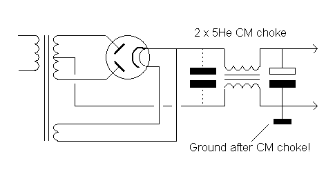

I'm trying to have better understanding on the chokes subject. Choke input is the target.
Lundahl says that best mode for psu is common mode for better rejection.
I guess, that since this mode requires a cap before input to the choke, then it should be mounted as a second in line right?
And here comes another question. Lundahl actually refer to single tranny and full bridge rectifire (as I can see on their drawings). In such a configuration that would make sense to me, as the negative comes back to the bridge and is partly reutilised giving the other half wave, and it's ok to smooth it on the way back (this is just my rookie's logic).
But, what if we connected choke to centre tapped tranny, and used two diodes full wave rectifire? Is the common mode still best solution? I saw some posts saying about dirty negative, especially when grounded.
Could anyone shed some light on it, or correct me if I was wrong please?

I took the liberty to contact mr Lundahl for the answer to the question, and he let me to post his answer on this forum.
Lundahl drawing.jpg - DivShare
"Please see attached a schematic for PSU with chokes connected for common mode rejection (The circles with arrows indicate that the choke halves are connected). The C1 can be omitted, but is often used. Should be a fairly small value cap, compared to the electrolytic cap C2 between chokes.
Please notice that it is important with current balance in the two choke coils. For this reason the grounding point is placed to the right of the second choke.
Yes, I agree that with double diodes/center-tapped transformer, the connection becomes questionable and the benefits are not obvious.
- Per Lundahl"

My guess would be, that thee is some kind of optimum load for the chokes.... Now depending on what load the dddac is for the ps, you could add current with the bleeder. So for a 11 deck like chahn's may be none need. Also may be already beyond optimum. Now this a question Luhdahl should be able to answer ? Just my 2 cents
minimum current
Hello Chanh,
There is a minimum current flow necessary to make it work like a choke input. The bigger the inductance the less current is needed.
If you have 14 volts at the cap after the input choke and you are using ll1694 which will be 160mH. You will need a current of about 87,5mA. ( 14 divided by 0,16). If something would go wrong with the dac the voltage will go up to much ( if you are using 25 voltrs caps) if there is no bleeder.
To be sure you can draw a little more current like 125mA no need to draw 0,5A.
