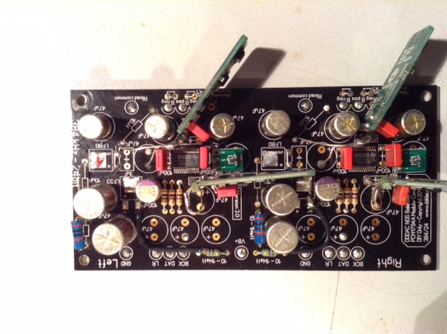

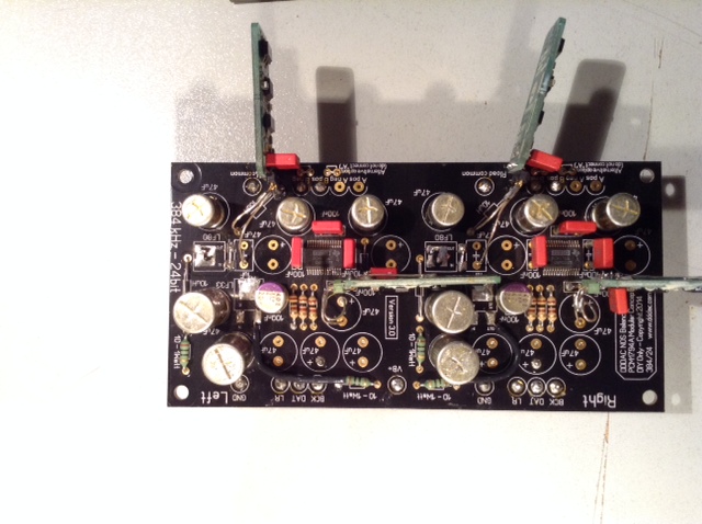

I have just finished destroying and rebuilding my dac stack to do the ccs mod with the boards you send me.
While all was open I did some other mods that I had in mind.
Attached are pictures of the old and new layout.
changes are:
1) CCS board (small green one next to the DAC chip)
2) moved the 8V shunts directly to the Vcc pin of the DAC chip
3) changed 10R resistors in the analog supply feed line for Riken ohm types.
First impressions are: I hear all the new solderings
sound is edgy and bright 🙁
This is a phenomenom that I have heard a lot of times before when serious soldering has been done on the design. It will take a day or two to clear up.
But where will it end up?

I moved the power button of BBB to the front panel and hooked up a battery to the BBB in the hope of preventing any accidents.
Other recent additions:
- OTTO-II IS2 switch
- S03 reclocking/isolation board
- R-Core 18V 120VA transformer
- & the CCS's of course
I've very pleased with the sonic improvements.

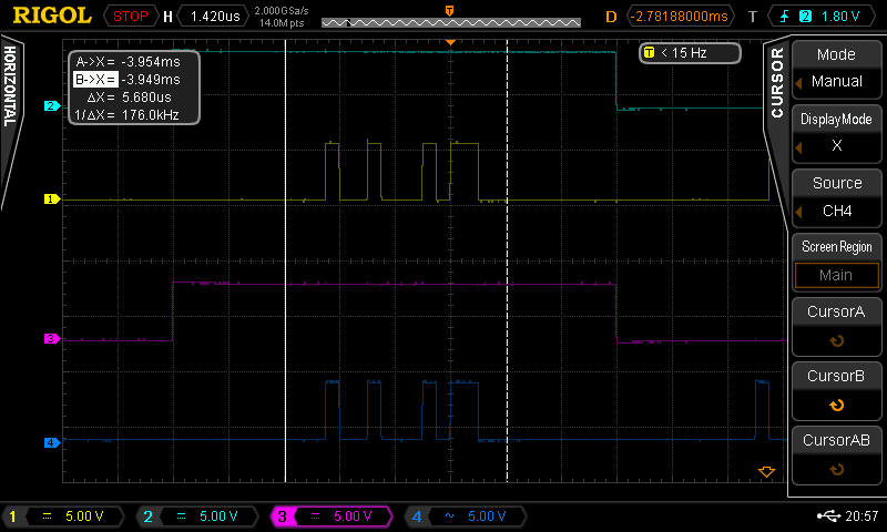

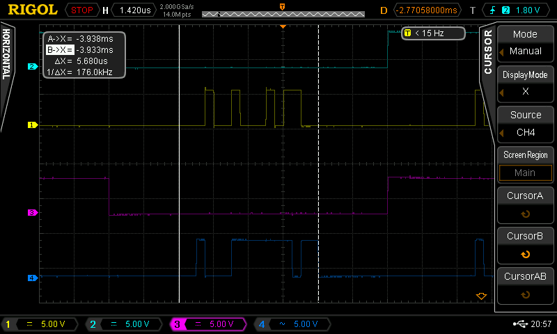

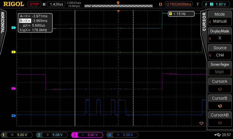

I'm still trying to determine, how / why these "stairstep-patterns" come from in my 4-Deck DDDAC (see post #3729). In order to do so, I first checked the I2S signals coming out from the RPi and at the input of the DAC-boards, just to make sure that there is no error in the digital domain.
In order to do so I had to create bit-perfect test signals (sine, square...) which was not that easy. In case you are interested, you can read my blog post regarding this topic here:
Creating PCM-Wave Test Signals With Python | Himmelbauer IT Blog
So, at least this proves that the RPi plays 16-bit PCM bit-perfect, no bit is lost. When having a look at the I2S signals right at the input of the DAC boards, everything looks very nice. The first two samples are the following:
Sample 2: left: 4652 | 0001 0010 0010 1100 | right: 4652 | 0001 0010 0010 1100 |
Sample 3: left: 9211 | 0010 0011 1111 1011 | right: 9211 | 0010 0011 1111 1011 |
One can see the bit pattern in the following three screenshots:
So, everything works as expected, the I2S signal is perfectly shifted into the DAC decks, I'd say.
So, I think there is no error in the digital domain, the reason for the stairstep pattern seems to lie somewhere else, probably it's some internal stuff going on inside the PCM1794, but I have to investigate this further...
