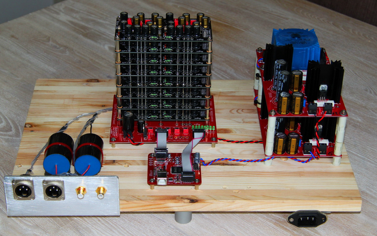

Hey good Timing,
watch this Picture 🙂 Made by my friend Dick. (as I had no time (again) 🙄
He just built it and it did not work at first... Digital noise. meaning the I2S signals were loaded too much. The solution was very simple. Change the 3,3 Volt Regulator on the Mainboard for a 5 Volt Regulator. All Chips (The Isolator on the WaveIO, the VHC164 Registers and the PCN1704 are all 5 Volt compliant. This Little Change made it work seamlesley !
Too early to give a commentary on the Sound quality. But that will follow for sure...
PS. I also uploaded a nice example of a solo DAC in a nice Chassis solution ! 😎

So can we confirm that a single 12v power supply kit can power 8 modules??
Curious to hear Dick's thoughts between 4 and 8 modules.
I suppose Doede's 12v supply will do (just).
I hope 8 boards will not be better than 4, it will drain my wallet building another 4 units with shunt supplies 😀😀 and a Salas supply cannot take the extra current.
Why dont you use simple regulators,you can filter it and its very efficient-youll get your 129 db snr
yes, this can be confirmed now.... Dick will write on his homepage about this in the coming days....
