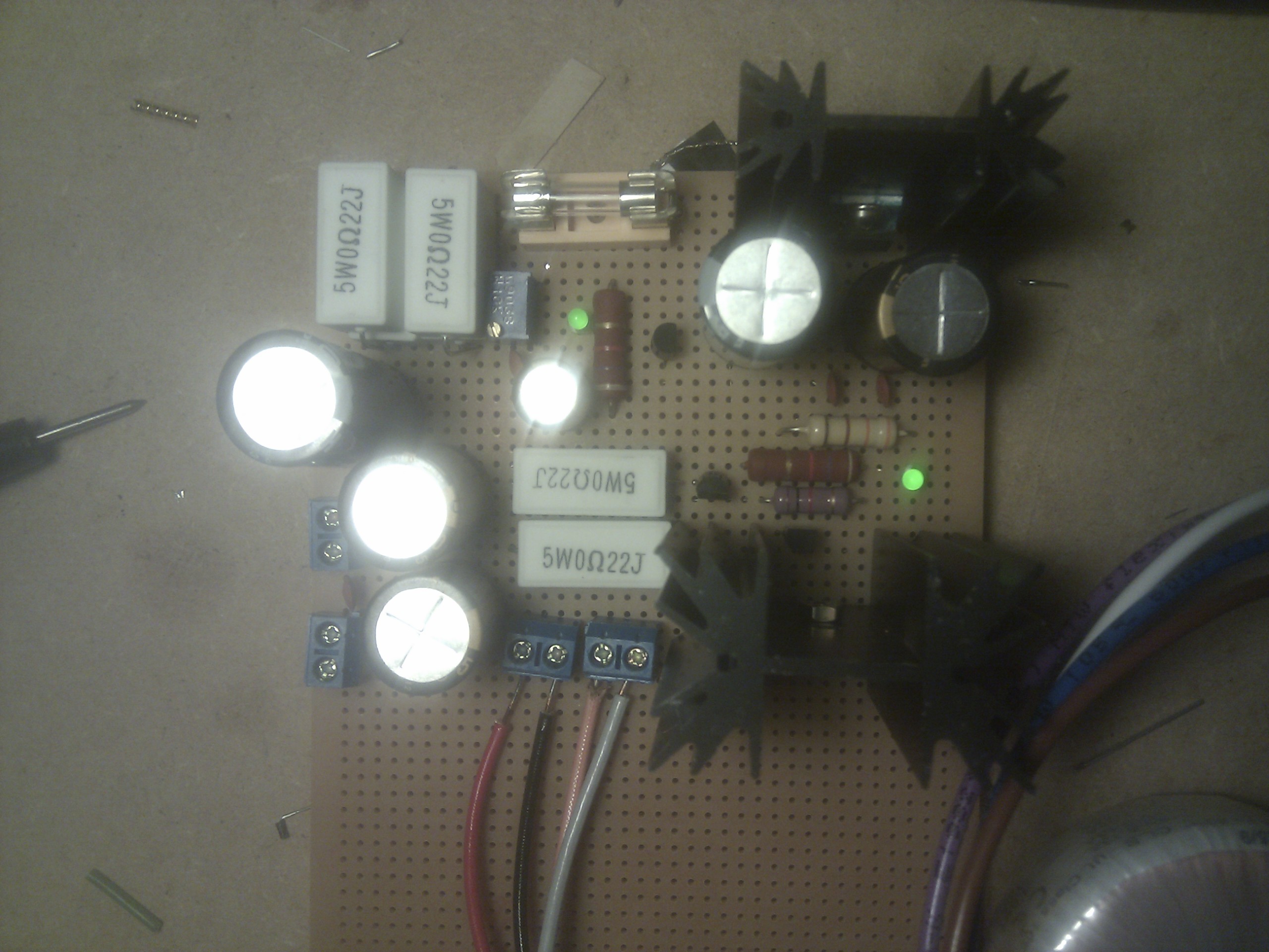

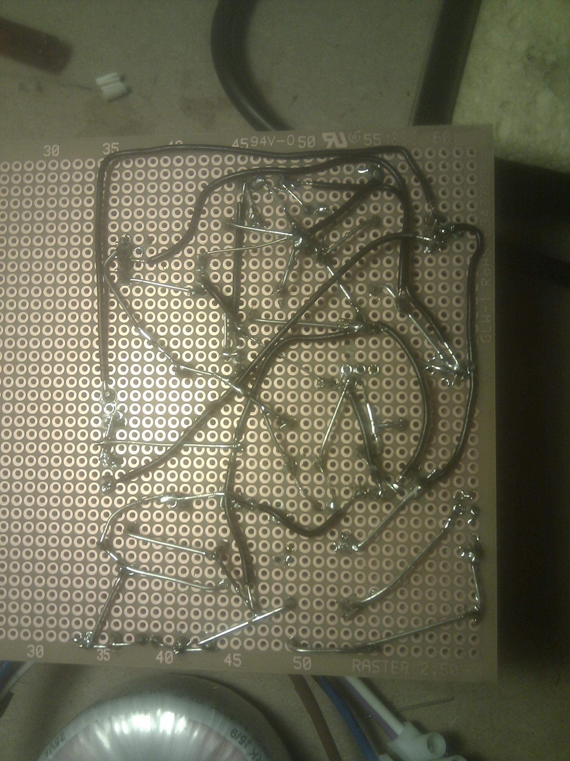

Soldered the 5V PSU
Hey guys,
I just finished the 5V PSU. It is my largest soldering project to date 😀 I am very happy to report that it actually worked the first turned it on 😛
It looks a bit less pretty than those with the PCB dd made, but I wanted to make it as DIY as I could, since I'm doing it to learn electronics and soldering.
What do you guys think, is this an acceptable way of doing it? You can see in the traces that it turned out rather complex, I honestly drew the diagram on paper first to make sure I wouldn't have wires all over the place, but I made some mistakes I discovered while soldering, so I ended up with some weird bridges anyhow.
Is there anything I can do to test it beyond measuring it with the multimeter?
Next item on the list is the 12V PSU, is there anything you guys would recommend me to do differently?
Hey guys,
