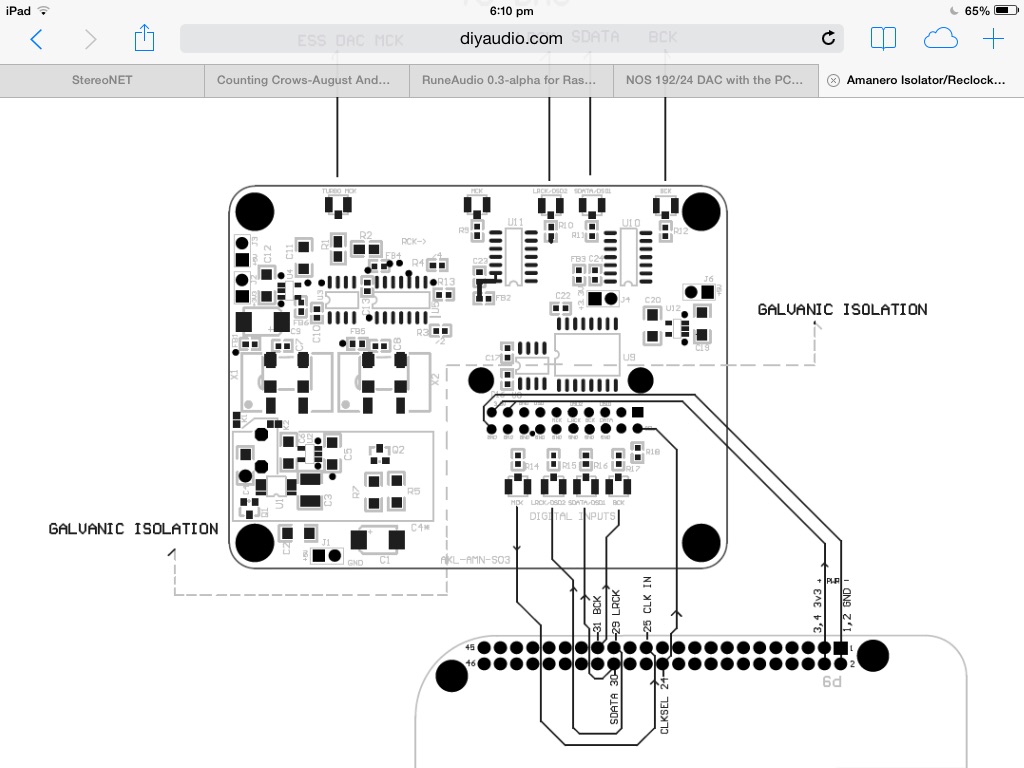

I wonder if my issue relates to using an un-isolated Pi as my i2s source, but I still can't get my head around how waving my hands nearby can be the difference between beautiful music and horrible noises.... I guess for now I'll just back it off to 3.3v until divine inspiration arrives 🙂
