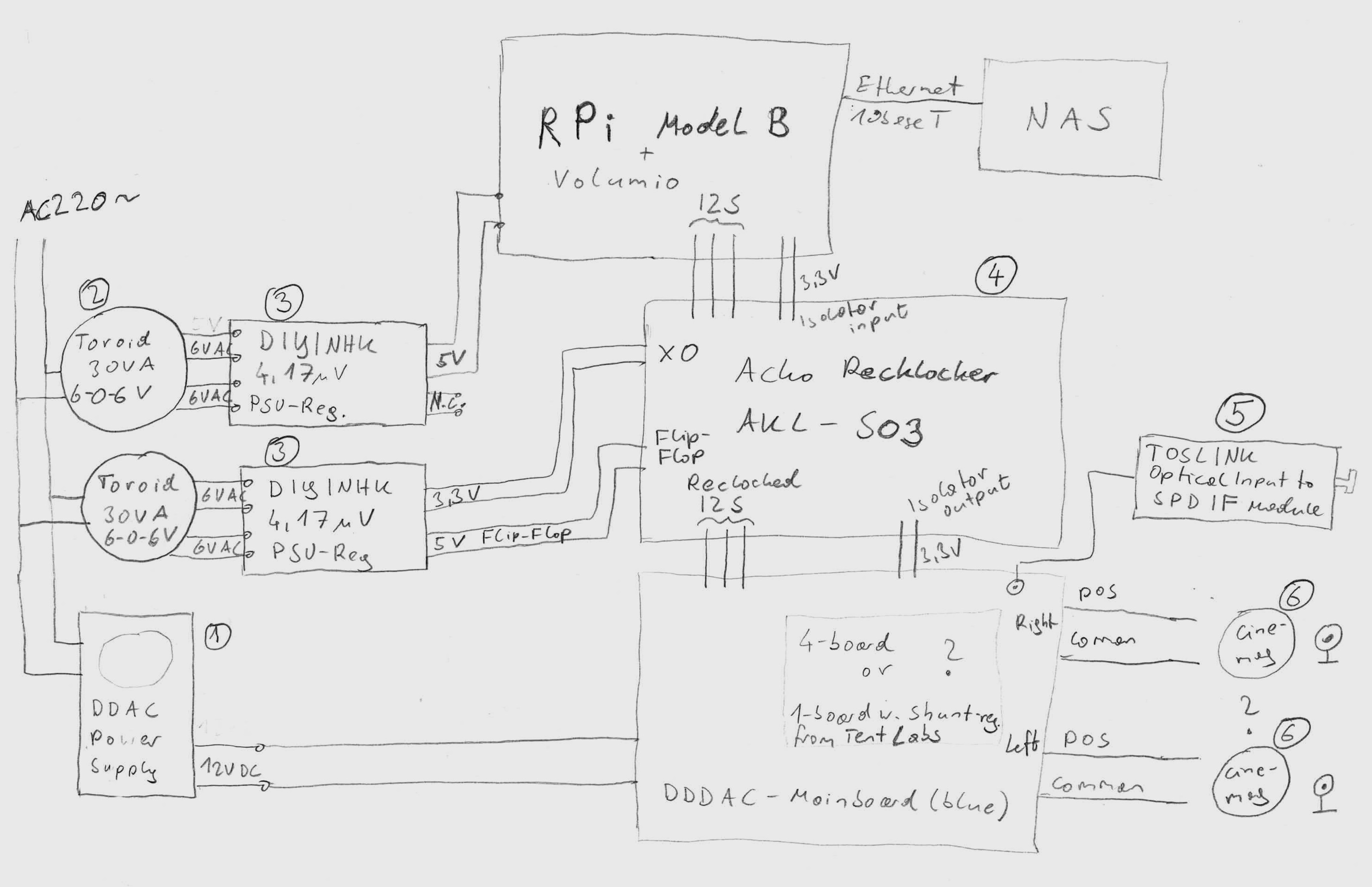

After my first construction, which is running great at a friend I'm considering another build, which should be a bit advanced.
In contrast to my other design I'd like to use Ackos AKL-S03 Isolator/Reclocker, whereas I need another power supply. Moreover, I'd like to use the advanced (blue) DDDAC-Mainboard with SPDIF but need a TOSLINK input for external devices.
As I'm a bit of a newbie in audio electronics, any helpful tips are appreciated (although helpful Enrico already gave me some hints)!
I have depicted my plan in a block diagram below (maybe this is helpful for other newbies, too):
attachment.php
The numbers in the picture are the following devices:
(1) DDDAC Power Supply from the DDDAC Webshop
(2) Toroidial transformers from RS-Components (hopefully they are good enough ?):
Bestellen Sie Ringkern-Transformatoren Ringkerntransformator 2-Ausgnge 12 V, 6 V / 30VA Nuvotem Talema 0030P1-2-006 online bei RS fr Lieferung am nchsten Tag.
(3) DIYINHK 4.17uV Ultralow noise DAC power supply regulator 3.3V/5V 1Ax2
4.17uV Ultralow noise DAC power supply regulator 3.3V/5V 1Ax2 - DIYINHK
(4) Ackos Recklocker/Isolator AKL-S03
https://sites.google.com/site/ackodac/home
(5) TOSLINK to SPDIF converter (found on ebay):
Toslink Optical Input to s PDIF Module | eBay
(6) Cinemag output transformers from the DDDAC webshop.
Regarding this design I have the following questions:
  1. Are there any design flaws in the above diagram?
  2. How would the cinemag transformers be connected? The same as the capacitor?
  3. What do you think about this TOSLINK to SPDIF converter - would that work or is there any better solution?
  4. The most important question: My budget is limited, so I have two options:
  5. (a) install 4 parallel DDDAC 1794 modules or
    (b) install only 1 DDDAC 1794 module and install the 4 TentLabs Shunt Regulators. As jitter should due to the Reclocker not be much of a problem, I wonder what would sound better. Any experiences in comparing these two options?
  6. Are there any other not-so-expensive recommended tweaks I should do? I read something in the forum about using specific audio resistors somewhere?
Best Regards,
Hermann

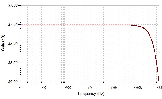

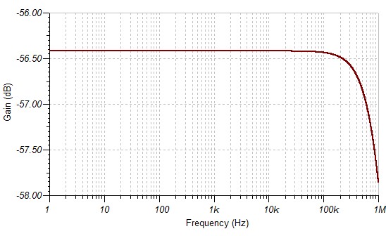

Consider the noise rejection of these two circuits...
The first is an LED fed by a resistor.
Measure the voltage reference at the junction of the LED and resistor.
You get the first graph.
Now use a simple FET feeding the LED.
Now you get graph #2.

Hi Hermann, thanks for enthousiasm 🙂
I won't comment on the raspberry and the DIYHK as I have not used these
1. On dddac side of things this Looks OK, you must have the 1794S Version
Cinemag is connected between POS and NEG. Common is NOT used....
Isolated voltage 3,3 Volt? Is this supposed to come from the 1794S board? Please be Aware, the 1894S Version does 5Volt Output for isolation power
2.See above and other Posts

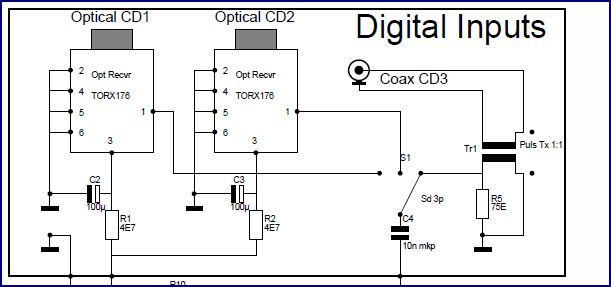

3.Take a normal optical Receiver of the TORX17x Family and connect to the SPDIF Input (see Picture below)
4. What is limited? That is a much stretched Thing 😛
5. Some say this, some say that, depending on what they have. I would say, start with one deck, see if you like it and then Change the 8Volt and listen again. Than you can decide to get to two boards and see what you like. This helps your understanding of what you are doing (it is Hobby, right?) and helps your Budget to spread over time
6. You can try some I/V (Rload) change, but do it after you build the stock version and listened first ….
