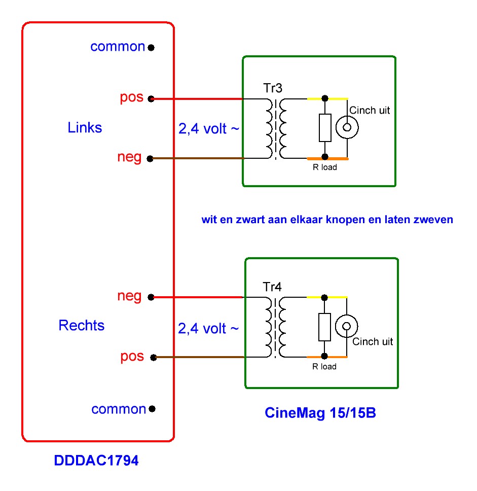

I have just received delivery of a pair of Cinemags for the DAC , I have been trawling the forum like mad trying to find some pictures of how others have installed these, but I can't find anything.
Is anyone able to explain how to wire up the cinemags and post a few pictures?
Many thanks
here it is 😎

Ah thanks Doede
Quick question though. What is the valve of the resister between the orange and yellow wires? And I am left with two other wires, white and black, what do I do with these?
Thanks again for your help!
James
black and white (it says in dutch) cut short and let them float 😀
Value is not critical. 10k - 15k was reported to be good, but you can try if it does something to your ears. No limits in value though. You can leave it out as well
