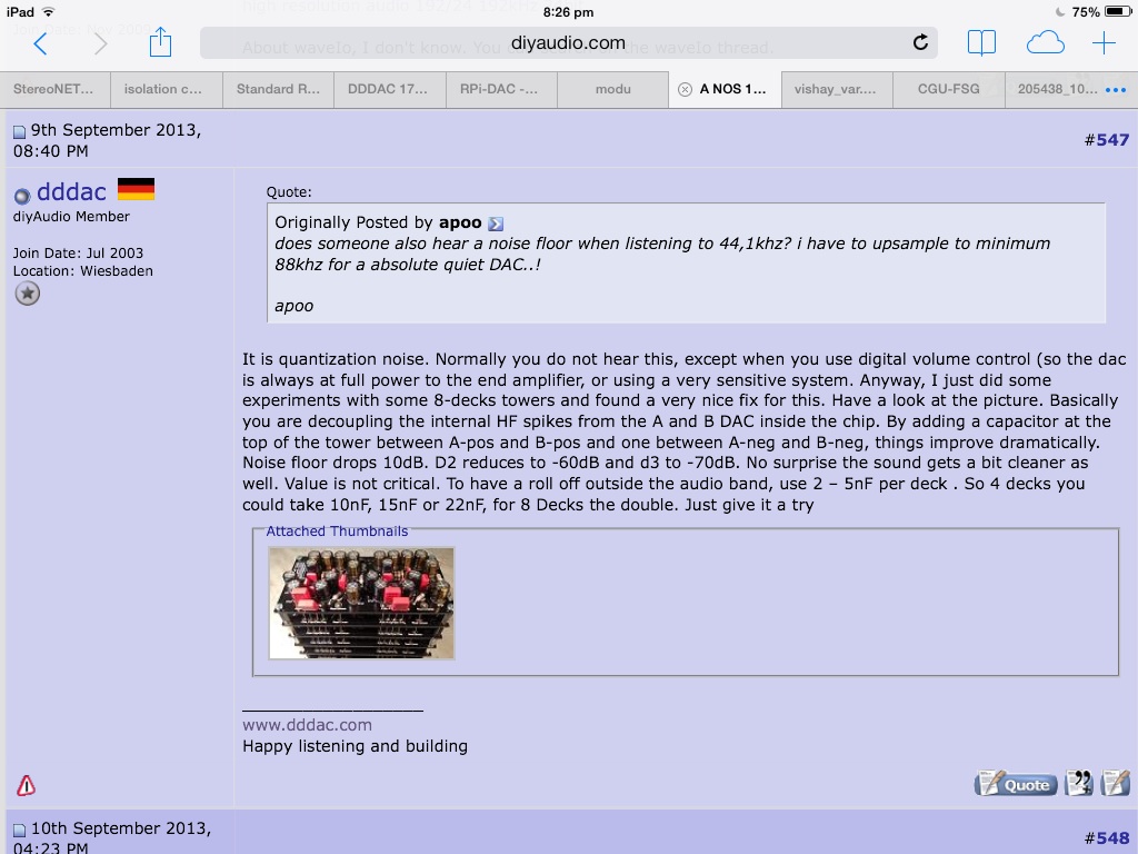

I'm getting a crackling noise-much like a noisy LP-out of one channel of my DDDac. It was not there previously. I'm using a 4 Board set up with Audio Note 2watt resistors on the load function.
A friend had exactly the same experience and describes his experience 'First I had the Dales, then I installed the audio notes: crackle in the right channel. I then swapped the right and left channel resistors, but the crackle was still in the right channel. I went back to the Dales: problem solved, complete mystery'
Anyone else had this? Any ideas?

Hello David,
Dale are professional resistors. Audio note are maybe a bit more tricky to use.
Could it be a bad solder joint. Sometimes resistors are a little bit to big and the wires much be bend a little to much and the cap part of the resistor will not make a proper contact. Maybe change it one more time.
If the resistor heats up during use the cap could make a kind of on off contact.
Sincere greetings, edward

Have you done what in post #547
