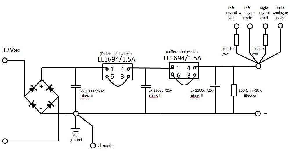

Inspired by James and Stefan, this is what I’m planning to build this coming weekend.
I think a 100Ohm bleeder will be plenty to load the chokes (initially in a standard serial configuration) and with less heat to dissipate, should not need a heat sink. I’m curious to see if my calculated output voltages will work out.
I'm planning to play with the cap values, so nothing set in stone, obviously.

I have finally able to replicate Stefan's Unregulated PS. This is my first iteration, hence only cheapy Nippon 2200uf 35V (Japan made) were used. Once am able to finalise it, will have the bank of Solen film caps in place of electrolytic.
Since this is still a preliminary experimenting stage, appreciate your feedback if you could pick the abnormality?
Basically, I have 2x15V 200VA EI transformer going through the 1st Choke, output of the Choke into an array of 4 x 2200uf, the output is then into 2nd Choke which going to the last array 2x 2200uf. A 200R 12W Mills Wirewound resister is acting as bleeder. Somehow, I do not feel the heat other than a touch warm to touch.
Note I have both secondaries 15V output connecting in parallel. I was told parallel the secondary output will double the VA at same output voltage while in serious will double the voltage at same VA. Please correct me if my understanding is in correct?

I have finally able replicate Stefan's Unregulated PS. This is my first iteration, hence only cheapy Nippon 2200uf 35V (Japan made) were used. Once am able to finalise it, will have the bank of Solen film caps in place of electrolytic.
Great to hear that it's sounding nice, but I don't understand how you have wired your transformer secondaries and diodes 😕
Do you have a diagram?
In my choke power supply I run 'Full Wave rectification with centre tap' which can be achieved with 2 diodes and looks something like this.
So it's ok to join the 2 centre output wires of the transformer together before they reach your circuit, as they become the GND, but you have also joined your 2 outer wires together before they get to the diodes, and I don't think that's right.

.... A 200R 12W Mills Wirewound resister is acting as bleeder. Somehow, I do not feel the heat other than a touch warm to touch.
200R will only dissipate about 1 watt with your caps/voltage, so shouldn't get very warm.

@Chanh, what voltage is your PSU putting out, before connecting to the DAC and when connected? In your case with 2x15V transformer I would suspect the DC out to be quite high..
www.nilno.com/docs/BleedRes.xls
@Ghanh, what voltage is your PSU putting out, before connecting to the DAC and when connected? In your case with 2x15V transformer I would suspect the DC out to be quite high..
Hi stijn001,
It is currently outputting 13.4V with 15V secondary EI. Have asked Doede sometime back if 14V of a car battery would damage the stock regulators, and he replied "no".
My ps is very much similar to yours in post 2307, except no first stage filter capacitor and different chokes are used (mine are Valab).

Hello,
I am not sure if the bleeder will drain enough current to make it function like a true choke input. Usually the choke input will give lots of energy in the lower region.
of course having the cables much shorter might help too.
And you could try a common mode choke as input choke.

Hi Edward,
With 11-decks, I think they yield approx 1.2A plus bleeder resister. However, DAC will required approx 2.8-3A when fully shunt for 11-DAC boards. Is that sort of current adequately utilise my unregulated ps configuration?
You have mentioned the comon mode choke, is this applicable to only Lundahls? My Valab do not have common mode.
