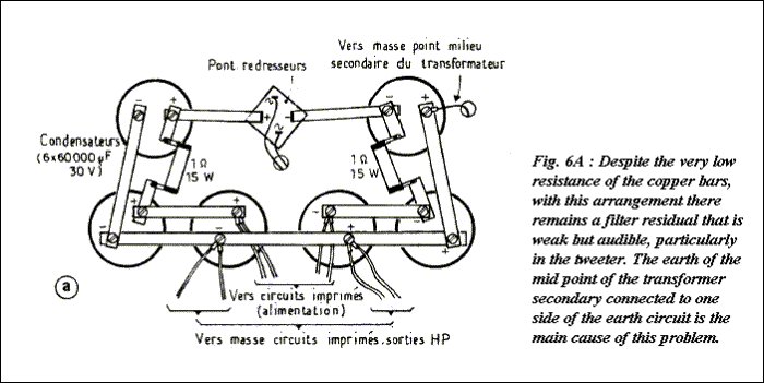

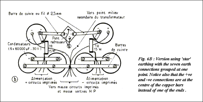

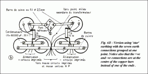

You can see the '' mass terminal '' is right in the middle.
The + and - they also take in the centre between the 2 connections.
Because the currents in the dac are a bit bigger then lets say a pre amp you need to take good care of the wiring. Sometimes just turning one thing 90 degrees and the noiser will be gone. The solution could be real simple.
