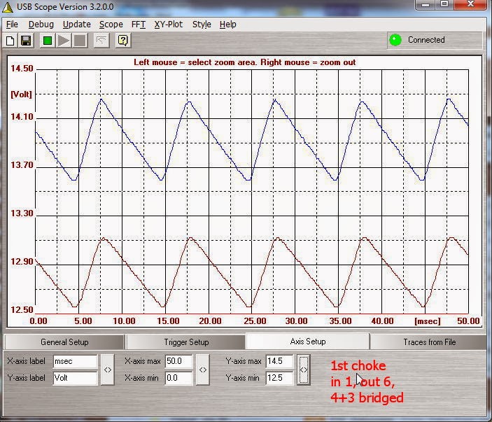

today's adventures in making a choke power supply, I've gone back to the start and using my scope to find the configuration and values that measure well. For reference, I'm using a very cheap and basic USB scope, but it seems it's good enough to show me what I need.
All I have connected up so far is the transformer, shottkeys, caps for the first 'C', the first choke and a 24ohm bleed resistor after the choke to provide approx 0.5A load.
So first up, how large should the first C stage be?
I have some 2,200uf and 1,200uf Panasonic FM caps, so I tried a few different combinations to see what the smallest value I could use that gave good smoothing.
In these graphs, Blue is before the first choke, Brown is after.
It looks to me like there's almost no difference between 5,600uf and 6,600uf. So I'll stick with 5,600uf (2 x 2,200uf and 1 x 1,200uf) for the first C stage of my CLCLC.
Next up, how to wire the chokes. I'm going for series, but there's a few ways to wire them, so I tried the method Stefan mentioned and the method from the data sheet.
Note, I have changed the graph scale here so it's clearer to see the small changes. Again, choke input above in blue, choke output, below in brown.
Looks like we have a clear winner there. In the datasheet configuration, the smoothing works effectively. The other way, there's almost no difference other than the voltage drop.
Onto the next stage....

onto the second 'C' and choke with an additional 47ohm bleeder to simulate the load from the dac.
Some more graphs from the scope to work out the cap size needed to smooth out the remaining AC.
So this is the second choke. As before, the blue plot on top, the input to the choke and brown plot underneath, the output.
I tested 2,200uf too, but that looked the exact same as 1,200uf.
So anything over 1,200uf seems to have no further impact on the smoothness in this stage.
But I note from Stefan's listening tests that 2 x 2,200uf sounds good in the later 2 'C' stages, so that's what I'll go for. So I have 5,600uf, 4,400uf and 4,400uf.
