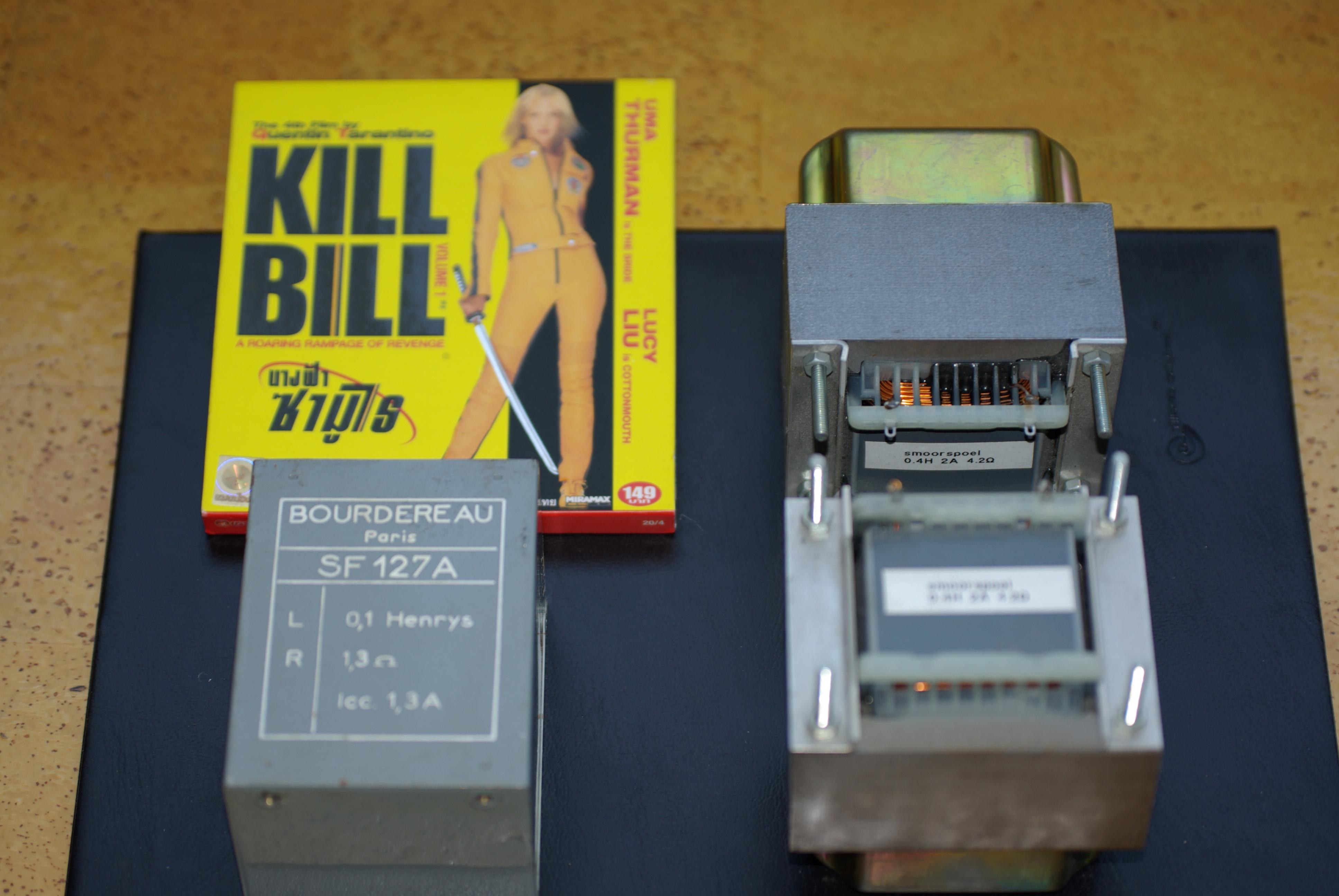

Hello James,
I am not sure that you need to draw 1.5A to make it work properly.
Some chokes will have more mH if there is less current running.
Using it as choke input will give it a harder life. But Lundahl says it suitable for it.
HOWEVER i know you have to draw a minimum current to make it work as a choke input. The less the induction the higher current you have to sink with the bleeder. Sure the technicians here can give you the formula.
Yes better use a heatsink if you connect it to the chassis you need thick aluminium( the thicker the better) and a large surface and you will heat up all the parts mounted on the chassis.
With choke input i would use the bleeder right at the first cap. There is a lot of current flowing here so they say the connection to ground should be as short as possible. In the second choke there will just be the current flowing from the actual circuit. Will also reduce voltage drop.

p.s to many projects running now but i will surely use chokes. Have about 8 in stock. French ones, professional potted. Did use them in my Virtue sensation amp. Did '' sink '' 250ma using 2 *50 ohm 50 watts in series.Someone having the lundahls, if you pay the shipping i can send you one for free

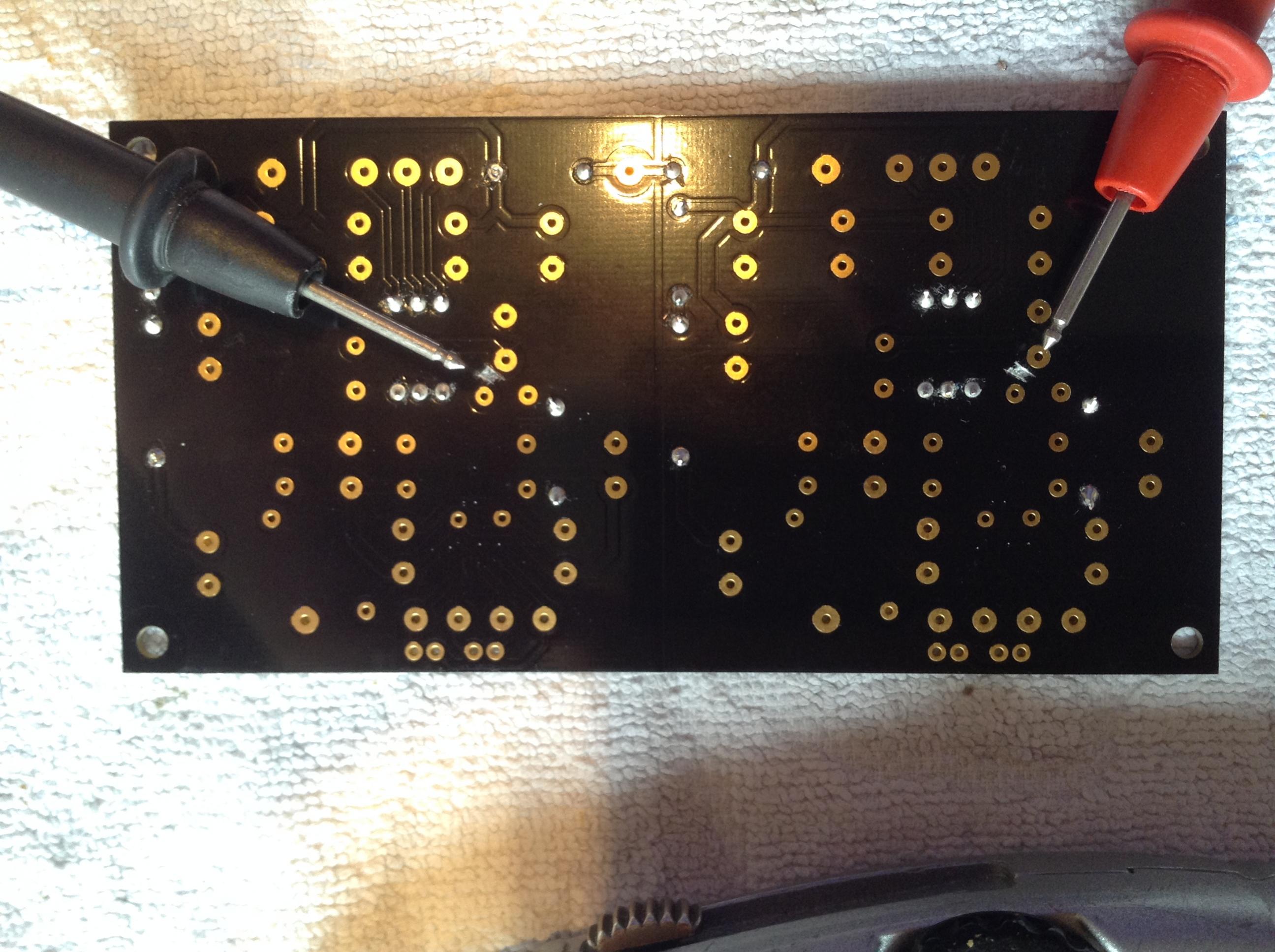

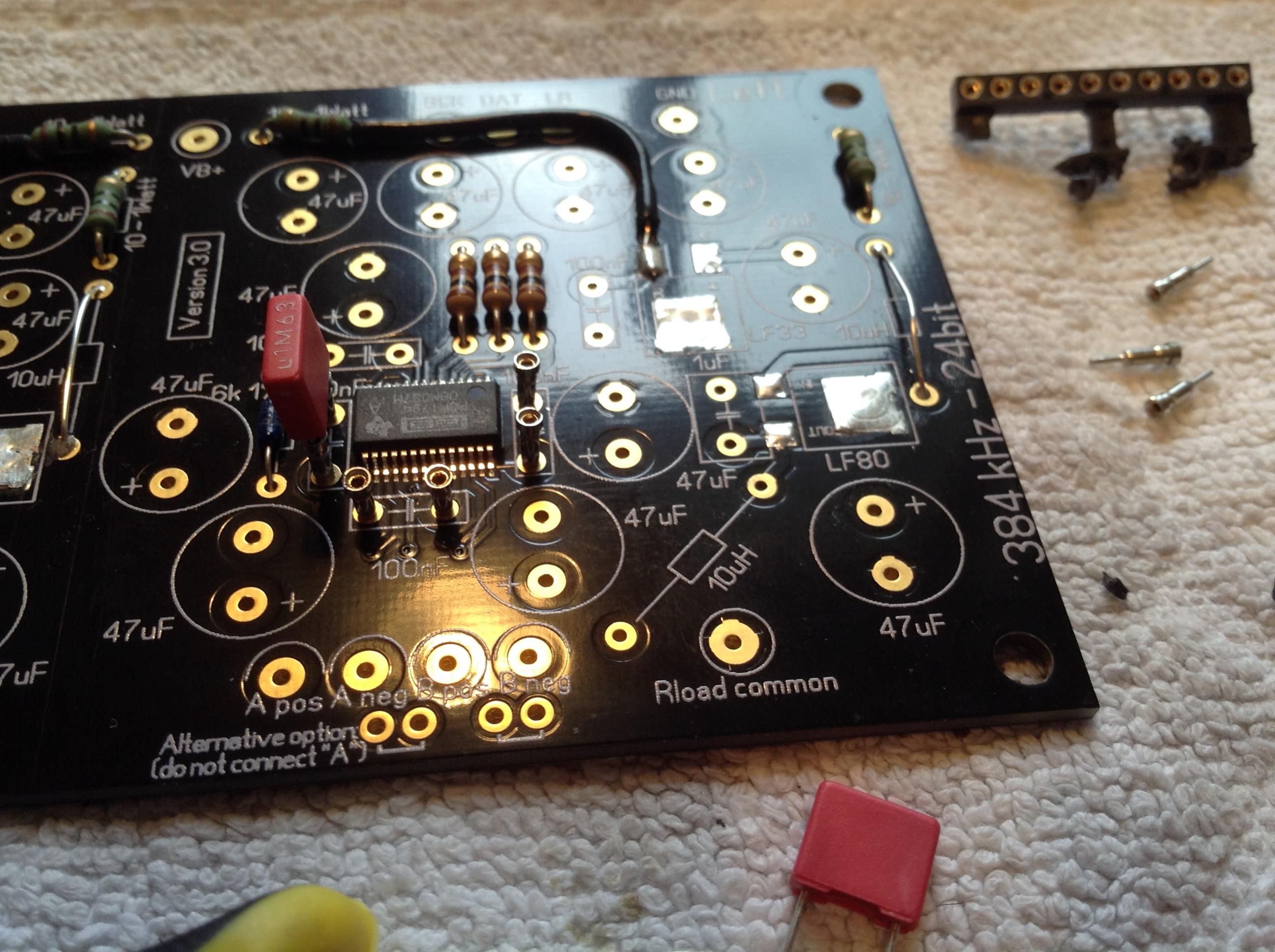

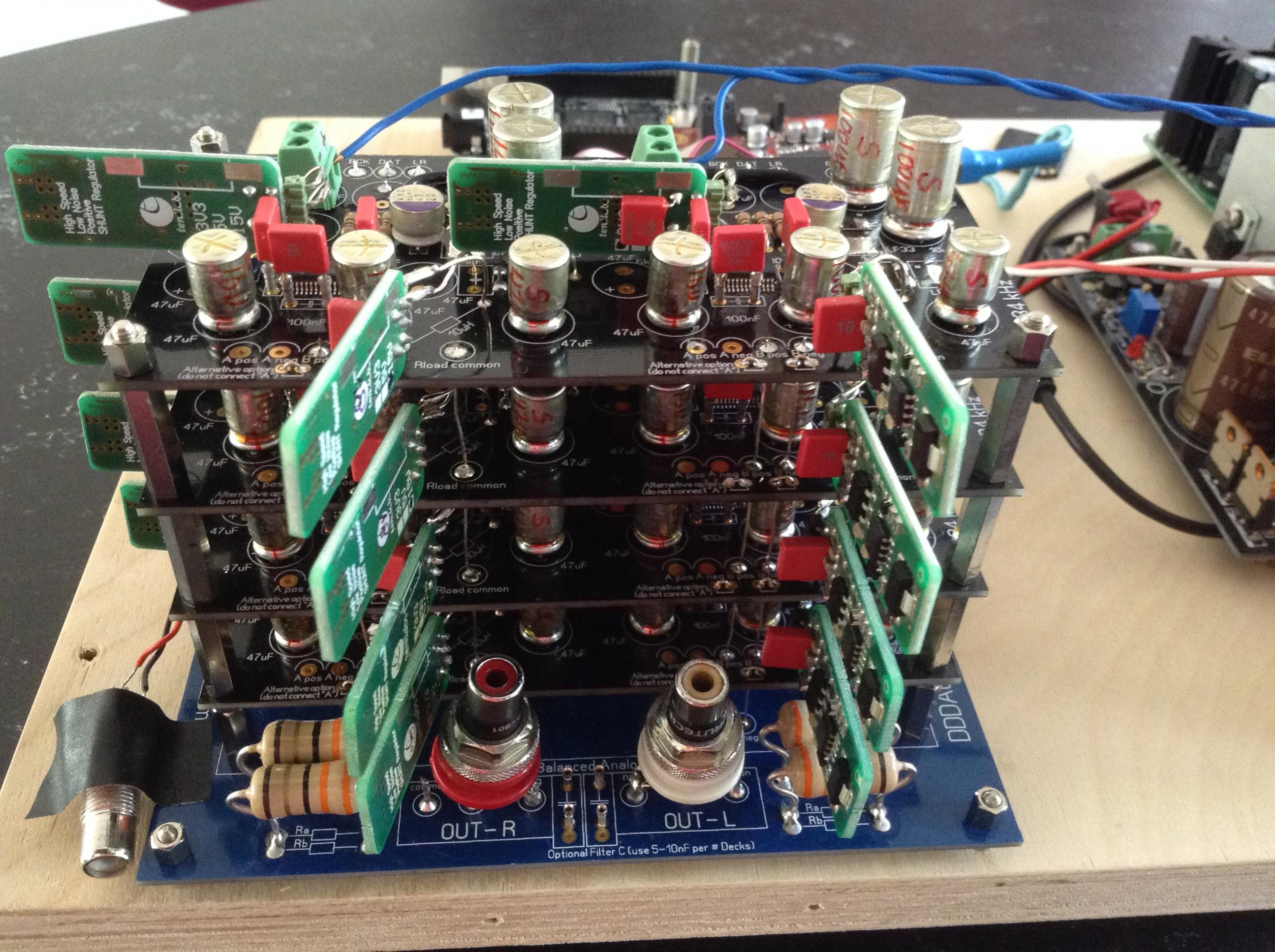

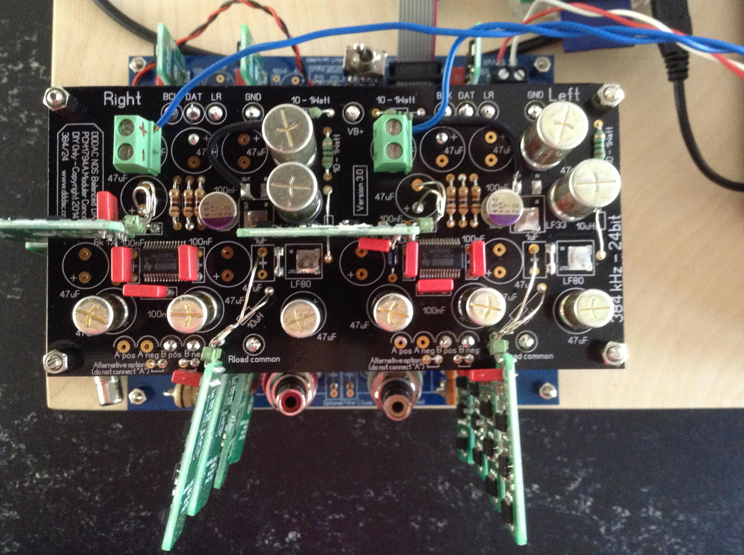

Hi Guys,
As promised here are some pictures of my latest setup.
There is an extra RC step added to the raw power supply to lower the voltage for the 3.3v regulators and added some oscon caps. Also a small bleeder (75Ohm) is added. first C step has an extra added silmic of 2200uf/25V.
On the motherboard I now only use Oscon because it is only used for digital now.
Digital raw supply is around 8V, analog raw supply is around 11,5V.
On the underside you can see the cut traces for the digital supply. I used some pins from an IC DIL connector to be able to experiment with different caps at the DAC chip.
For now 0,068uf/65V Wima sounds better than the 0,1uf.
You might notice that the foil is removed from the caps, this is the cheapest and best mod you can do: The foil is static and influences the electromagnetic field generated around the cap by the AC currents going through.

Very cool Stefan 🙂
I like the idea of splitting up and running the 3.3v supply through an extra RC filter. Can I ask what values you chose for this?

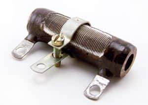

Also, what is this underneath the Oscons?
I think if I get 3 x 48ohm 50w resistors for my bleeder, then I can use all 3 in parallel to simulate the 0.75A full load for testing, then remove 1 of them when I connect it to my dac. If I understand it correctly that is...
Hello James,
That is a wire wound resistor with an adjustable leg so you can change its value.
The free air power rating of the 50 watt is 20 watt so it will be okay for testing but it will turn into a fire cracker if you push it to far.
I am not sure you need to do a test with 3 resistors. I mean if you have to buy them. If you really want to be sure just use a sufficient rated one for testing ( measuring tension will take a few seconds if the meter is already connected, just switch on, it will gradually rise because the choke will slow down the charging, the caps are not big so it will be a few seconds i guess).
The big 150ohm are in parallel so that would be the bleederof 75 ohm Superman is talking about And the adjustable resistor is the one that is used to '' fine tune '' the voltage. Seeing the size of the wire it will not be many ohms in value. Put a choke there too??? Not a 1.5A rated one.

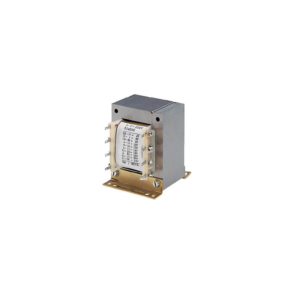

Really curious about your final thoughts.You might consider this kind of transformer. Once the secondary tension is to low or to high you just switch to thje next one.
I will try to find a digital copy of the publication about the advantages of the EI type versus the toriodal one. BUT is in French. ( reminds me of Anywhere they do French food? Yes France i believe. They seem to like it there)

James,
The adjustable resistor is an ohmite and can be bought at Mouser I use a 25ohm version here.

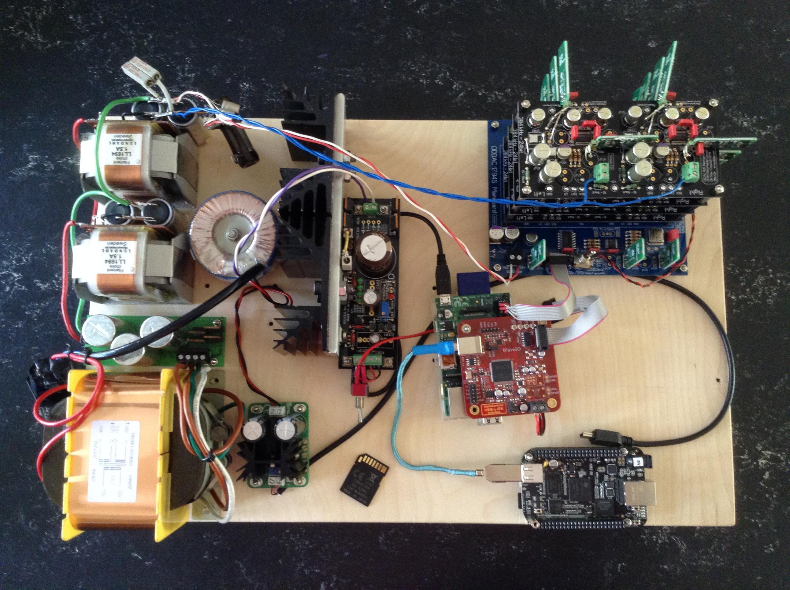

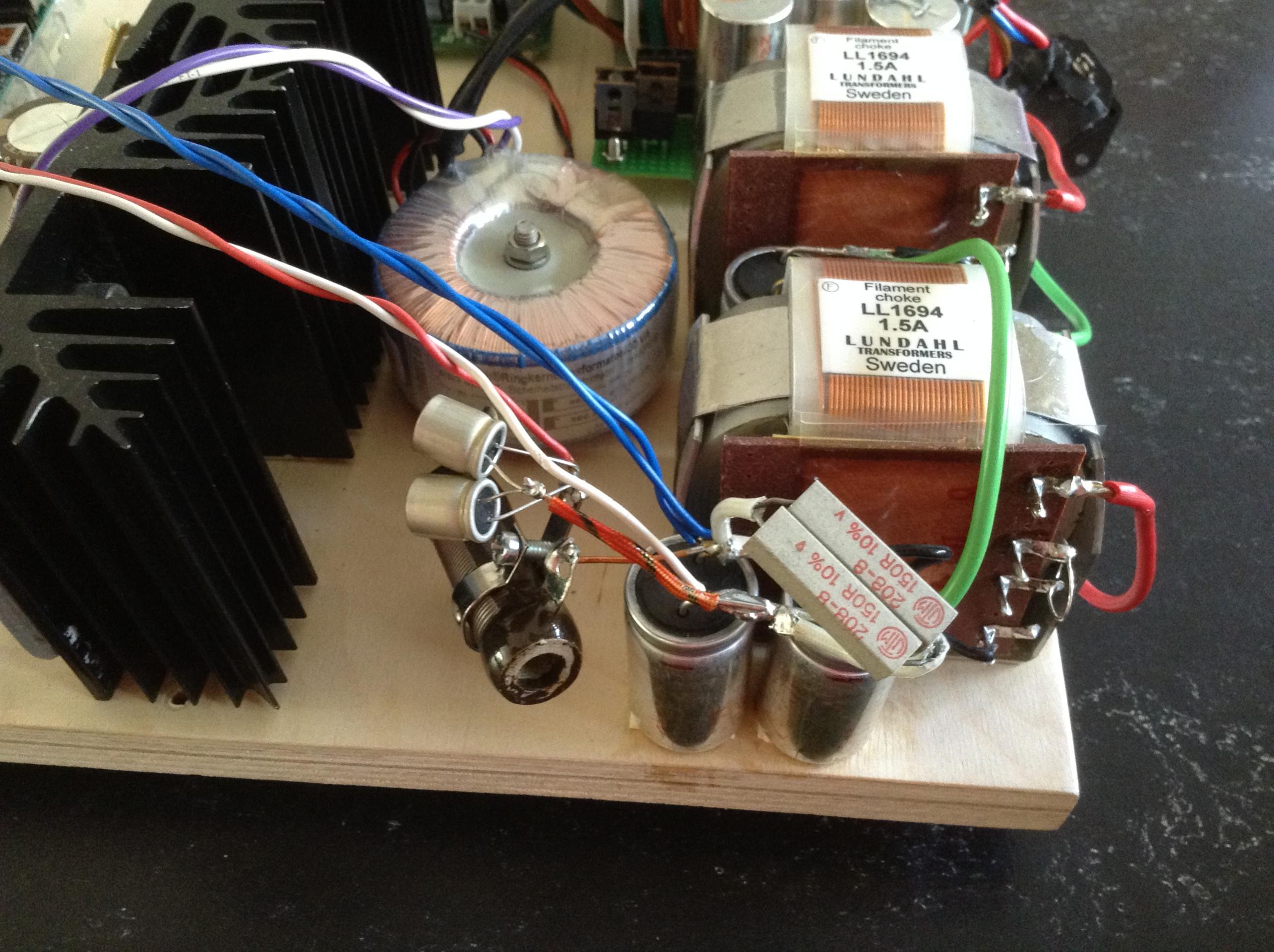

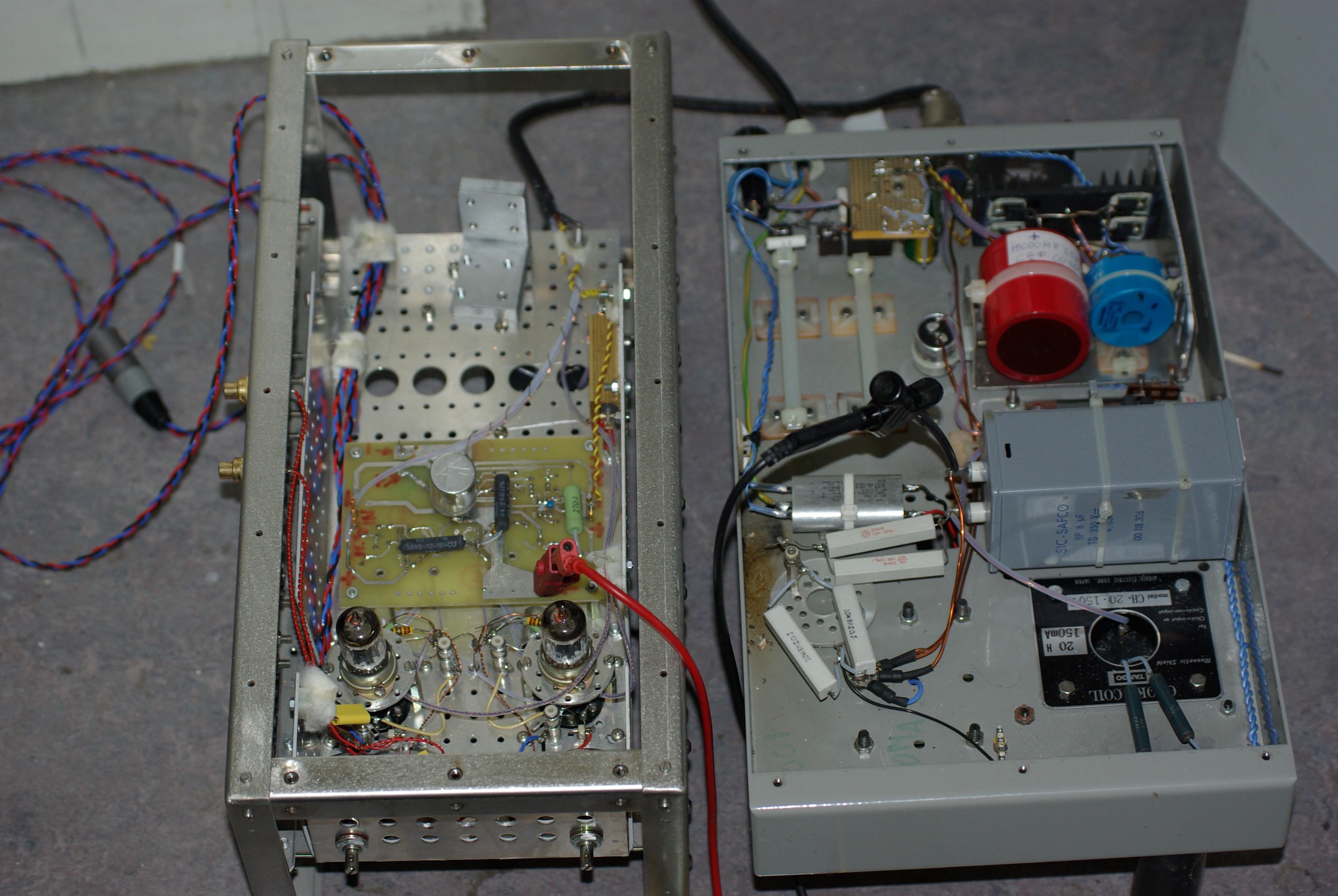

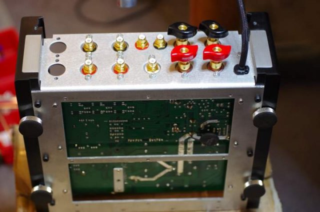

More fun this evening. I have a working solution now 🙂
Removing the first caps in the power supply, so I have choke input LCLC instead gives me a steady 13v with just the bleed resistor and 11.5v with the DAC attached. That will do nicely 🙂 Because the voltage is a little lower, I've separately joined it to the analog 8v regs as well as to the main board as I couldn't remember the headroom needed for the 8v shunts, but thought it was around 3v.
I've also added a few heatsinks I have here in the junk pile to the bleeder and mounted it external to the case. now the bleeder resistor sits at approx 68 deg C, so that's good enough for the moment till I find a better solution. I'm not going to win any prizes for neat and tidy installation, this is just a mockup for now to get it working. I'd like to swap to a 2 case setup eventually, 1 for power supply, 1 for dac ideally.
Anyway, here's some pictures
And the sound? I want to hear more 🙂 but so far, excellent separation and imaging, airy detail, but with a solid, supple character to the bass which I haven't had before with this setup. Kick drums are powerful, but tight. Accuracy is great. I found myself enjoying and analysing the instruments and the playing, rather than the sound of my equipment, which can only be good. That's the goal right?
Thanks again all for the help, especially Stefan [emoji106] 🙂
Hello James,
Good sign that you are listening to music instead of sound.
Switching to choke input usually did give me the idea of bigger lungs for my set up. A bit like cycling after warming up and cycling after a meal with some wine.
Maybe you can just move the transformer(s) outside. I think because the currents involved are quiet high you could gain something by having some wires shorter.
ooh ooh the heatsinks. You dont have one you can attach to the side where the holes are and then mount that heatsink with a pair of stand offs to the box? A bit bigger sink, some thermal grease and a tight connection will lower the temperature. It is not to high i think but when attached to wood it is not very safe. Because of the heat the tie rap could get brittle and break and then you depend on the wooden box to care of the heat.
In the attachment you can see my present line amp. On the left the circuit with the superreg shunt from Allen Wright on the right the choke input chassis which did serve for some other projects too as you can see.
Really glad it works out fine for you and some adjustments can still me made for further improvements. loooks very promising.

Thanks guys. Like I say, please don't think this is the final solution, just all smashed together with only what I can find and salvage on a Saturday night. I'll make it nice before it gets proper use, I promise 😉
Soon it will be a comfortable, well controlled heat, even with the beautiful hot weather we always have here in England.
