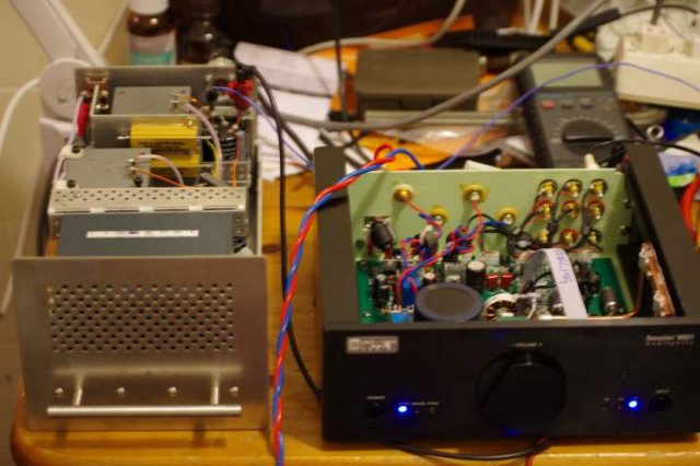

I installed three 3.3v SJM Bellesons on my DDDAC digital circuits without a "pull down resistor" and experienced a huge improvement in sq. I installed a 56uf polymer cap and 0.1 bypass film cap just before each of them to provide fast release energy. I changed no caps after the small Bellesons which fit nicely on the LF33 pads.
They are powered by a 6.3v 2amp transformer which filters up to 7.5 volts at about a 0.1v ripple into this load which is also supplying a 5 volt SPJ Belleson at the input to my WaveIO. I lifted the 22 ohm resistors and inductors and did not have to cut any foil. I feed the 7.5v into the original 12VDC location on the main board to feed the 3 digital voltage regulators.
The analog side of the PCM1794s are powered by an 8vdc Salas shunt power supply. My DDDAC is incredibly analog sounding. IHMO, the Bellesons should not be considered a step down from shunt power supplies on the DDDAC digital circuits.
Ross

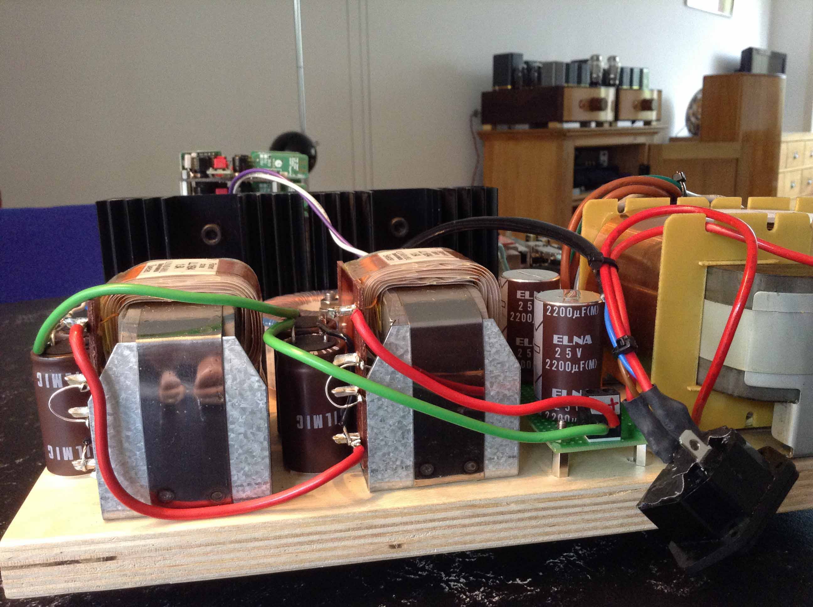

These arrived today courtesy of Charlie @ Big Bear Audio, so it's new power supply time very soon
I'm going to try the same unregulated, low impedance CLCLC method as Stefan as that should be the perfect raw supply for my shunt regs

Yes, I plan to use a bleeder resistor after the second choke. I only have 1 dac deck with shunts and measured my load from the current 12v power supply as 270mA, so I plan to use a 24ohm bleeder to draw another 500mA and put the Lundahls more into their effective operating range.
I plan to just mock up the new choke power supply quickly at first, so I can try a few different ways, so I will try LCLC too. I have a cheap usb oscilloscope, so I was going to try and check the voltages at various points and see how/if the voltages after the shunts are effected by the various options. I'll measure with the current power supply too so I have a base measurement.
I'm pretty crappy at comparative listening tests, so it'll be nice if I can also have some measurements to back stuff up 🙂

Attachment is my choke input power supply ( 100mH, 1A potted chokes)
Sincere greetings, Edward
