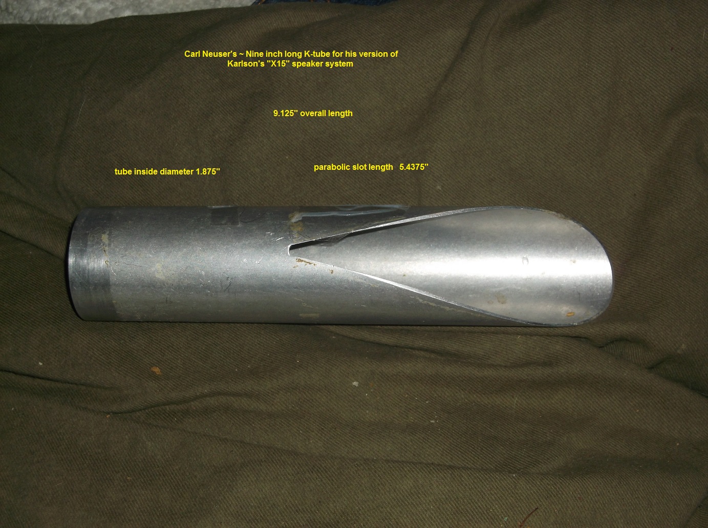

I took another look @ freddi's Post #5, and the Faerber Equilibrium III now looks to me to be ~ 2"I.D. x 9"slot length x 34" overall brass tube length (or so). Now that might just get it down there.

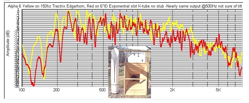

I know the Edgar tractrix is very efficient - is the K tube just as efficient? If same drive levels then that is impressive.
Hi GM,
Yes, size matters.
Greets!
Right, to go low there's no replacement for displacement no matter how you shape it.
GM
With the Transylvania tubes there is no gain. Probably 6-9 db down from an Edgar horn in the mid band but Edgar horns need the midrange padded down to get the treble out of it so probably not that much difference.

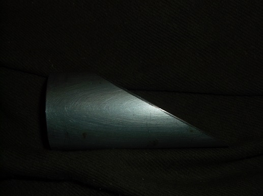

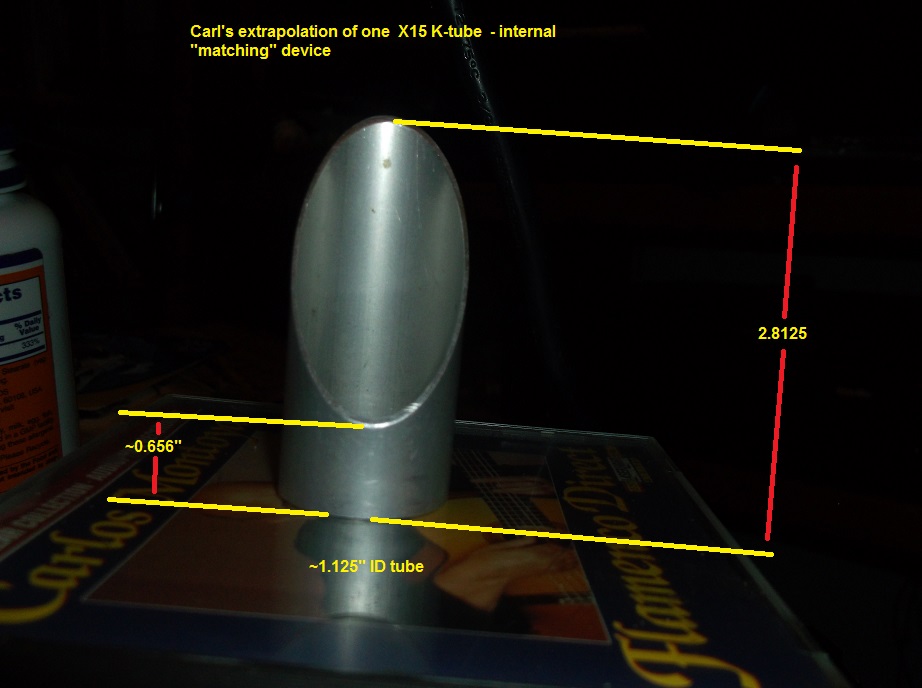

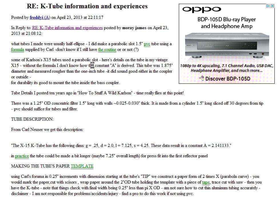

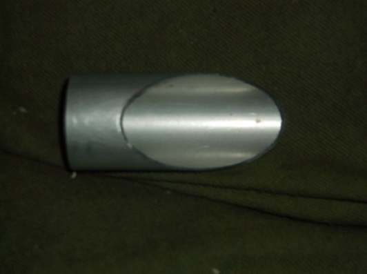

Some more of freddi's original pictures, that should go w/ Post #43 here. From - http://www.diyaudio.com/forums/subw...-simple-build-series-tuned-6th-order-180.html see: Post #1798 and 1802.

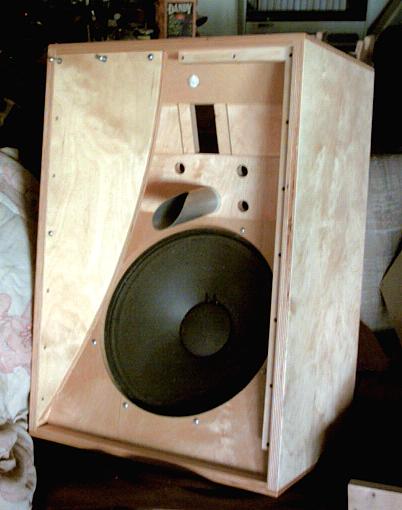

What's interesting here is that the tube is pointed almost straight ahead. I can certainly see that working, as mine the HF went straight thru the tube.
Hi Pano,
I don't quite know what the angle distortion in that pictures is; but, I found some sketches by freddi, when I enter his dimensions into an AutoCAD drawing, it shows the K-tube mounting panel in the Karlson X15A having a slight forward/downward tilt of 16.96°.
I would be great if you could share some of your measurements. Sadly, I'm not in a position to measure anything at this time. Which is quite frustrating, as it makes it nearly impossible to learn anything objective about this subject.

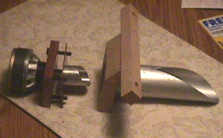

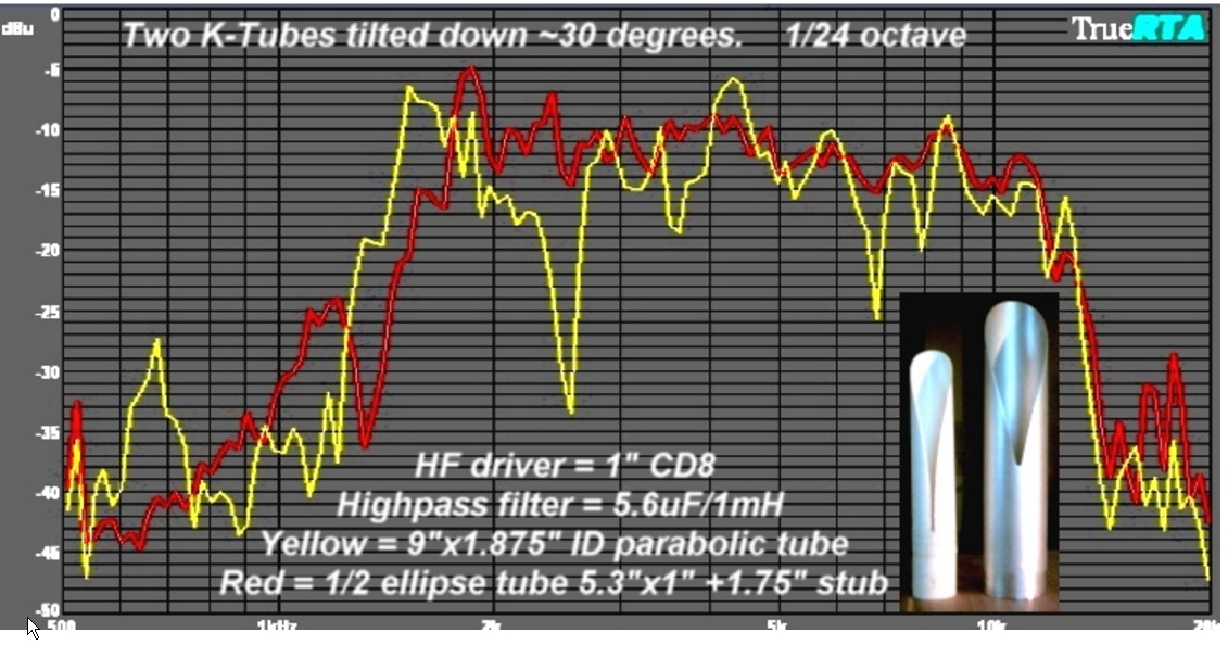

shallow cardboard lens over a 1.75" diameter paper cone tweeter
120 degree dispersion in the top octave
5.3" king X 1" ID tube elevated 30 degrees with APT50
Helped enormously, but not enough to fix 8" tube problems.
Perhaps radial K's over 10" EVM served as "protuberance"?
Note wooden adapter ring, not so obvious.
Large diameter Ktube = waste of time. Do not repeat.
Radial K cardboard thing = worth further investigation.

I don't know where the mean point for a slot like this would be? The claimed intention is to completely release all acoustic energy in a gradual manner w/o reflection back into the K-tube. I'm taking a stab @ it in the attached drawing, so ~8.7° v. 16.9°?
I'll attach my drawing of freddi's X15A sketches, w/ a 1/2 ellipse development of the 1.875"I.D. K-tube.
I guess, this still qualifies as a large K-tube, somewhat similar to the von Langa tube freddi posted in Post #1. If I'm getting what I'm reading, the experts (no pun intended, because I don't know what I'm talking about when it comes to Karlson and K-tubes) seem to have decided, that the 1"I.D. format of the Transylvania K-tube is about the upper limit; which bring up a number of questions: is the von Langa and Faerber stuff mainly decorative (? 🙂 ?), and, what would be considered the lower I.D. limit for a K-tube.
Post #51: "...draw a straight line from the throat/pipe center-line through the slot's mean pint?"
