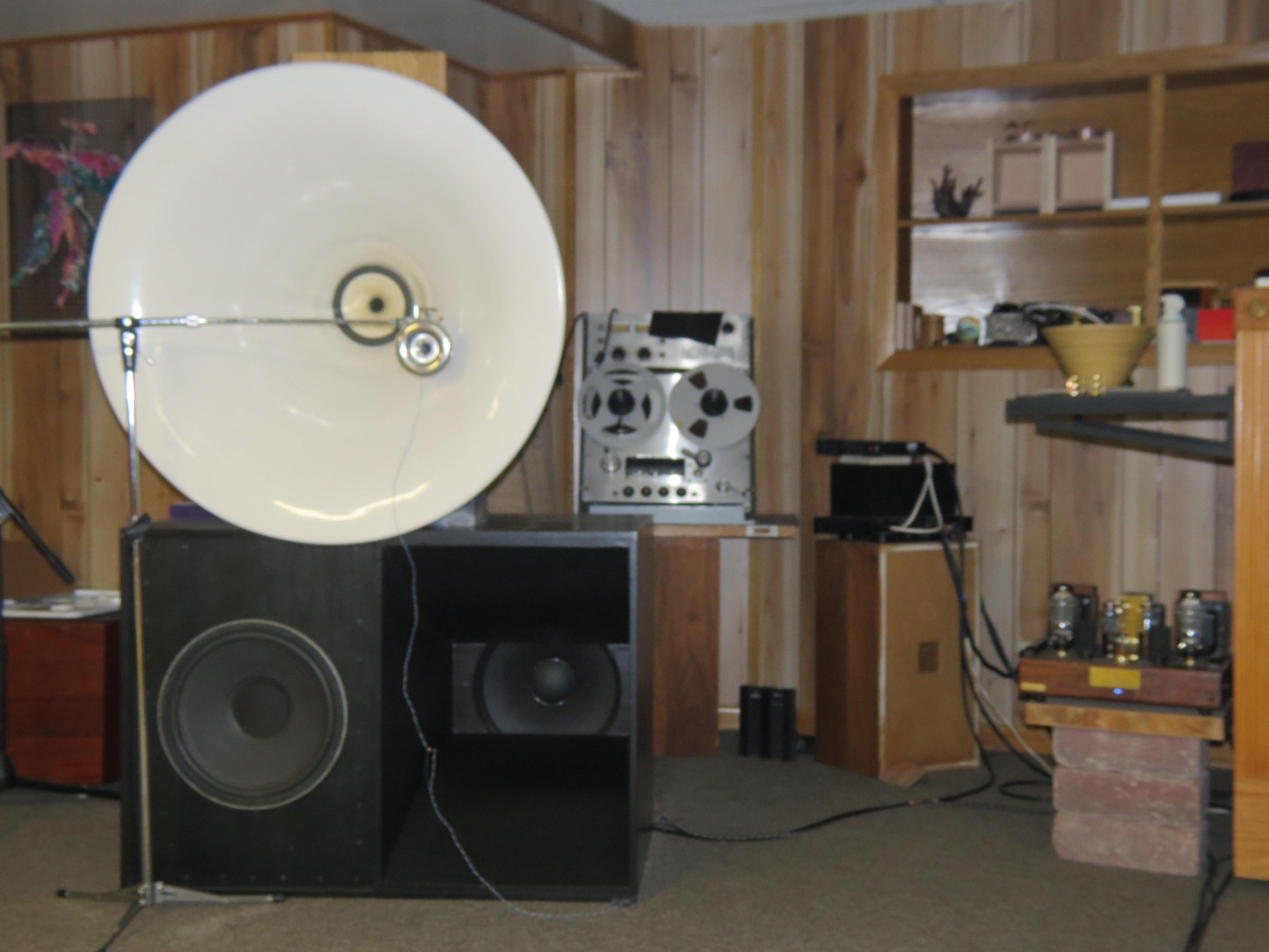

here's a near copy (woofer center accidentally moved upwards 7/8" by the builder) of Karlson's 1965 "X15" system. It first used a wooden mini-klam - i think the 7.25" long K-tube came in around 1966. My tube is 1.875"ID, has an angled sliced 1"ID concentric section. Another sample appeared to use a 1.25" diameter tube with a parabolic slot. This setup works quite well.
this 1" format 1.875" diameter tube press-fitted into the lower reflector panel and was tilted 12 degrees down from horizontal
Carl Neuser's first X15 build used a 1.875" x 9" long tube as it was mounted on an upper reflector panel and angled 30 degrees down.
I measured that tube and it was rough - probably due to the abrupt diameter transiiton. It probably would be smooth with a 2" driver.
A later build used a fully curved reflector panel and was noted to have subjective improvements in sound quality.

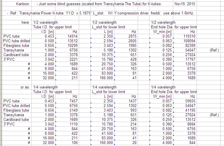

These are end loaded open pipe 1/2 WL resonators same as a box vent, so the longer it must be to go lower. Note that its acoustic path-length is the mean between the end of the tube and the end of the slot, so the longer the slot, the longer the tube must be for a given Fp: http://hyperphysics.phy-astr.gsu.edu/hbase/waves/opecol.html#c2
http://hyperphysics.phy-astr.gsu.edu/hbase/waves/opecol.html#c1
The downside is the stronger harmonic 'ripple' with decreasing frequency if not damped and why these are normally limited to the HF BW.
For mid-range, a 4th or 6th order BP with a short K-tube vent to keep harmonic pipe distortion low seems the way to go, which I assume is what the Sound Laser's odd looking little speaker on top is except for being a high power tweeter K-horn?

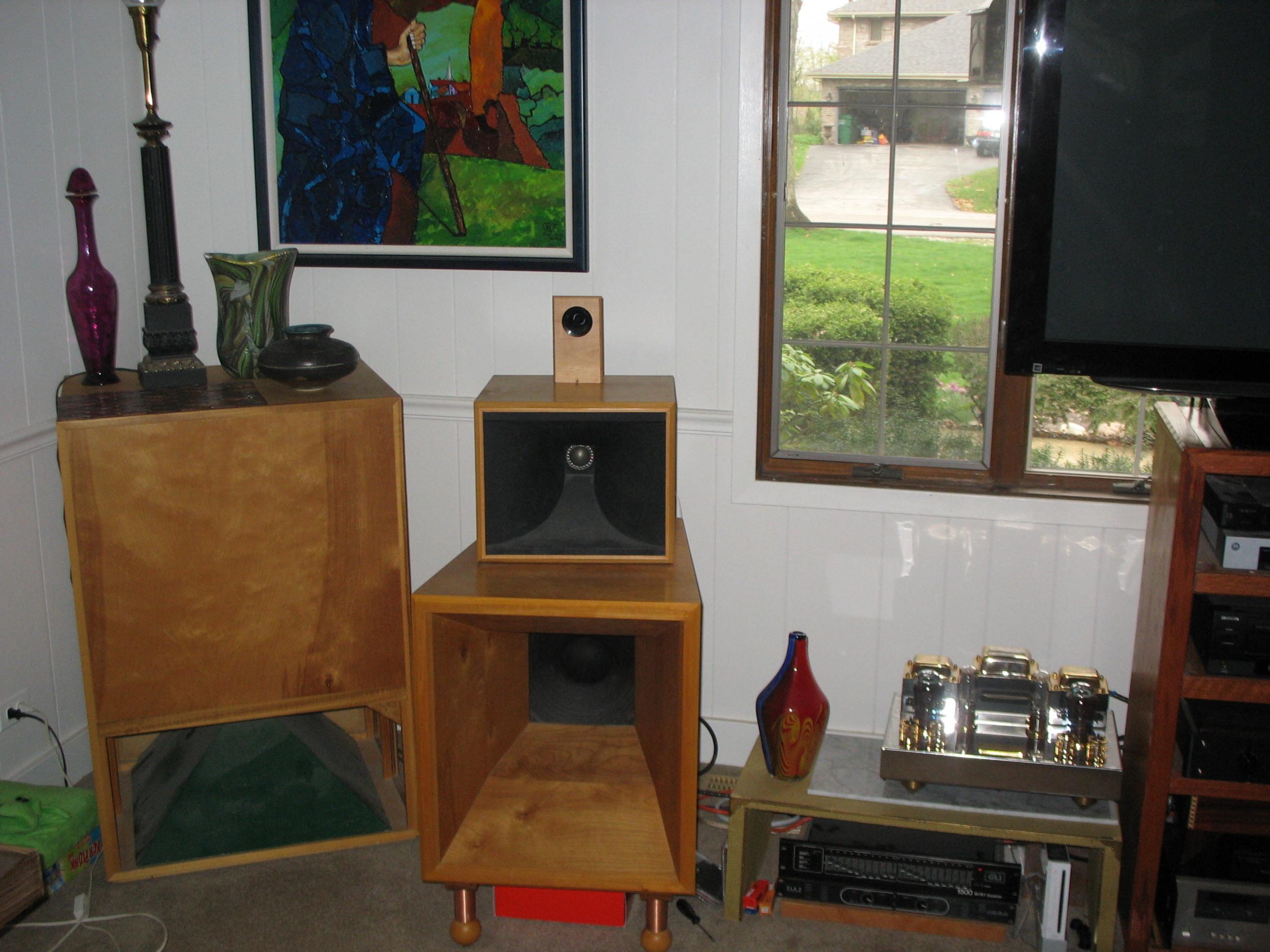

The high frequency device on top of the Sound Lasers in Post #34 is the 1"I.D. Transylvania The Tube in part of a carrying case.
