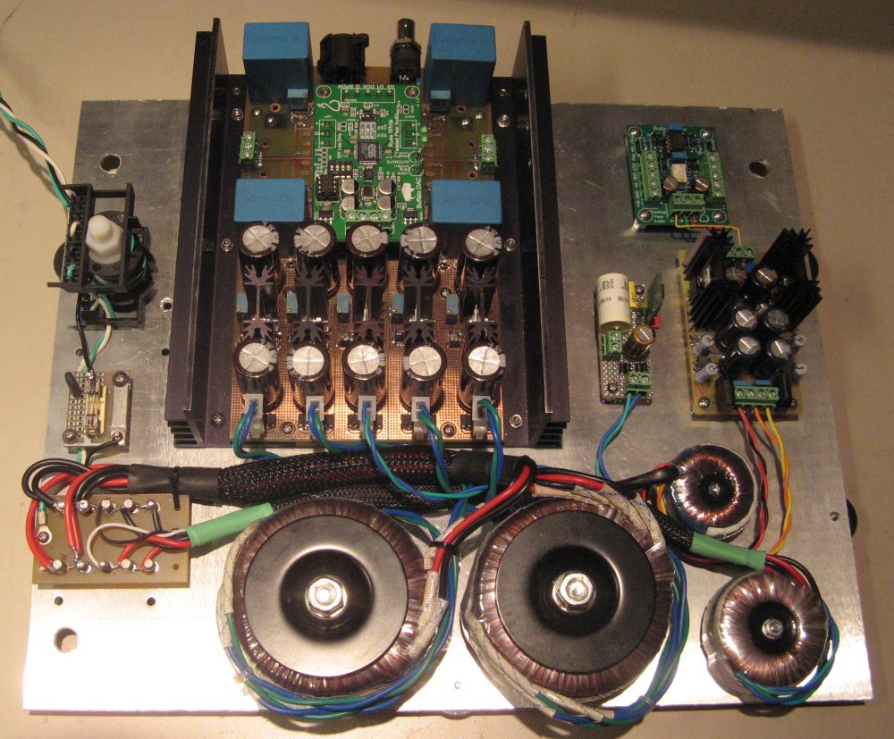

Almost ready to test the FET into the actual circuit after a weekend spent in drilling and mounting into the recycled case. Everything is mounted on a sub plate of 1/8 aluminum for better heat dissipation and easier testing. All supplies tested ok. I'll mount the FET on the bottom plate near the heatsink for the test.

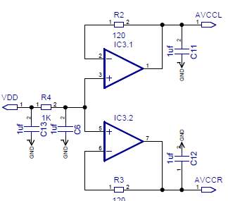

To what value do I adjust the PCB pots? Is it for 3V at the pot as in the transconductance procedure? Then I measure the 200R Resistor Voltage? Thanks.
no, the pots on the PCB are a completely different purpose, simply to adjust gate bias to match AVCC/2 on your particular dac. so power up your buff and measure what the DC voltage from AVCC L/R reg to ground is and divide that by 2 (normally around 1.65-1.7vdc), note that down, power up the board with the dac not connected and adjust all the pots to match that voltage on each mosfet source ->G. power down and install the dac, power the lot up, measure each source to ground and readjust to match the voltage again as it will change a touch under load.
hope that makes sense
the other operating points as set in the matching procedure, are already set by the fixed resistors given +/-45vdc input
Hi Algar,
It is indeed this supply. It should be 3.3VDC so the pot should be adjusted for 1.65VDC on the source of the mosfet (where the DAC output connects). The DAC is happiest when its output is at exactly 1/2 AVCC.
Owen
Owen
oops...., yes source, now that was a brain fart; i started thinking of matching too even after mentioning these were already set. its best to measure the reg rather than assuming 3.3/2 as the tp boys at least with the buf 2 onwards increased this voltage to 3.4 and even a touch higher on some modules. I have gone as far as 3.6v in my experiments; Dustin gives this tip to increase DNR; but i'm not sure if they were doing it back then; sorry i forgot you were using the V1 dac.
Exactly what he said ^ 🙂
The chassis looks great, and again, kudos on putting in all the extra work to etch your own board! I'm looking forward to hearing your impressions.

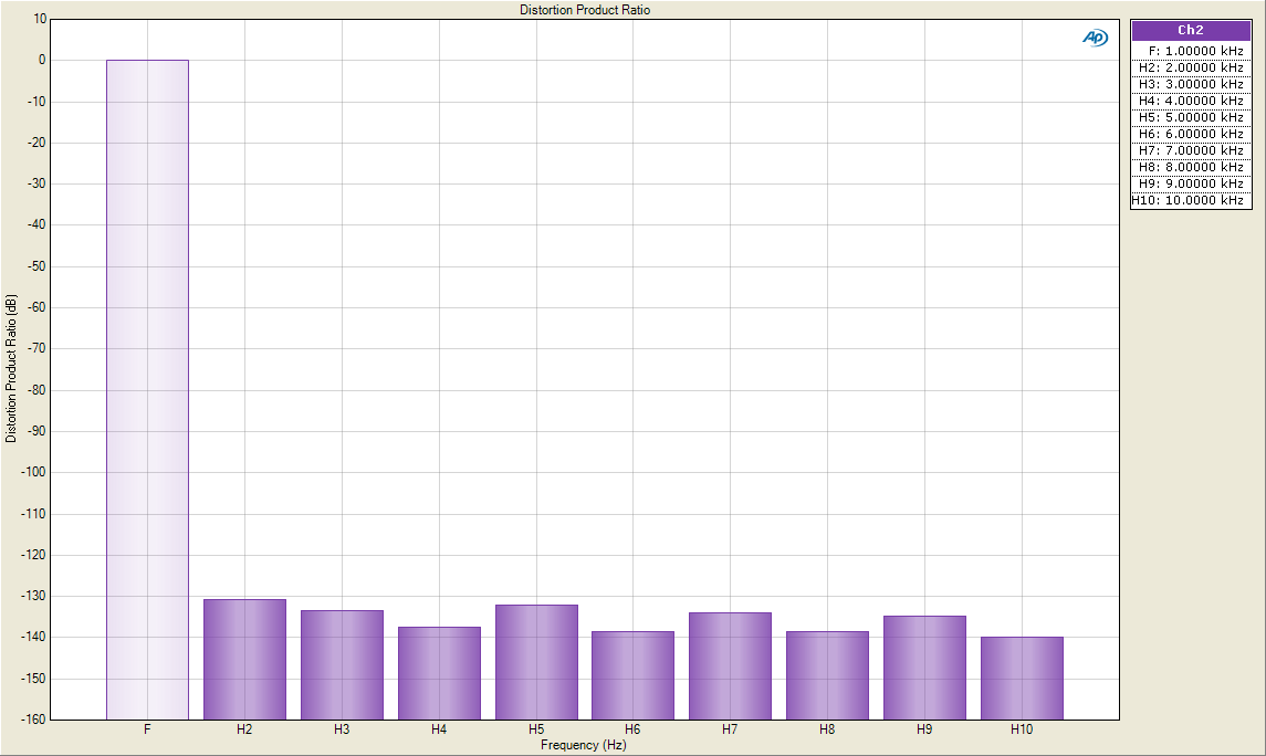

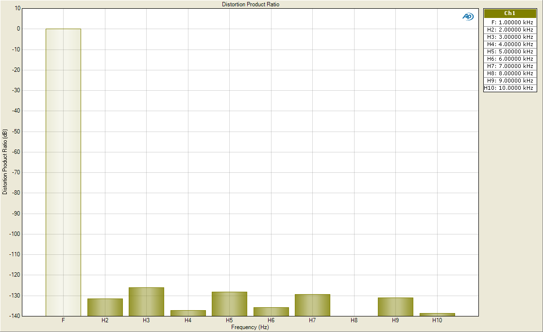

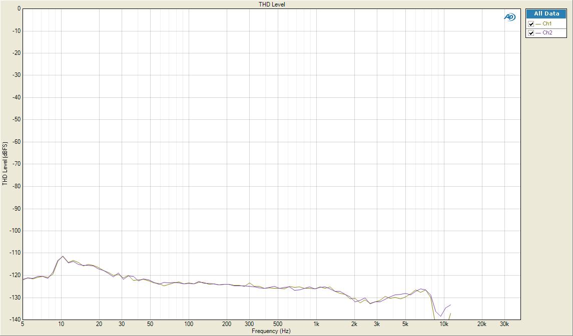

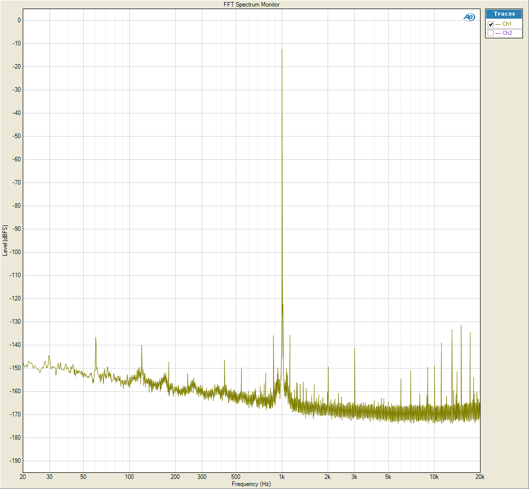

I recently took a few more measurements of my NTD1 using a separate outboard ADC and patching it digitally into the AP. This allows more accurate measurements as the outboard ADC has much lower distortion than the internal one on the AP.
As I always suspected, distortion is significantly lower than originally measured.
Remember this post?
http://www.diyaudio.com/forums/digi...ssic-pass-labs-d1-ess-dac-13.html#post2187211
Compare and contrast to the graphs attached below:
1. DPR @ -4dBFS - 2nd and 3rd harmonics are down 131dB and 127dB respectively
2. DPR @ -6dBFS - 2nd and 3rd harmonics are down 131dB and 133dB respectively
3. FFT of the output @ -6dBFS. Scale the whole thing up by 12dB if you want values in dBV. This puts the noise floor at between -138dB and -158dB!
4. THD vs. Freq @ -6dBFS. Values below 10Hz and above 7kHz are not valid due to high and low pass noise filters at 20Hz and 22kHz.
Hopefully that's some encouragement to get your project finished!
Owen
Remember this post?
Owen
