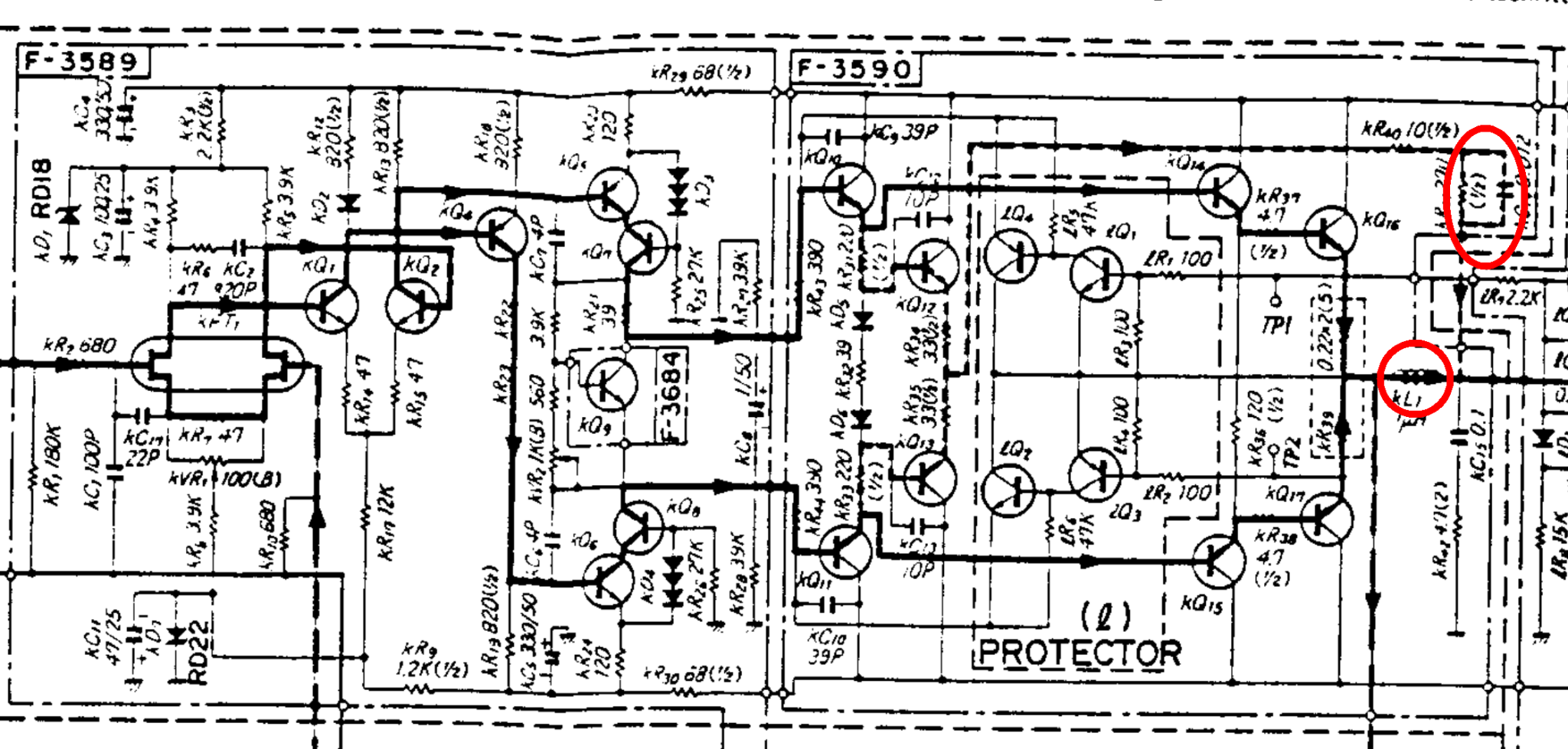

Under these facial and design aspects, I must absolutely agree with you. The typical Quad405 is not a good (illustrative) example of the technology known as CD - and to describe current dumping.
Your approach basically sounds like the Japanese AA concept again.
Then I present a preliminary design of my personal 30W Current Dumper, based on the current inspirations of the DIY forum.

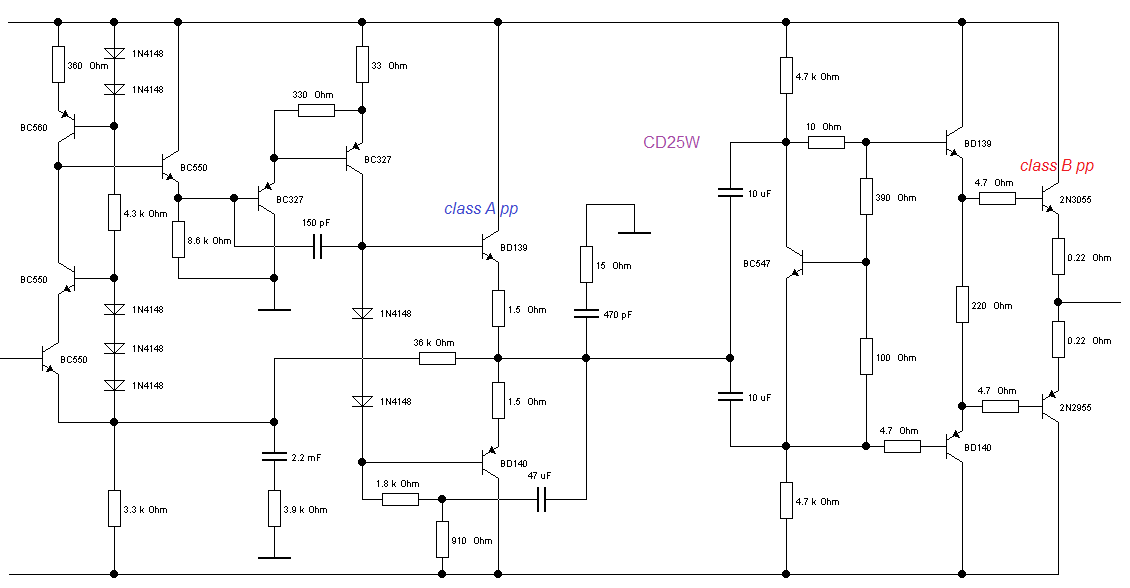

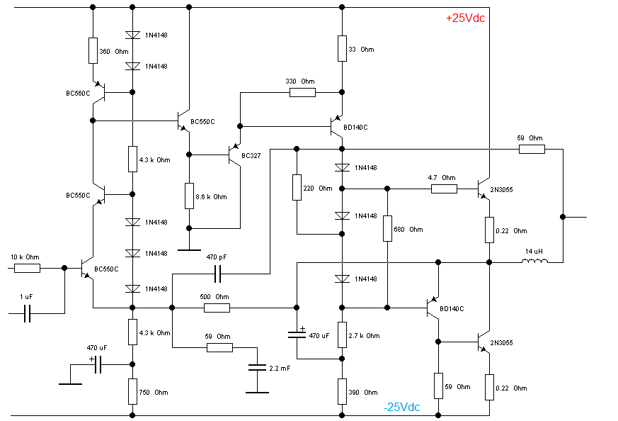

1. A low distortion Class A amp that can provide about 50mA current in Class A. If you make the Class A stage in push-pull instead of single ended, you can just half the bias current. With only 25mA, you don't even need to mount it on the main heat sink. A small to-126/to-220 heatsink is sufficient.
Good approach, I'll try it out right away with the slanted design (the framework conditions). See below. This class A approach can be controlled without clipping up to 40Vpp and is intended to represent the feedforward branch.
2. A high current gain dumper with no voltage gain. I am not satisfied the dumper from Quad amps, which was made of "Quasi Complementary". As these days, PNP power transistors are widely available, I recommend using CFP to create a dumper instead.
It is sensible to use the familiar EF-2 approach. It is still missing in my experiment.
3. Combine them with a bridge.
Exactly, and then you can vary the bias and determine exactly which mechanisms are responsible for the effective advertising slogan "current dumper". To do this, we carry out several real-life measurements in the frequency range from 0Hz to 7kHz. Amounts are of secondary importance, we need the real and imaginary components of the respective responsible currents.

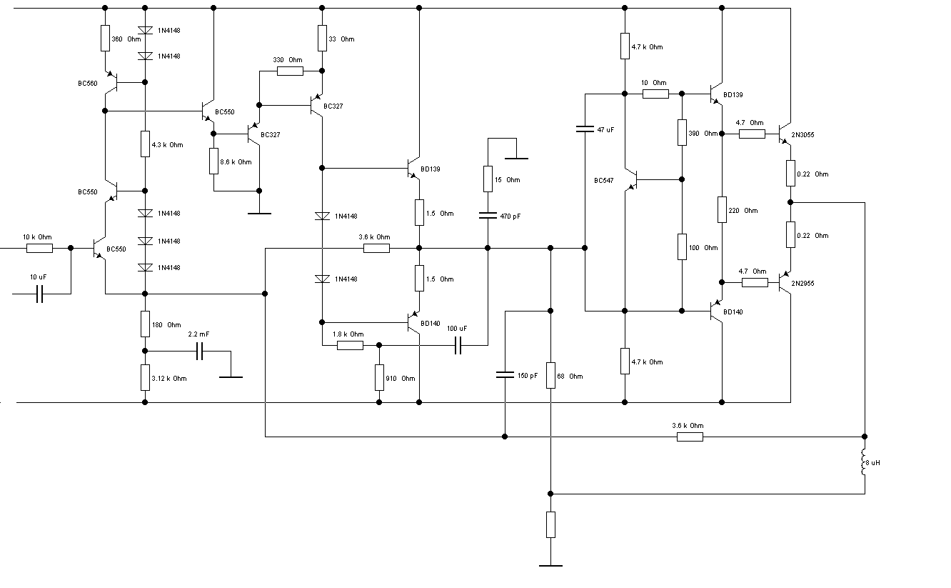

The next step is the final stage, a push-pull impedance converter with (instantaneous and optimum bias) Iq=60mAdc.
It is possible that both amplifiers will be equipped with separate (automatic) DC offset corrections.
Once the function test has been passed, the first thing to do is to log the error to be corrected. Then install the bridge ..!

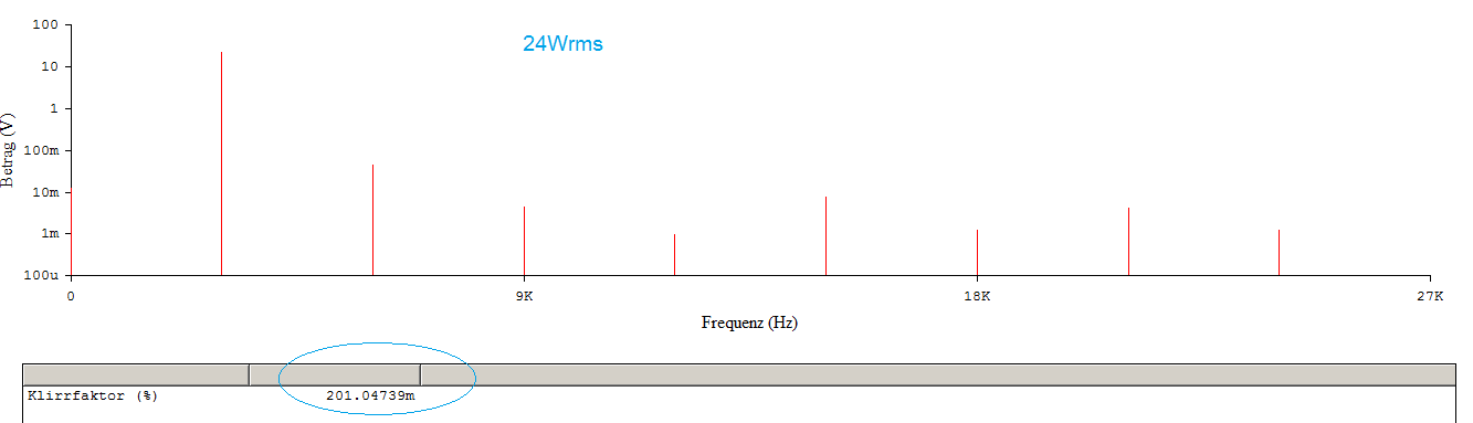

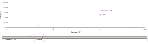

15.5Wrms at 3kHz
Here one can check in advance, even implement as a permanent monitor in the final amplifier (as a display), whether an error-correcting gizmo will bring any dubious gain at all.
If it does not cause any damage, this feature can run with a clear conscience.
The CD25W amplifier does not need this gadget unless the manufacturer wants to advertise it.

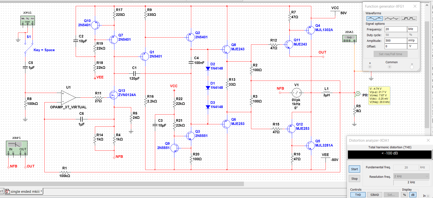

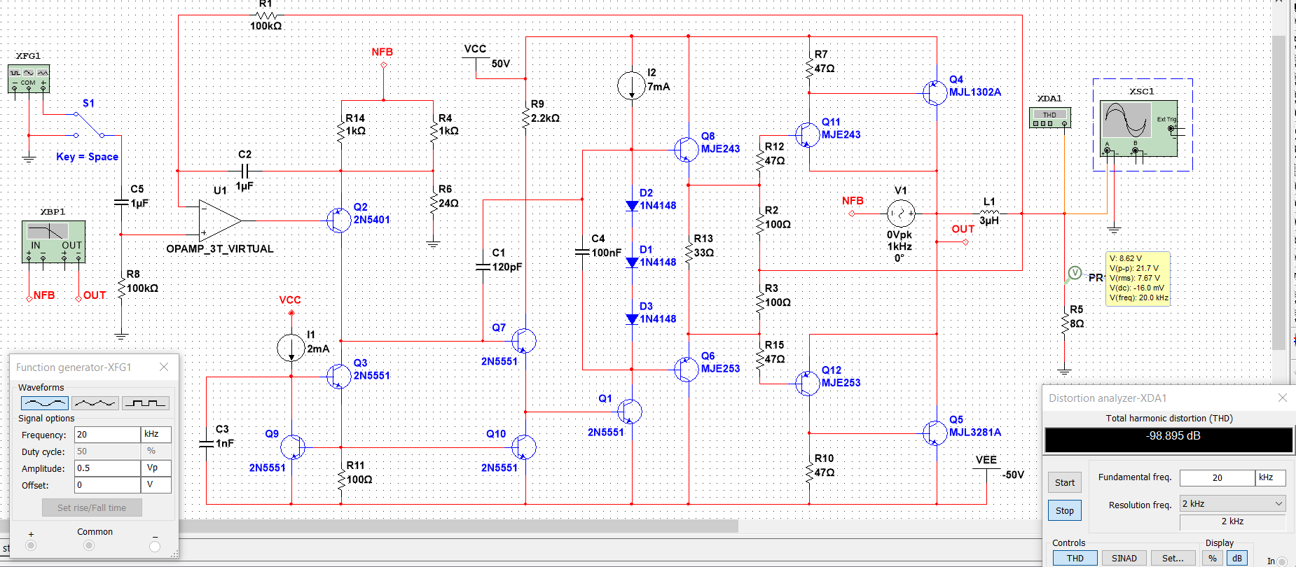

Flip the single end input stage, then I can use the high voltage n-channel mosfet as the input stage. There is no current loss. All the distortion is canceled out.
If you swap out the mosfet with 2n5551, I believe in the real world you would never be able to tell the difference as the current loss at the base of the bjt is usually below 1%. All other parts may have larger variance.

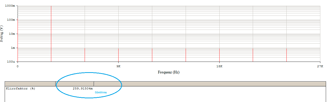

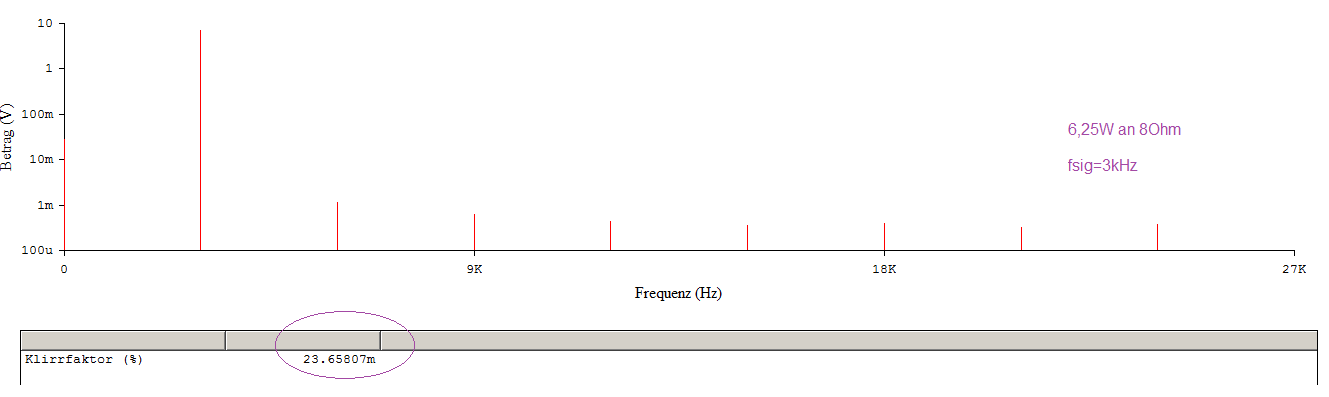

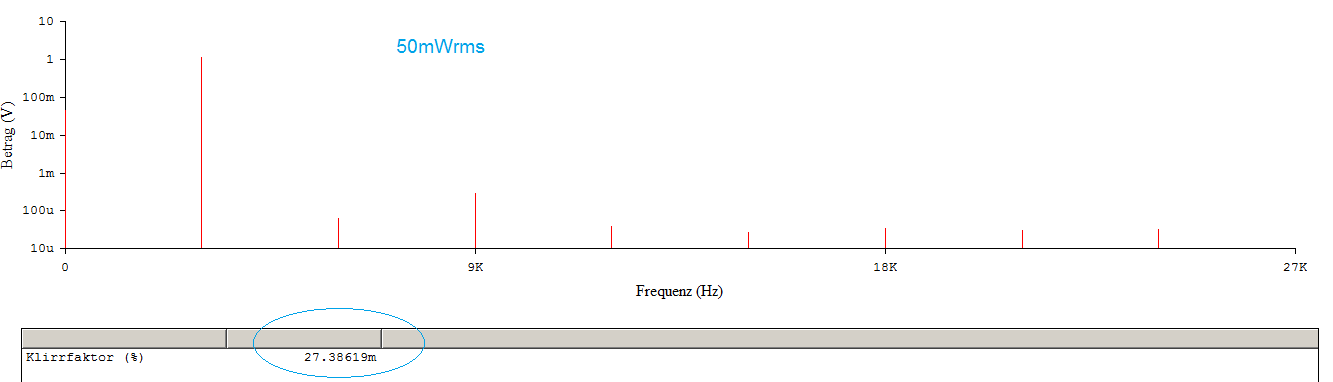

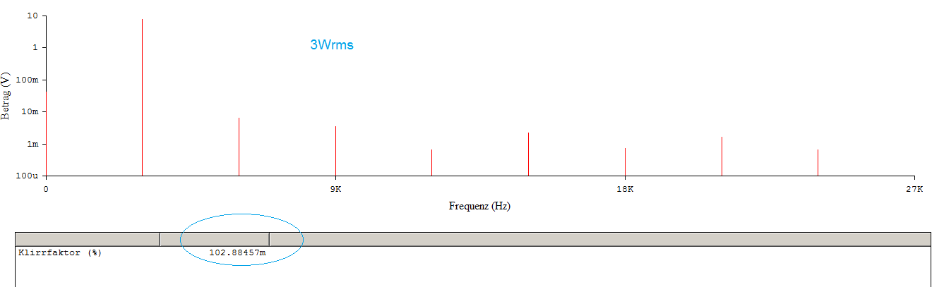

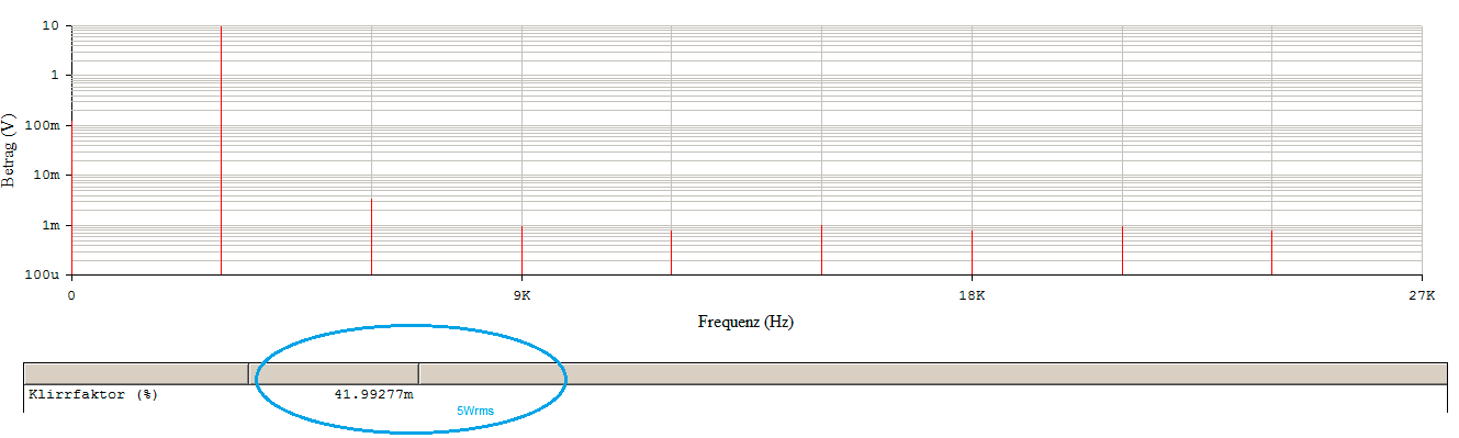

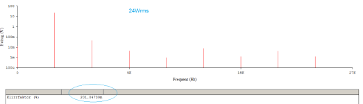

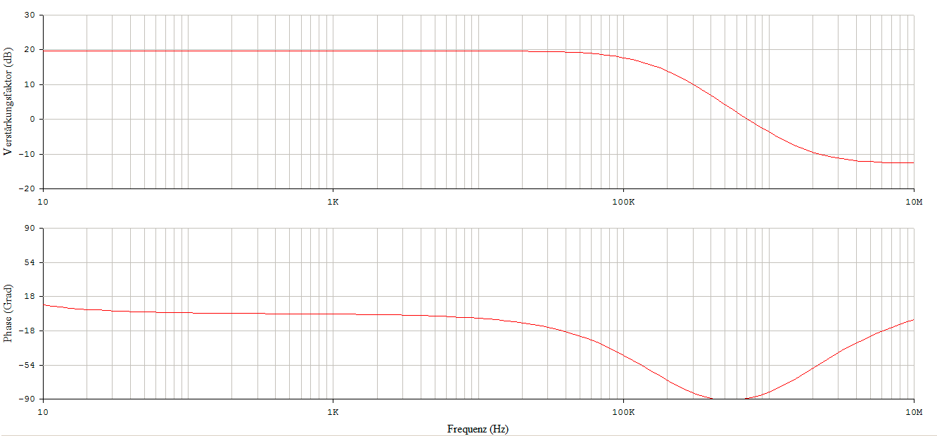

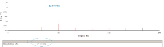

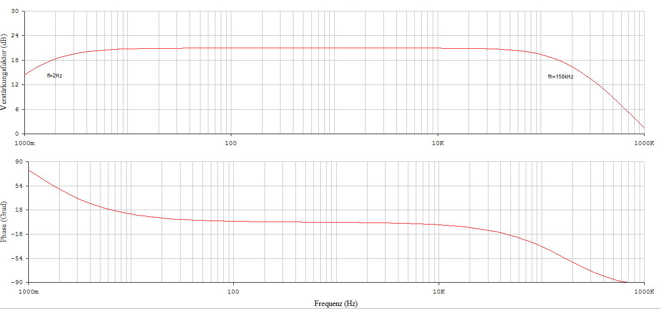

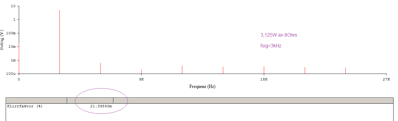

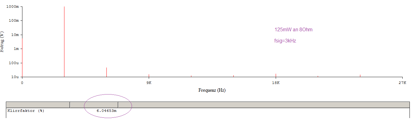

My little dumper:
not bad, but not particularly exorbitant either, just different 😵 😍.
