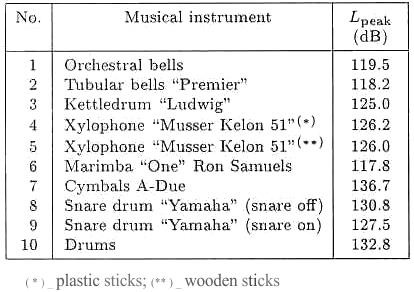

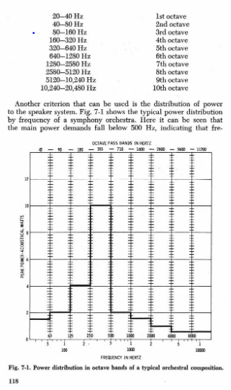

Does anyone have any experience with measuring or designing drum monitors.
Based on my limited knowledge of drums, the frequency response should be from 50Hz to 1Kh; with harmonics extending to about 6-10KHz, although cymbals can extend to some 15KHz.
So I plan to try my hand on a 2 way with a 12 midbass and a dome tweeter in a waveguide or compression driver in a horn/waveguide. It’s an excuse to use all those parts on the shelf.
What is the design targets for a drum monitor?
100dB/1m?
105?
110?
2 way?
Coaxial?
