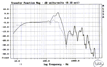

He then shows a nearfield response measurement of his Phoenix woofer baffle (a W-frame, actually) showing just such a peak:
He comments: "The PHOENIX woofer has D=19" (0.48 m) separation between its openings. The peak should be at f = 0.5*v/D = 357 Hz, but the cabinet layout is too complicated for such simple calculation to apply exactly."
This is what I read years ago. Going back to it, though, had me really scratching my head. The peak is nowhere near 357Hz, but also, I don't actually understand why SL said initially it's a l/4 resonance, (which is what you'd expect for a pipe open at one end) but then calculated the expected frequency as l/2.

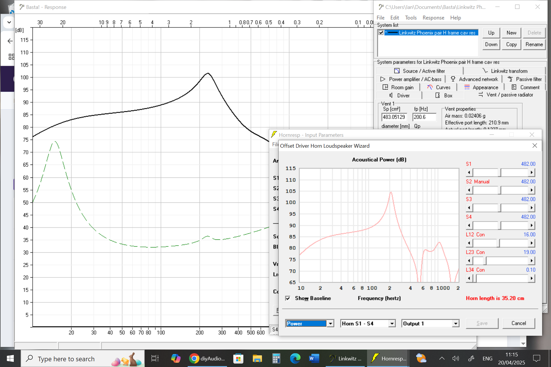

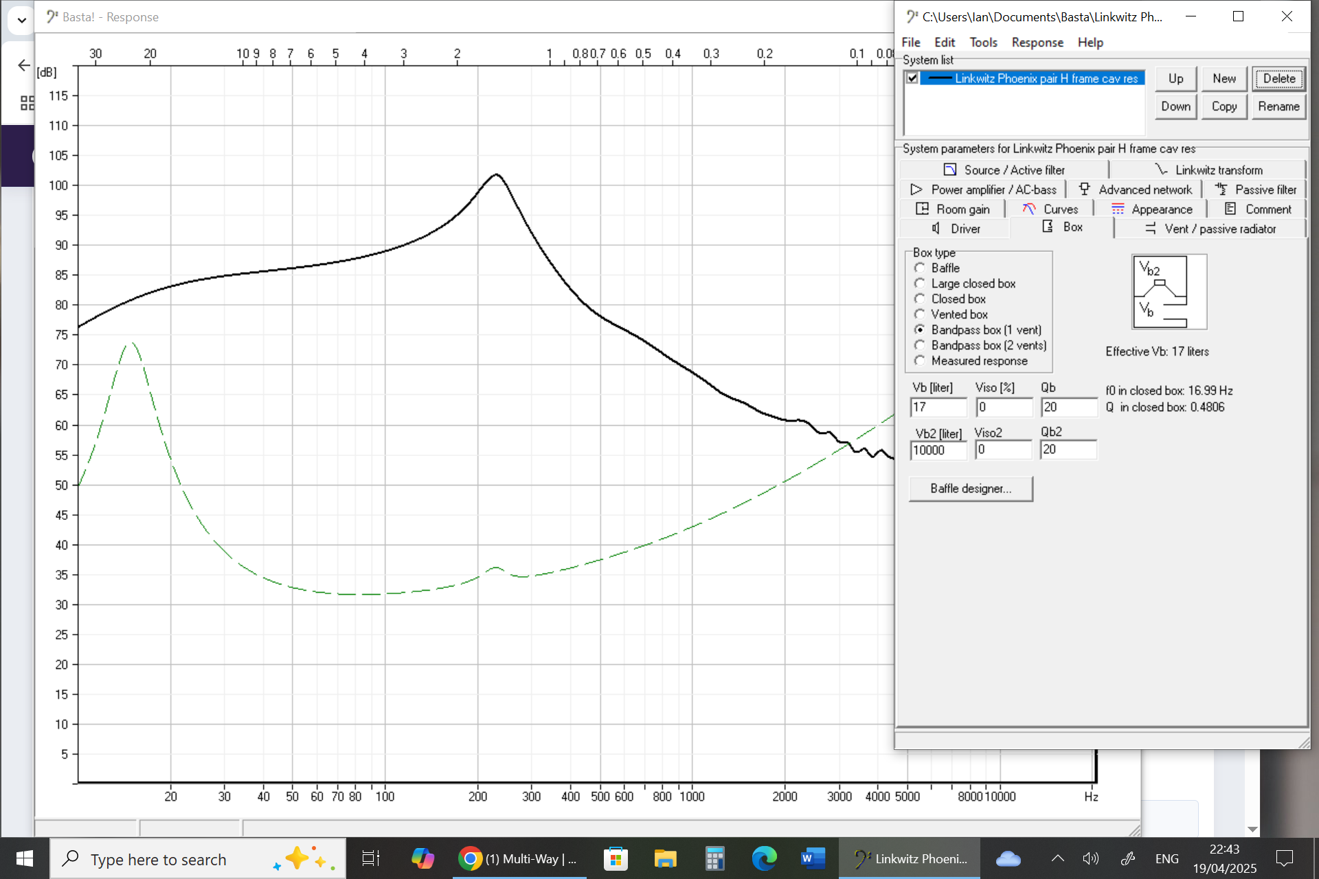

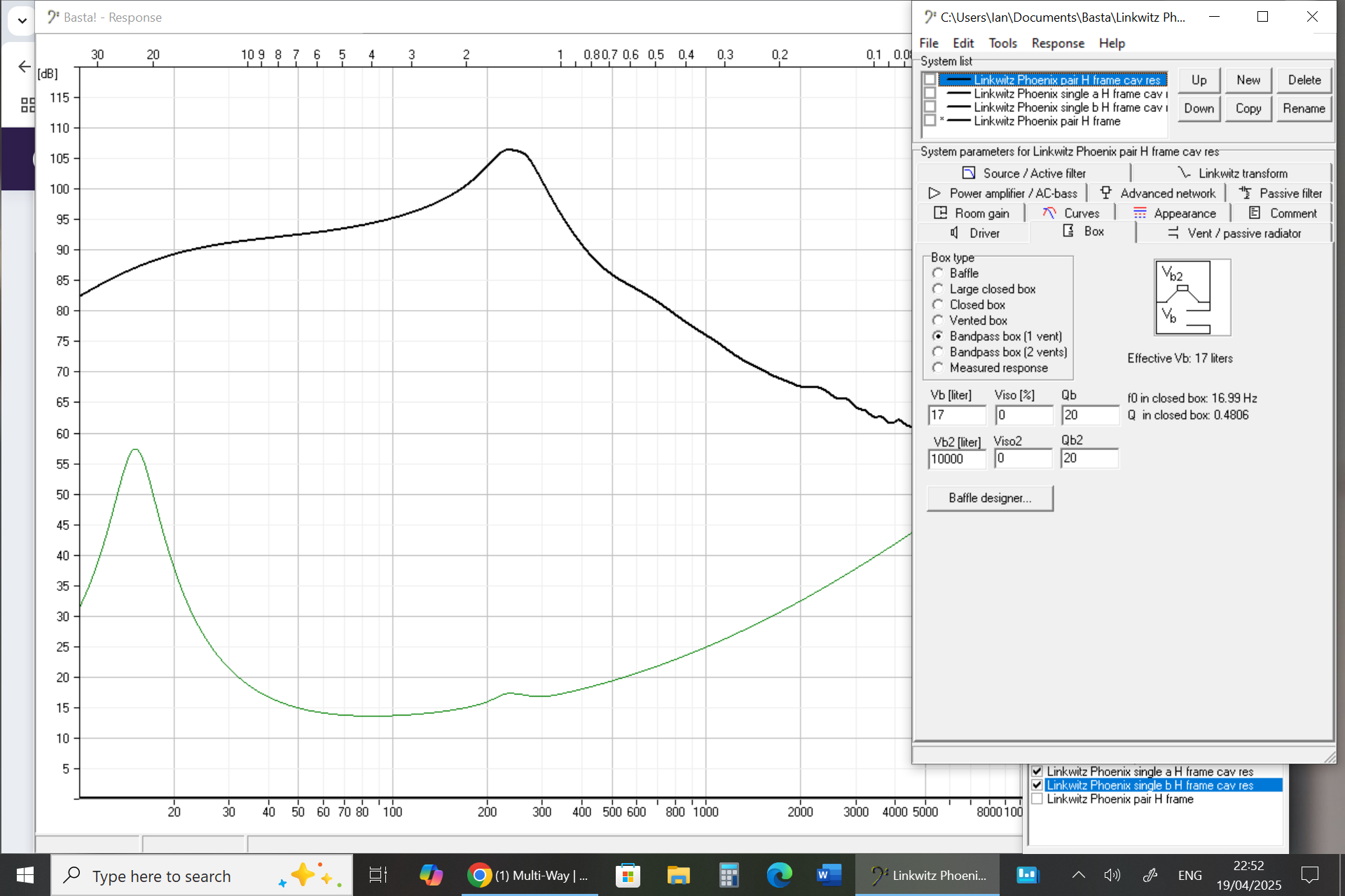

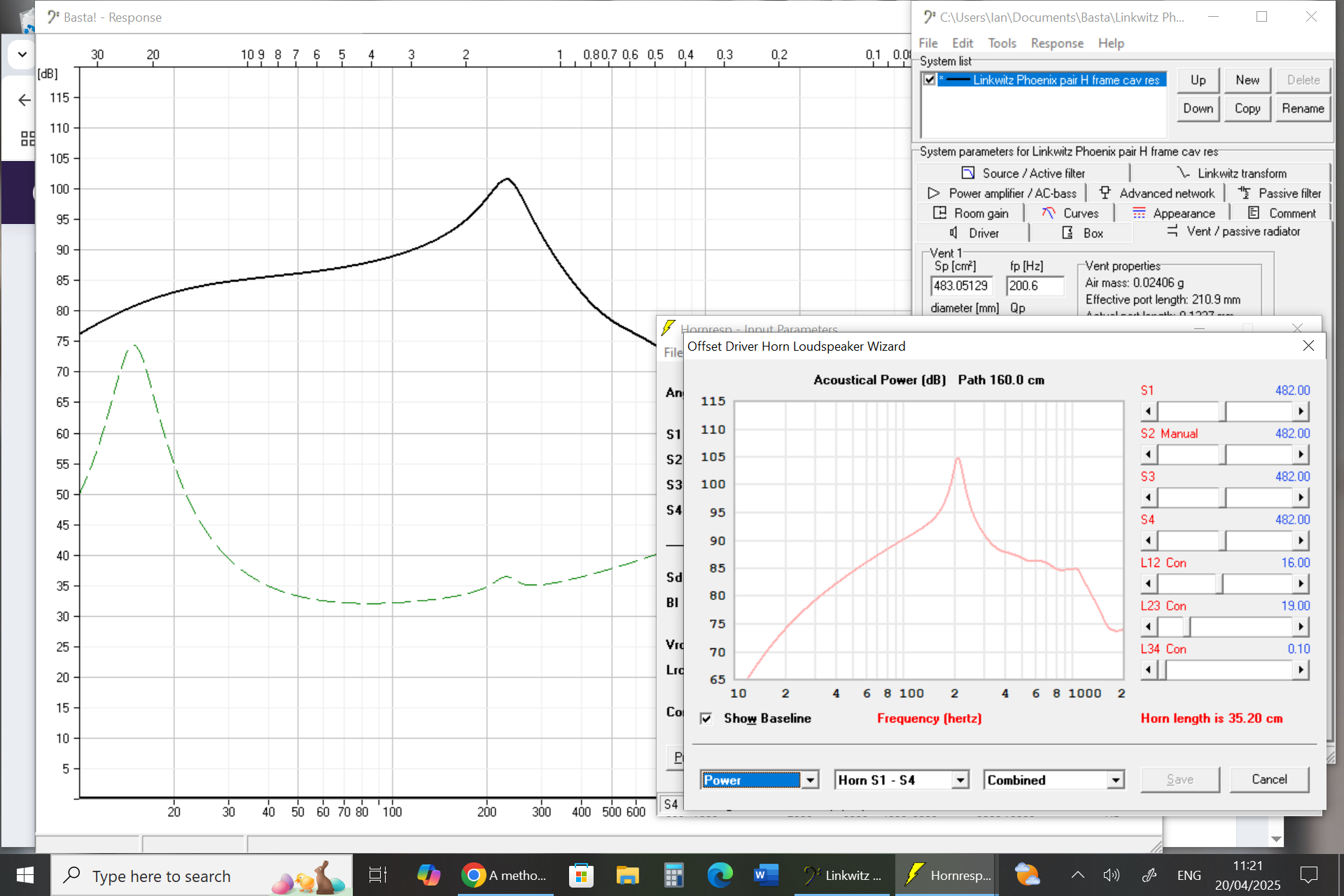

The next thing I realised was that there is an easy way for me to model them, because I'm familiar with how to model vented boxes in Basta! So, I fired up Basta! and had a go, and the results are very encouraging. The method I've settled on is actually not to model a cavity as a simple vented box. (Although you can if you like. However you'll get a rather 'busy' graph from that, with driver and vent responses, and a combined response that rolls off the low frequencies, but doesn't reflect the baffle dimensions.) A better way is actually to model a bandpass box with a single vent, and with the volume of the rear enclosure set very large. Like this: (NOTE: See post #14 below for my updated method.)
In this model, the driver behaviour is not constrained by the rear box volume, because Vb2 is set so large. The response curve you get is the response of the vent. You set Vb to your best estimate of the volume of the cavity, and then in the Vent/PR tab, you set the vent cross-sectional area to match the area you calculate for the cavity mouth. Then adjust the vent tuning frequency until the vent length is approximately zero.
I did this for the Phoenix woofer box (with a fair bit of guess-work) and got the response shown above. As you can see, it's not a bad match for Siegried's measured response. (There is actually a slight broadening of the resonance, because the Phoenix W-baffle dimensions generate slightly different resonances front and back. Siegfied's measurements show even more of a broadening in the resonance than my model did.) Note that the modelled response does not take account of the rear driver radiation, and therefore doesn't show the dipole roll-off at low frequencies. But Siegfried's measured response was near-field, so it doesn't show the dipole roll-off either. (You can model the dipole roll-off in Basta! by selecting "Baffle" as the enclosure type. You just can't model the roll-off and the cavity resonance at the same time.)

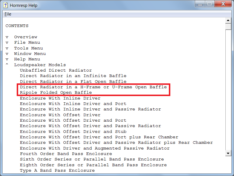

Hornresp can simulate H-Frame, U-Frame and Ripole loudspeakers taking enclosure "cavity" resonances into account.

OK, here's a quick attempt in Hornresp, using the input wizard, and modelling the front output of the Phoenix woofer unit as if it were an MLTL. The screenshot has both Basta and Hornresp models showing. In Hornresp, I'm showing Input 1, which is the front radiation.
(Note: if you compare the Hornresp prediction to SL's actual near-field measurement of the front output, in post #1 above, there's a remarkably good correlation above the main resonant peak - see the null around 500 Hz and the peaks above that. This is impressive!)

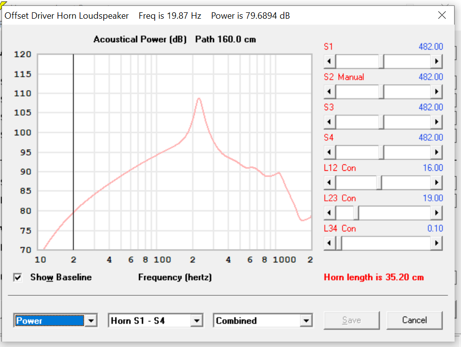

But if I show the Combined response, and use the Path Length feature to adjust for the effective baffle size, I should get a decent prediction of both the cavity behaviour and the dipole roll-off. Here you go:
Edit: I just realised I only entered one driver when doing the Hornresp model instead of a pair. That'll have thrown things off a little. Still, it looks like the method works pretty well.

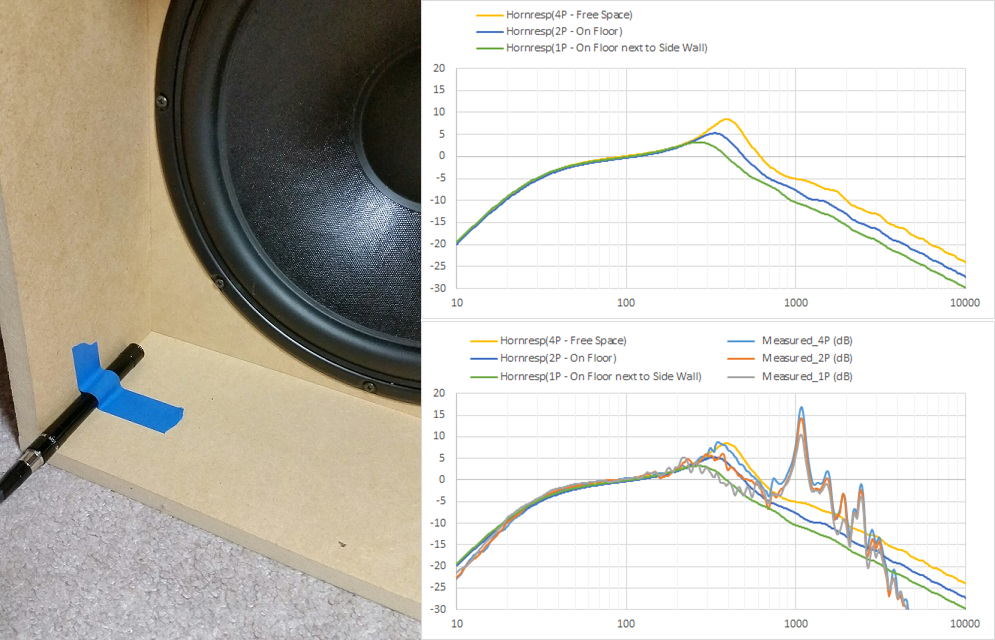

Here is an example showing measurements for cavity resonance of H-frame measured 3 ways, vs the Hornresp predictions.
You can see that as the radiation space gets smaller the radiation impedance increases. This increases the effective mass and damping (ie lowers frequency and magnitude of cavity resonance)
Note that the response peak just above 1kHz is the first SLS12 cone break-up mode, so not anything to do with the cavity resonance.
Is that the microphone (the black tube held down with blue tape) in the picture? If so, that is the wrong place to make the measurement if the pickup is near the baffle that the woofer is mounted to. The mic pickup should be located in the plane of the opening of the H-frame, or even a couple of inches farther out into the room (because there is an "end effect" just like with a port).

I corrected the Hornresp model so it has a pair of drivers (in parallel) rather than a single driver. Here's the plot:
Output is up, impedance down - as you'd expect - but also the centre frequency of the resonance has moved up from about 208 Hz to 226 Hz, (which is much closer to the Basta! prediction).
Good eye! Yes, that is a LinearX M51 microphone that I often use for measuring inside of cavities and ports due to its small size. As long as frequency of interest has wavelength > 10x the length of the frame or port( or distance from port exit), the measured response is essentially identical. At high frequencies the measured pressure response will diverge. For an extreme example see post concerning response at the input and output of a 1.6m long port.
https://www.diyaudio.com/community/...tween-winisd-hornresponse.311268/post-5169553
The mic in the picture was being used to improve measurement fidelity at low frequencies by splicing together measurements near the cavity pressure boundary and in exit plane of cavity to remove as much as possible the contamination of the acoustic output of the other side of the dipole woofer. Even so, you can still notice the LF roll-off slope not quite matching the expected -12dB/oct roll-off.
No doubt you have attempted to measure response of front baffle mounted ports that get contaminated by the nearby woofer output. You can measure inside the port to improve the situation, but do need to be aware of the 10x rule for the upper frequency limit of valid data.

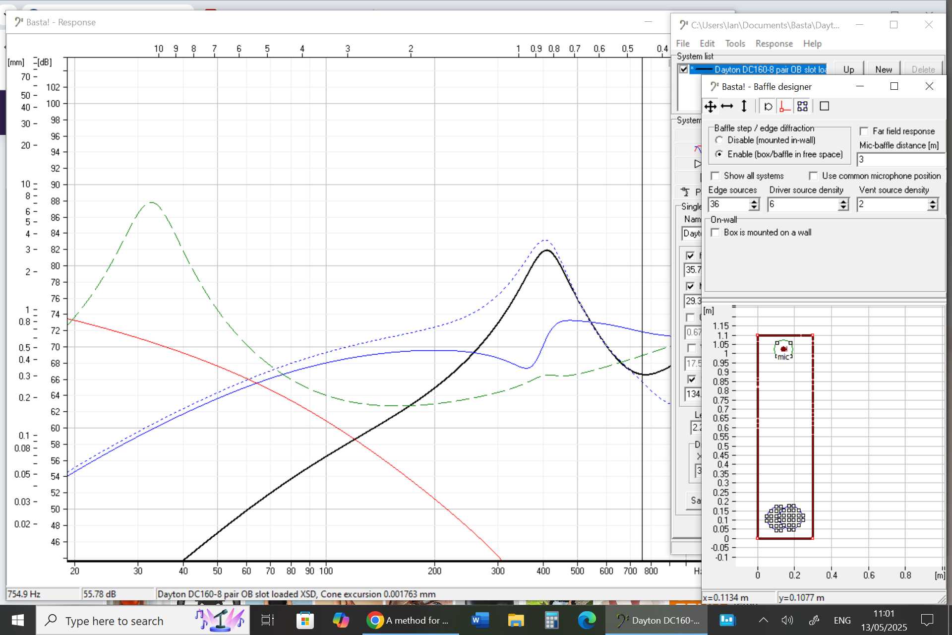

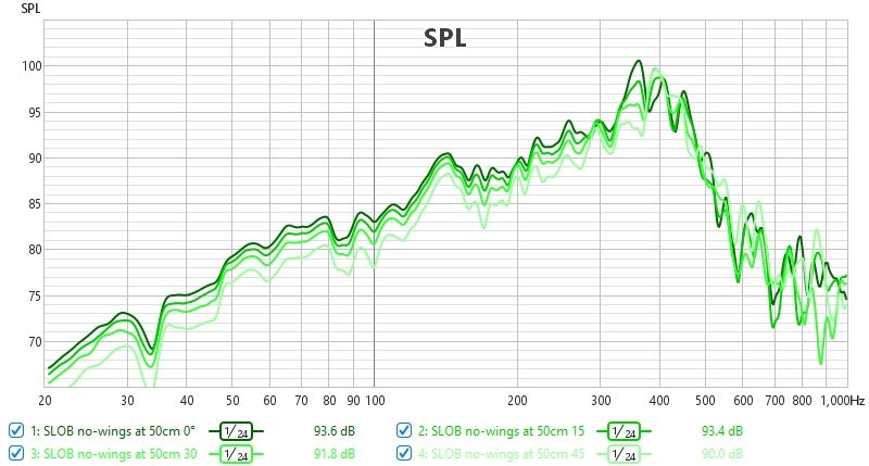

I noticed today that @LewinskiH01 has put measurements of his XSD style bass module up here: https://www.diyaudio.com/community/threads/the-xsd-speaker.385717/post-7904569

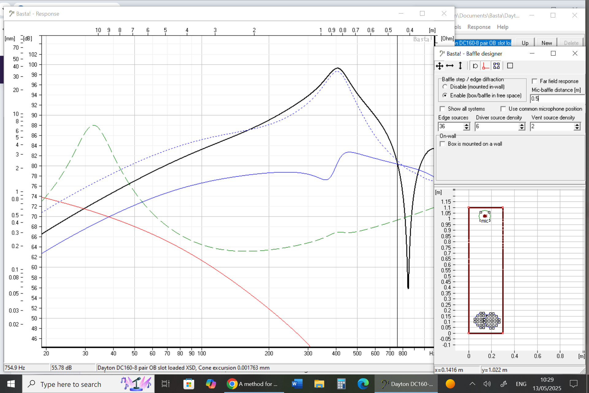

This gives me another opportunity to test how well my Basta! modelling might match measured response. So I entered the data for the drivers in LewinskiH01's build, the Dayton DC160-8 (which is not the original XSD woofer).
And I modelled twice. The first time I modelled the response for a pair of drivers in one of the XSD slots, treating the slot as a ported box and the mouth as a port with zero length (taking my best guess about the slot volume and mouth size). Secondly I modelled an octet of these drivers on an open baffle with the approximate dimensions of the XSD baffle. I reduced the source voltage to half of that used for the first model, to offset the 6dB increase because of the increased number of drivers. Here are the two SPL curves. Below 100 Hz the lower curve is the one to use, because it has the dipole roll-off. Above 100Hz you should pay attention to the upper curve, as it's the one that simulates the effects of the slots.
Now the measured response posted by @LewinskiH01 - this is measured without wings on the XSD-style bass module, and at 50cm. Basta! is modelling the far-field response, so you'd expect that the Basta! model would have a slightly steeper dipole roll-off.
Bearing all that in mind, I think the match is remarkably good.

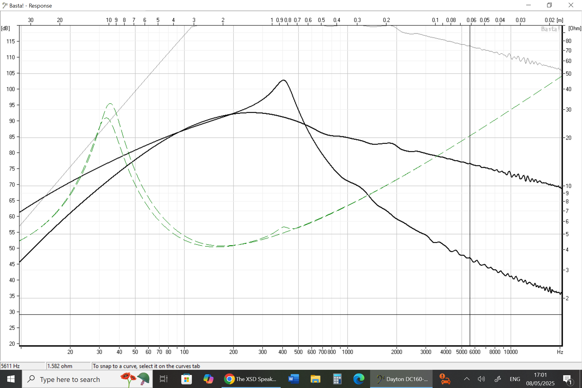

One more update: I worked out a smarter way to use Basta! to model the measurement @LewinskiH01 did on his XSD style woofer unit (see post #13 above). This time I modelled it as a vented box, but I worked out how to get the front and rear radiation to combine better. Here's the plot I got:
Black is the combined front and rear response; dotted blue is the vent output (i.e. the front output from the slot); solid blue is the driver output (i.e. the rear output from the woofer module). Excursion and impedence are shown too. (Remember, I'm modelling just a pair of drivers, not the full octet.)
To get the front and rear to combine properly, to model the dipole roll-off, I unchecked the 'Far field response' box, set the measurement distance to 0.5m (which is what was used in the measurement), and positioned the mic on the vent axis. I set input power at 1.4V.
Now, this is where there's still a bit of a workaround involved. Basta thinks the drivers are mounted on the front baffle, whereas in the slot-loaded module they're effectively on the back. So, as a workaround, I positioned the drivers and the vent apart on the front baffle, to try to give a 'flight time' difference that might correspond to the dipole path distance between the front and rear radiation.
The sim is a very good match for the measurement, I'd say, at least up to 500-600 Hz.

@David McBean David, I've been looking at Hornresp again, to see if there is a way to model the addition of wings to an open baffle speaker. (See Perry Marshall's Bitches' Brew, for example: https://www.diyaudio.com/community/...ead-perry-marshalls-live-edge-dipoles.424917/) The wings create something like a U baffle, but neither the depth of the U nor the cross-section area are constant, so the OB models in Hornresp's input wizard won't apply, so far as I can see. Am I missing something?
If you look at the curves for the front and rear output above, you'll see that the vent output is mostly about 8dB higher than the driver output - not a bad match.
A correction to my post #15 above. I realised that Basta! is not modelling any SPL gain from slot-loading - the higher SPL of the vent in the graph in post #14 is simply a result of the mic being much closer to the vent than to the drivers. Doh!
