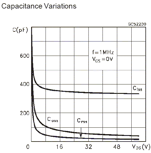

Not all mosfets are created equally. I tested all of the high voltage mosfets that were available from DigiKey at the time. The Toshiba 2SK2700 was the best. It also has the lowest transfer capacitance and total gate charge. It outperformed all of the IR fets in HF response and sound quality. There may be some new fets that are beter, but I haven't tested any recently.
The secret to avoiding voltage related non linearities is to run a lot of voltage across the fet. This is where the capacitance curves are almost flat. I use 400 volts in my 845 amp. I also noticed that the sound quality improves with fet current up to aboud 10 mA, so I run the fet at 20 mA. This obviously requires a big heat sink.
When I first posted the PowerDrive circuit on my web site, I was criticized by a lot of people (who never tried it) even to the point of being called transistorlab! Then the e-mail started arriving from people who tried PowerDrive. In the time since I published the circuit ALL of the e-mail from people who tried it was positive.
Like any circuit, it has its place. I wouldn't use it just anywhere, although I have never seen it cause sonic harm. It works well with most DHT's. I saw no improvement with 45's and 2A3's, but works well with anything bigger (including 300B's). Where it really shines is in applications where grid current is drawn. The grid impedance of a DHT will drop severely when it goes positive. Many DHT's remain linear in this region if the driver does not distort in this region. I measured grid current over 100 mA on signal peaks in an 833A tube. The mosfet is also indespendible in screen drive circuits.

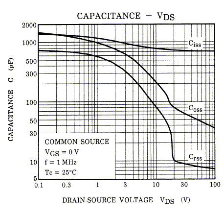

You may have found a part that works well, as long as it is biased with a very high Vds. I took a snapshot of the capacitance curves from the 2SK2700 data sheet (a part I haven't used). They're typically hideous below 100 volts, but data for above 100 volts are MIA. Yes, as a general rule FET capacitance curves do flatten at higher Vds values. Do you have data for Vds > 100 volts? You say that at 400 volts "the capacitance curves are almost flat". In my experience, even minute amounts of capacitance modulation can give a character to the sound. Capacitance modulation gives rise to phase intermodulation, which can be thought of as jitter in the time domain. We now appreciate the extreme sensitivity to the ear to digital jitter - even 100s of picoseconds matter. Testing for minute levels of analog phase intermodulation is very difficult when you also have amplitude intermodulation present simultaneously. So conventional measurements are out (I’m working on a PM measuring scheme, time permitting). Of course, even a tube CF can have RC time “constant” modulation, not so much from capacitance change (very little change, but not zero), but more from the variable R of the driving plate. But the tube’s capacitance is also typically smaller in absolute magnitude, reducing absolute and variable phase shift in the audio band with the same driving resistance. Personally, I would not be inclined to add a FET to a tube circuit in the absence of a strong reason to avoid a tube. But I respect your experience here, and would like to know more.

I have no data on the 2Sk2700 beyond what is in the data sheet. When I was designing the PowerDrive circuit for the 845SE I noticed that the capacitance curves for most fets flatten out as the Vds is increased. This was confirmed by discussions with a few of the CMOS IC designers at work.
When I had the circuit breadboarded on the bench I was using variable power supplies for the positive and negative fet voltages. I noticed that as the negative supply was increased (more neative) the sound quality (and distortion spectra) did not change after the voltage was sufficient to assure current flow through the fet at the most negative grid voltage excursion.
I did notice a change in sound quality and a slight improvement in the higher order harmonics (already at nearly the noise level) by turning up the positive supply voltage. An 845 is probably worse case due to the large voltage swing required at the grid. I tried bipolar transistors in this application but they sounded noticibly worse even though the capacitance issue should not be as much of a problem. It is also hard to find BJT's with good SOA capability at this voltage level. The driver tube was a 45 running at 25 mA (CCS loaded) so there was sufficient current and slew rate capability to drive the fet or the bipolar transistor.
I do agree that the variable capacitance can cause phase distortion and this could be audible. This may have been what I was hearing when I was playing with the power supply knob. The effect was most noticible on HF sounds. like cymbals (especially ones with loose rivets in them). The kinds of sounds that are absoulutely destroyed by MP3's.
I find that the abrupt change in grid impedance caused by entering the positive grid region will cause a much more objectional distortion (sounds like crossover) that requires a very low impedance driver, at least while sourcing the grid current. If you think about it, the mosfet driver (or any follower) circuit is asymetrical. The current that it can source is limited by the ON resistance of the active device and its power supply. The current it can sink is controlled by the source (cathode) resistor.
In this case we are trading one distortion for another, which is usually the case in any amplifier design. I believe that a mosfet can be a useful driver in places where grid current is drawn, and yes you have to use a very small grid stopper with ferrite beads to avoid yet another nonlinearity.
At the time that I discovered PowerDrive I had tried most of the common types of driver circuits. When I found the PowerDrive circuit I stopped looking at the driver and went on to build the amp. I have never looked back, and I am probably guilty of overusing the circuit, but the amps that I have put it in have been well received as "punchy and dynamic". It could be that they are just colored in a slighthy different way when compared to the average 300B amp.
I tried the PowerDrive circuit on 6L6 type tubes, and I didn't find much change in a normal music situation. It did improve the overload characteristics when I ran my guitar through the amp and pushed it into hard clipping. I did however get an e-mail from a user who said that it made his KT-88 (HiFi) amp come to life. I have no idea what the operating conditions were. Most happy users were running transmitting tubes, particularly the 811A.

One more note: the BJT, while not having the dramatic capacitance problems of MOSFETS, do have variable capacitances that are pertinent to audio. The base-to-emitter capacitance can be enormous as well as emitter-current-variable, although it is rarely considered because it is shunted by the relatively small base-emitter resistance (a short TC) and it is bootstrapped by the emitter which follows the base to a great (although non-linear) degree. The real culprit typically is the capacitance of the reverse-biased collector-base diode which significantly modulates with Vcb changes - think of it as a varactor. It may have a smaller magnitude compared to a comparably rated MOSFET, but it’s no less ugly. The Miller effect amplifies it, and its effect on the amp is dependent upon driving resistance, of course.
I have said before that I think the whole area of capacitance modulation is the biggest unheralded difference between the sound of tubes and transistors. If I can find the time to finish, I plan to publish on these topics, along with test results and measurement techniques. We own several businesses that I thought would be fun early retirement diversions, but they have turned out to be 24/7 time consumers (I keep telling myself that “busy” is what I wanted for these businesses, but now I have to live with that).

In a source follower, the reverse transfer capacitance is key. The smaller the better.
Check out the IRFBC20, which has an attractive 8.6 pF. reverse transfer capacitance.

The Crss is the capacitance from gate to drain. Since the drain is AC ground in a follower, this is indeed the important spec. For this fet the capacitance is not only low, the curve goes relatively flat above 20 volts. Like the guy in the movie says "I gotta git me one of these". I will get some of these next time I order parts from DigiKey.
