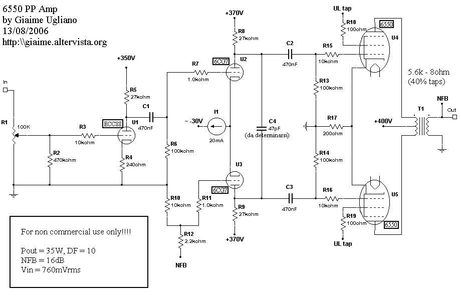

Hello all 🙂
after much scribbling and looking at various designs, I finished up a preliminary schematic. What do you think?
Spice works real bad with partial feedback, from the output tube plates to 6CG7 grids, it appears that distortion INCREASES instead decreasing, and I can't understand why 😕
So I made the amp with the usual kind of negative feedback, but I'm willing to implement partial feedback since now nfb is too high, 16dB, and may cause trouble.

Giaime said:
Hello all 🙂
If you mean this literally, then it's no wonder the distortion increases. Going from the finals to the driver grids gives positive feedback. That does the exact opposite of what you want to do here: narrows bandwidth, increases output impedance. Using pentode finals, the output impedance is already too high, and you certainly don't want to make that worse. Positive feedback there simply undoes what the Ultralinear connection is trying to do. Since you are going with an Ultralinear topology, you don't need any parallel feedback off the finals' plates anyway.
You don't need another inner feedback loop for the finals. That's what Ultralinear accomplishes. It's not my choice in my designs because it's not tweekable, so I opt for parallel feedback off the plates which is quite tweekable. However, both topologies work the same way: local NFB, and accomplish the same things: lower the effective r(p) of the pentode finals, and convert their dynamic characteristic to be less pentode-like and more triode-like.
I suspect that 16db(v) of gNFB may be too much. The one and only way to know for sure is to actually build the amp, and listen. When I did this, I quickly discovered that the 12db(v) of gNFB I had originally selected was way too much. If you get the "solid statey" sound: bass over emphasis, loss of clarity to the mids, vocals that seem to receed into the background, almost nonexistant highs, then you'll know it's too much.
Miles Prower said:
If you're going with an Ultralinear connection, which the schemo seems to indicate, then you won't be needing any extra feedback from the 6550s to the 6CG7s. You already have the local feedback.
Not necessarily. A couple of years ago I made an amplifier for which I tested about twenty different output stages using different pentodes ranging from triode-strapped with various forms of feedback to pure pentode with various forms of feedback. Finally, I found a configuration that worked for the valves I'd chosen. UL N78 plus cathode feedback. It was far better than any of the other options I'd tested. But only for N78 - didn't work for EL84 or any others.
One of the design goals is to have a DF = 10.
I don't know if I have made all calculations right, but looking at the ultralinear plate characteristics I measured a rp (dVa/dVg) about 1.6k for each tube. Thus the reflected output impedance, plus a hundred ohms primary DC resistance, and 0.2ohm secondary, gave me about 5.5ohm, so to reach 0.8ohm, 16dB are necessary.
Is there any other way? I'll investigate on cathode feedback, since I will have the transformers custom made.
I wouldn't worry so much about that. You aren't going to get the same levels of DF that you can get from SS, and that design goal may very well conflict with others. There is a good chance that 16db(v) of gNFB will sound really bad. I found that 12db(v) in one of my designs was very bad.
4.0db(v) sounded much better, even though the DF was obviously better with the higher feedback. Having tried both Technics SB-K25 (OK) and Bose 201 (Vast improvement) speakers with the lower level feedback with the "worse" DF, I don't have any problems related to this. Bass has plenty of "authority" and clarity, with no trace of any of the underdamped "sloppiness" that was all too obvious when running with no feedback at all.
DF isn't the end-all and be-all of how that's going to sound. I wouldn't sacrifice other sonic qualities for that. :no:
You know Miles, I would agree with you, but that amp has to drive 38cm Tannoy Dual Concentric, and they need hefty DF.
But he's now using a trioded EL34 PSE, and he likes that (aside from power output), and in that case DF should be in the order of 4.
I'd like however to keep 16dB of *total*feedback, but dividing between 6dB of global and 10dB of local, I have to find out where and how.
