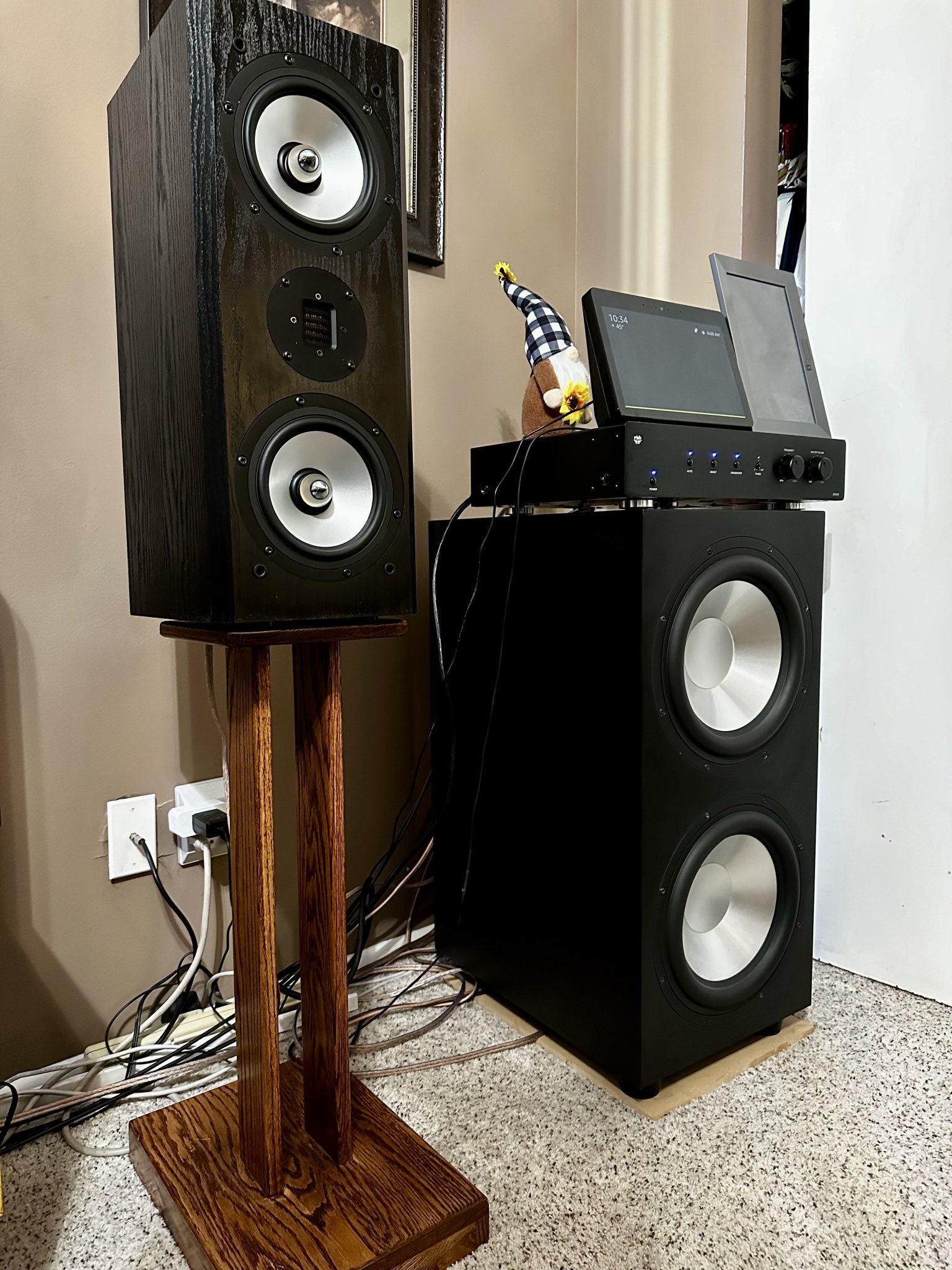

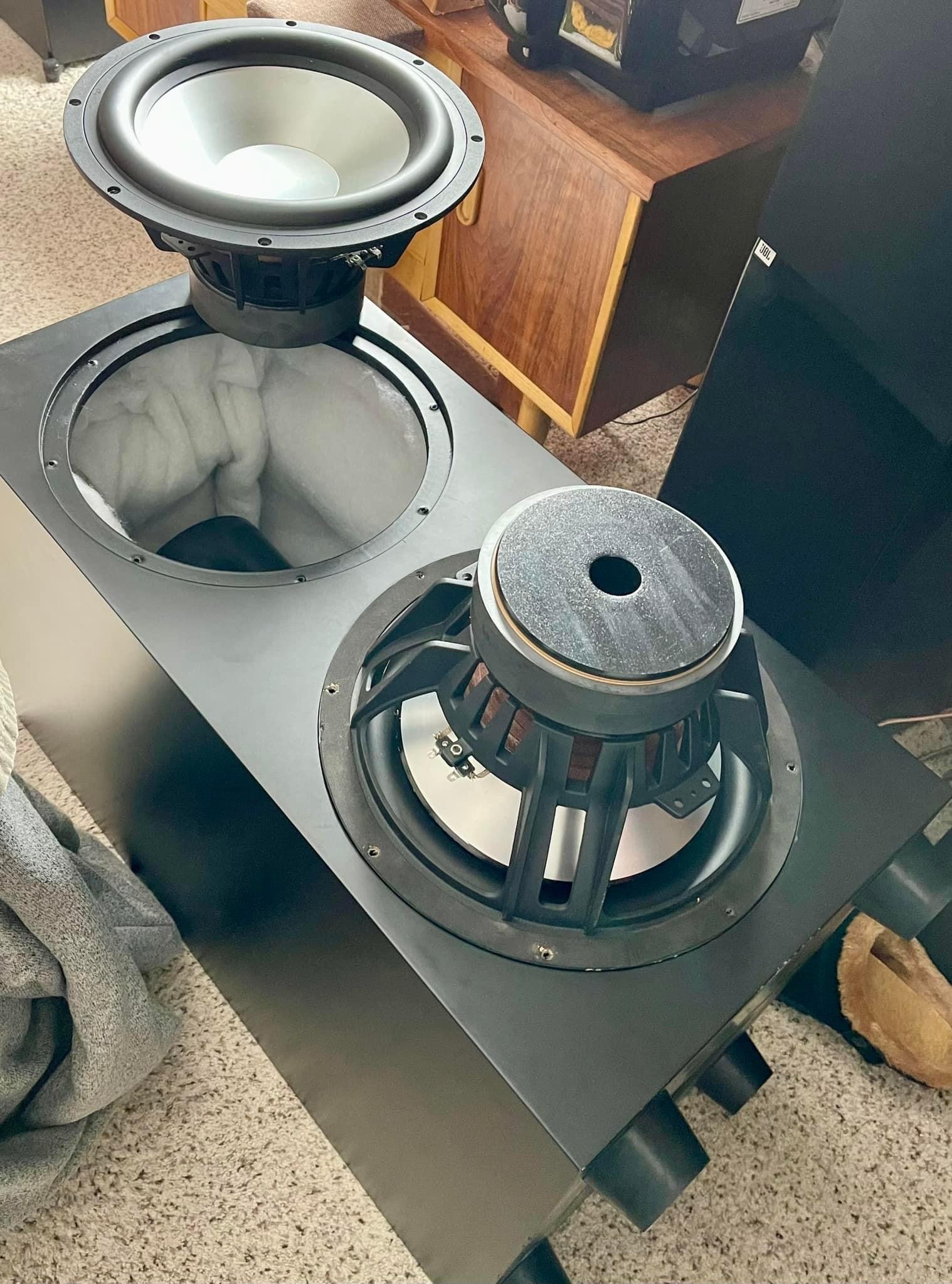

I finally have a bead on all of this. Using my Rotel preamp, I’ve been able to boost the sub up and bring everything into balance. This very small class d package has enough current to make two heavy cast frame woofers jump from the frame. The Rotel RB-1092 amplifier contains two of these ice modules inside. I’m a fan.

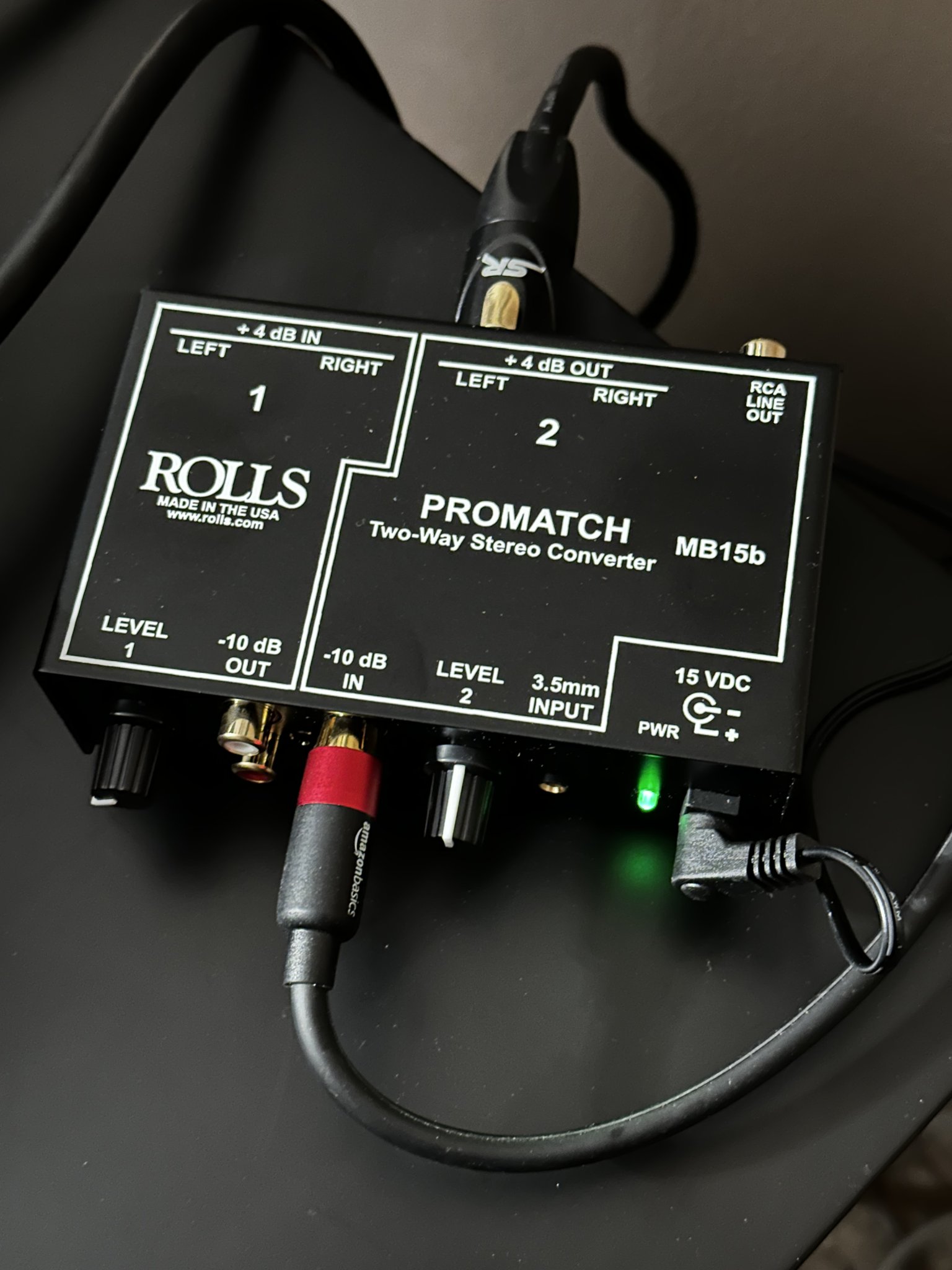

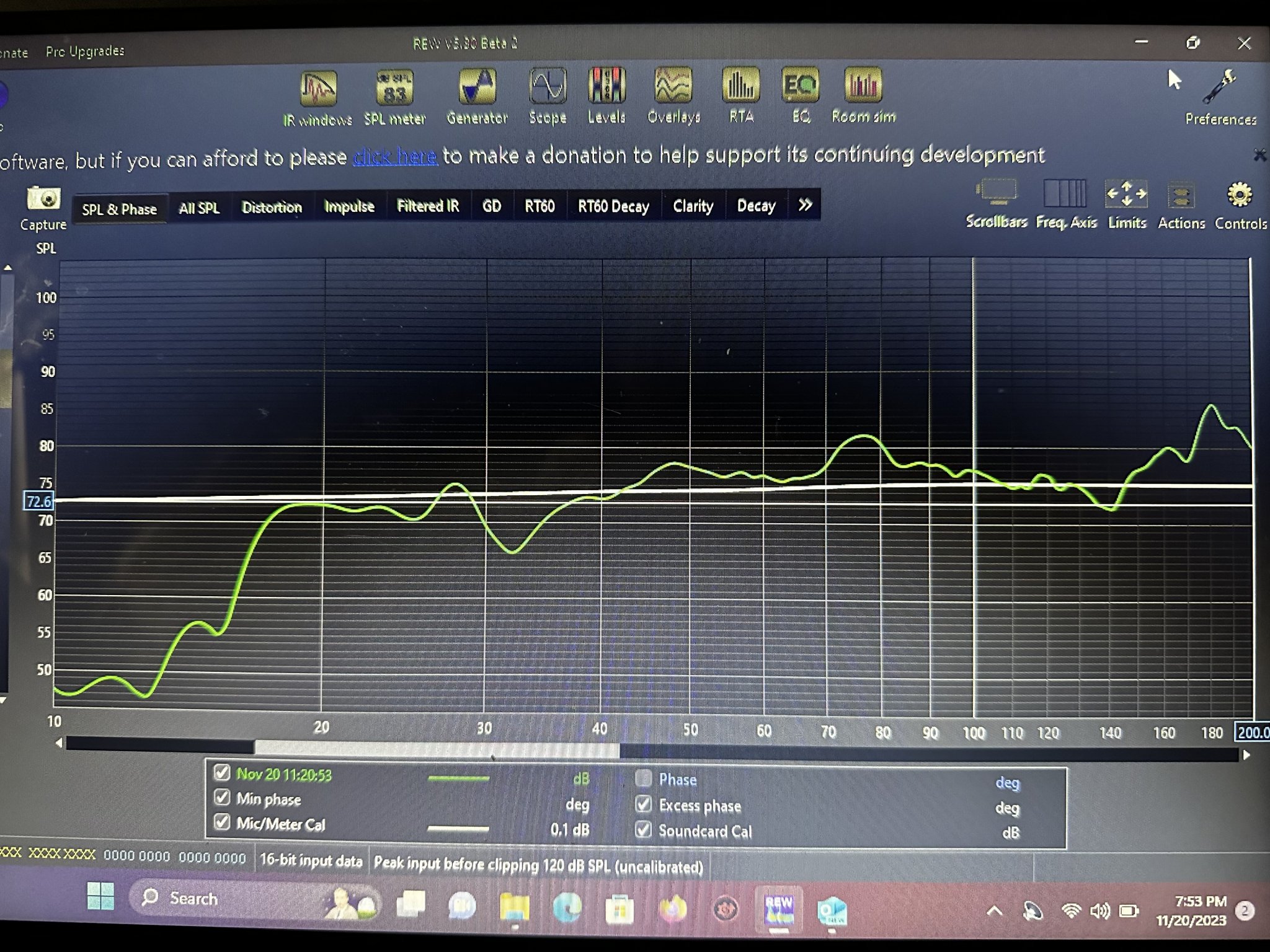

I picked up a Rolls device that converts balanced to unbalanced and so forth. It has a pot to adjust the output voltage. The amp is in service. I’ve tested the sub design using the amp. Tremendous power. The cabinet is flat from 17Hz-200Hz. Really pleased. Rolls also makes a little active crossover. It’s the best sound I’ve heard from this new cabinet. Especially excited to see sub 20Hz performance from this cabinet size. Thx all.
