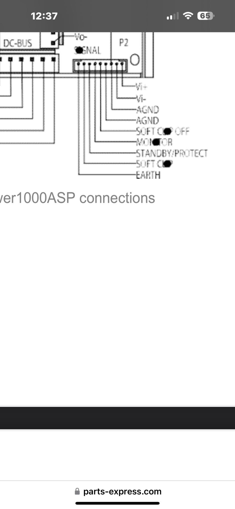

Greetings,
New member. I’m sort of stuck on the input. The purchased kit has both balanced and unbalanced input hardware. The only input on the module is Vi+ and Vi-. I’m not sure if both balanced and rca input jacks use this one connection, or if it’s one way or the other?
Any help would be greatly appreciated.

A differential ("bal") input is ment to be hooked up to a differential source where 3 wires are used; +/-/0, thus in/out is matching.
If a two wire source (+/0), one can hookup like:
Out---In
0 --- 0
0 --- -
If your kit contains an active receiver board with SE-2-Diff conversion, this is taken care of on that board and the board to amp connection is differential. It would mean that that board has both type of connections; RCA and XLR..
Good luck!

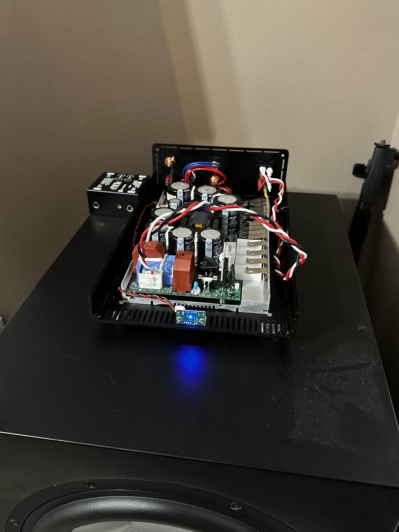

Well, I’ve made the adjustments. I’ve been able to control/blend the sub into my existing 7.2. Popped in Master and Commander…scared the hell out of me. It can push current. My remaining issue is low level hum when the RCA is connected….suspect a ground loop.

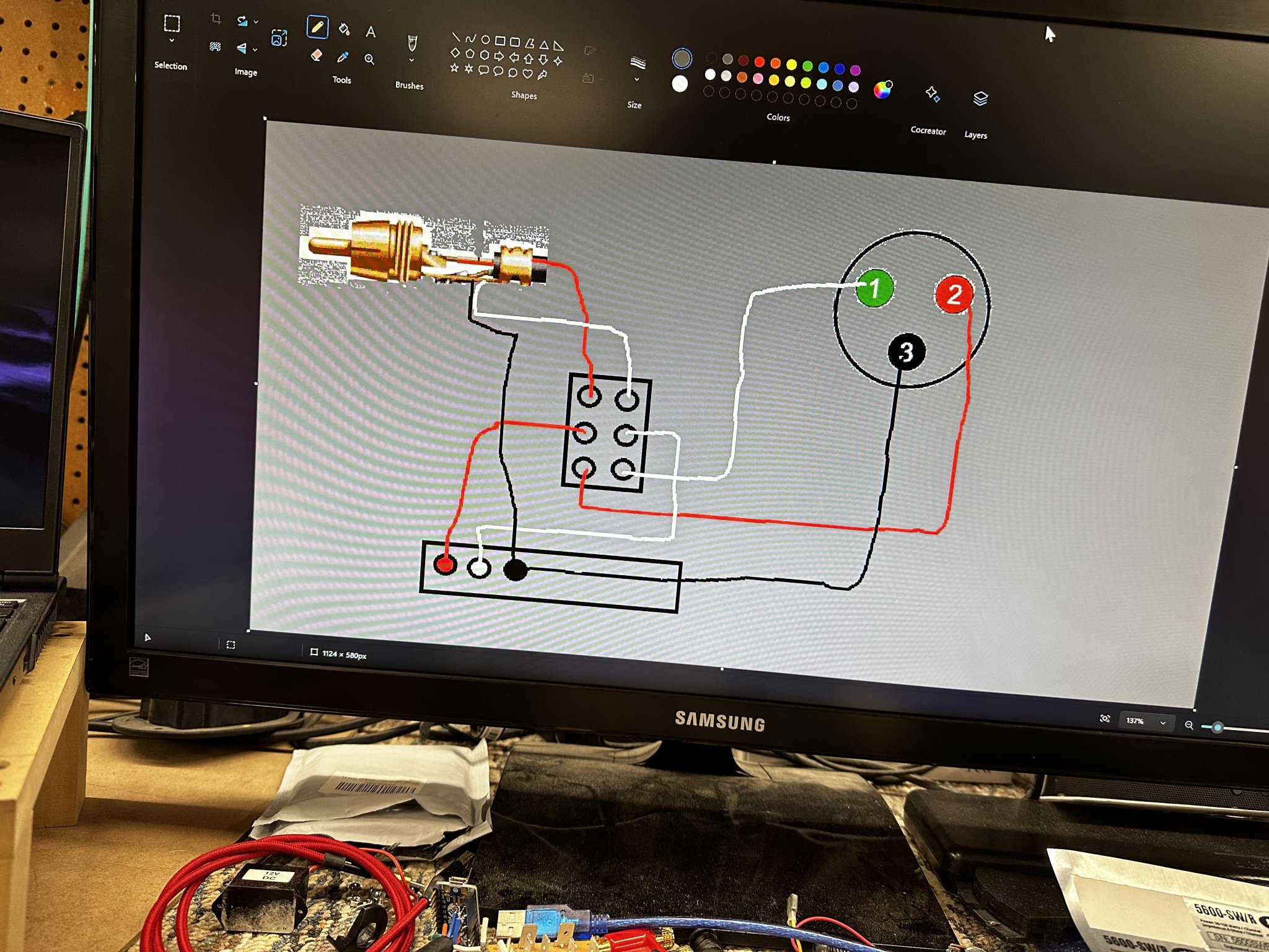

I’ve two preamps that have balanced outputs, so I may re-solder the rca input over to the balanced. The case has a toggle switch to go with the rca or to balanced. I may use it.

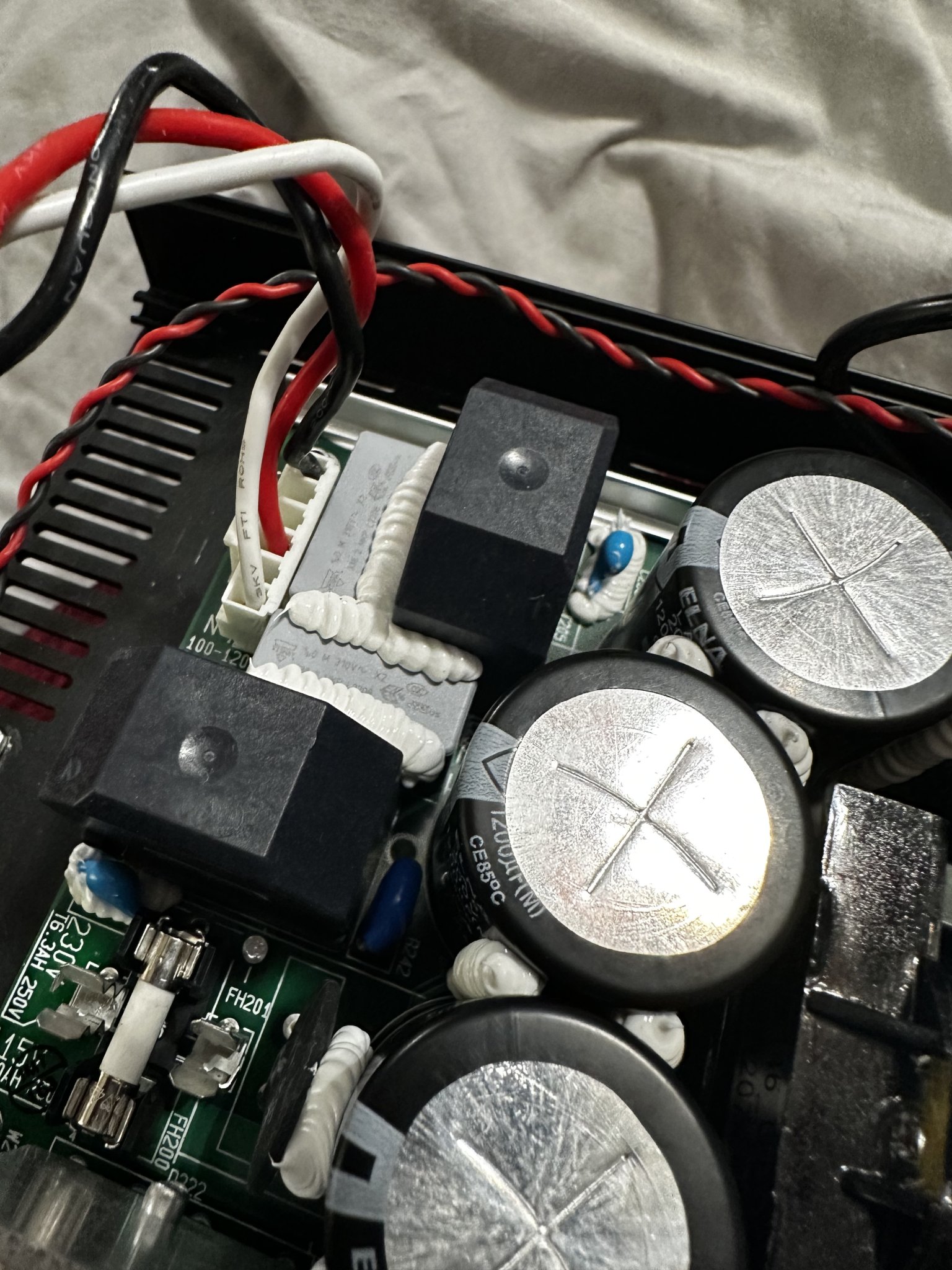

I went out to my old company for a little aid. Confirmed my one amp is dead. I put my new amp module in. Wiring is straight forward. When it’s all in, I plugin the source via rca and there’s the noise again..just awful. Remove the rca, all quiet. It’s grounded perfectly. I added one more ground point to the module.
I brought it home to my Rotel system, all plugged in. Interesting, that when I unplugged the preamplifier, the static roar came back….loud.
With the preamp and the other two Rotel amps plugged in, the hum is still there, but very low. The current it provides to my massive RBH Reference sub is crazy. I could drop my Sheetrock walls should I desire it.

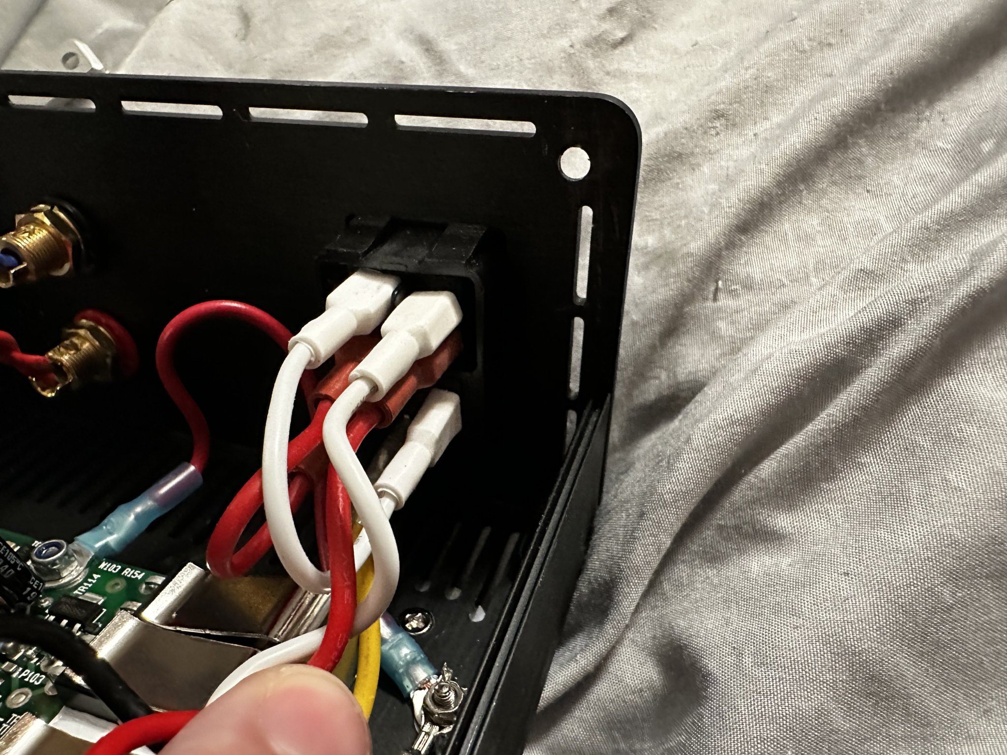

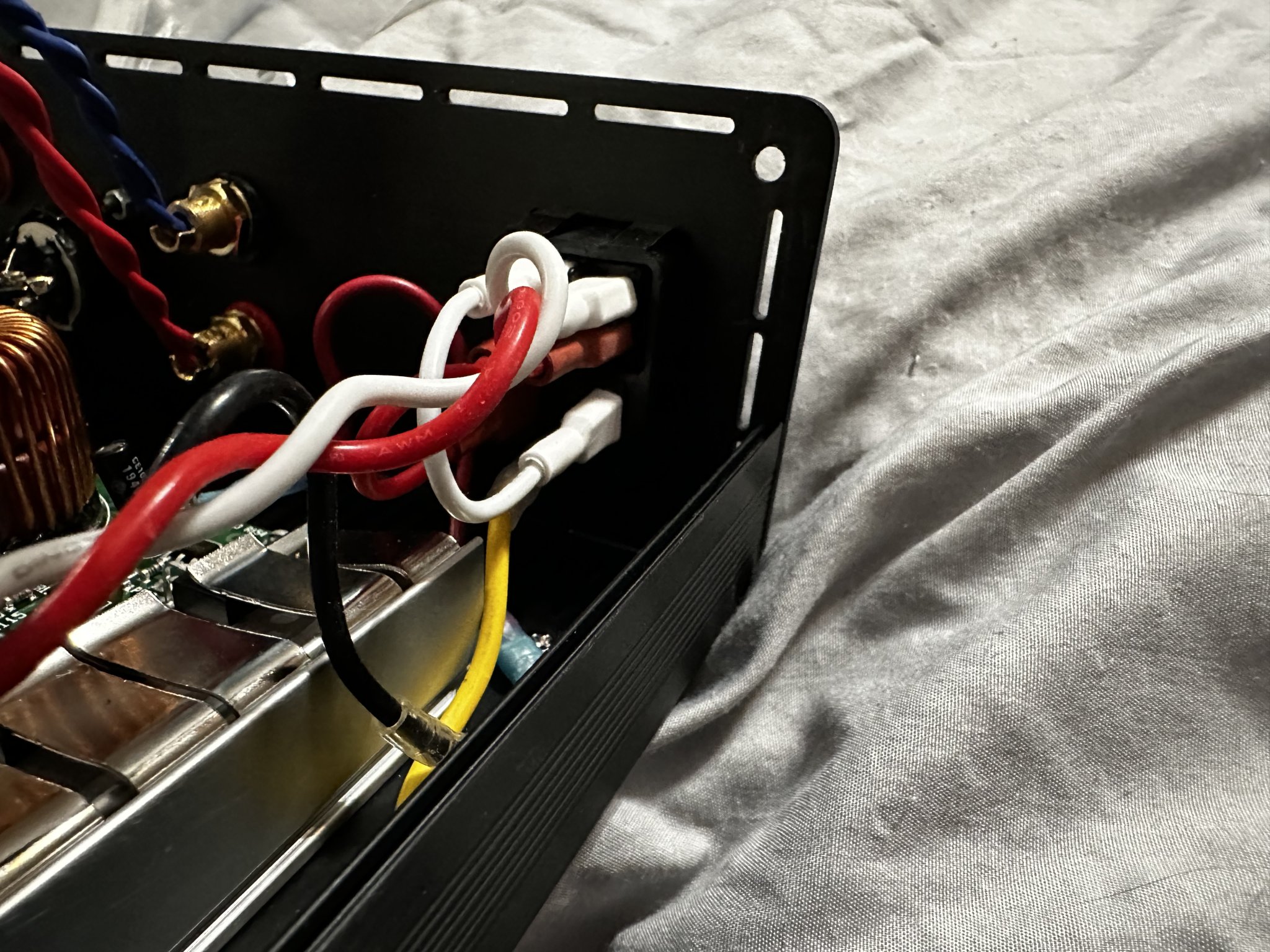

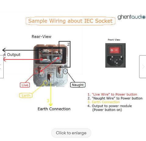

OK, slow down. Your power connection - from your pic it appears you may have the L (Live) and N (Neutral) reversed. If your switch is on top in back, you are switching your Neutral leg. Please check this first.
Please post a closeup of the connector that has inputs.
These kits are really not documented properly...but do check power connection first
OK, the switch is both nuetral and live, but still looks off...follow pic below - outputs go to Amp power connector
Reactions: OpieT
OK, looks llike your switch is just reversed, but L and N connected correctly...cannot see your Mains Ground connection
Post pic of your input connector. I just used the three connections below for XLR. For Single Ended, just tie the AGRD to the neg input (Vi-)
Where does this yellow wire on mains ground pin go? The ground pin on amp power connector (your black wire) should go to chassis Screw stud and chassis screw stud wire should go to the Mains Ground on power plug. That should be all that is needed...You have that second red wire connected to amp chassis bolt going somewhere...dont beleive you need that...
Yellow wire looks like it goes under the amp module? Connect it to Earth chassis Screw Stud
