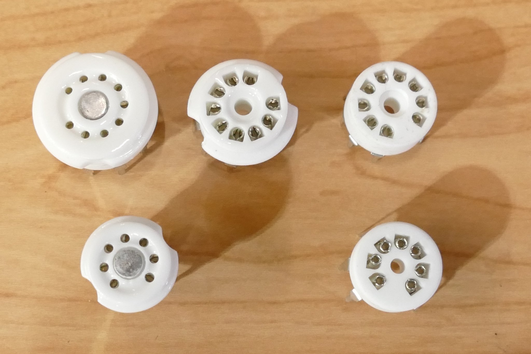

Wait a minute - the 6n2P is a miniature double triode that takes the 9-pin noval socket. There are scads of sources for those. I would advise to stay away from the pcb sockets with the tiny holes, as I have run into sockets where the holes are too small to pass the pins, making it near impossible to seat the tubes. Sockets with larger holes and the "sleeve" contacts generally work better.
If you don't mind plastic sockets, Antique Electronics has sockets for the 6n2P at about $1.50 apiece - should be quite suitable for a low-power tube like the 6n2p. Ebay also has a large number of vendors with suitable sockets.

I don't think that Gnobuddy would have a lot of luck plugging a teeny 6n2p into a magnoval socket, or even getting the socket to fit into the original holes. for the 6n2p. I think that he ran afoul of a socket with holes too small to pass the pins. I have had my share of problems with those riveted-together sockets with tiny holes on top - the quality control is spotty at best.

A mini tool with a carbide tip might do the trick. George/Tubelab mentioned a while back that he had to do that with some sockets where the holes for the pins were too small. I would just cut off the old sockets and replace them with something that works better - that's what I did with the ones that offended me previously.. That's also why I posted the pictures of sockets - both recommended and not recommended. A pair of good sockets won't exactly break the bank...
I use the chassis mount versions of Socket #1 all the time. The ones I’ve had trouble getting tubes into were the 7 pin variery. I had a few 9 pin that were seriously mis-shapen, but I just set those aside. They’re cheap enough that you don’t need 100% yield.
The 9-pin PC mount sockets that gave me trouble were type 1. I whacked them off the board with a pair of cutters and replaced them with type 2 sockets, which fit just fine. I have some 7-pin chassis-mount sockets from the Russkies - they are of type 1, but they have no fit problems, as the quality control for Russian military parts is far better. I think in retrospect that the sockets that gave George/tubelab problems were 7-pin. I have a bunch of bakelite PCB

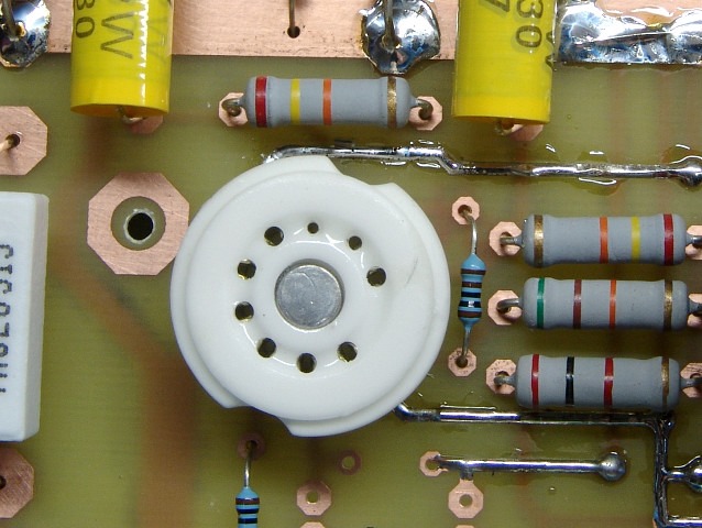

The junk sockets were 9 pin "type 1s" from early 2006. This picture shows one of them in the first DIY prototype of what became the Simple Push Pull (SPP) board. The picture is dated June of 2006. Unfortunately, I did not see this until I tried to jam a 12AT7 into it. I went through the rest of them and found one more with small holes. Attempts to fix them with a Dremel tool usually resulted in a broken bit.

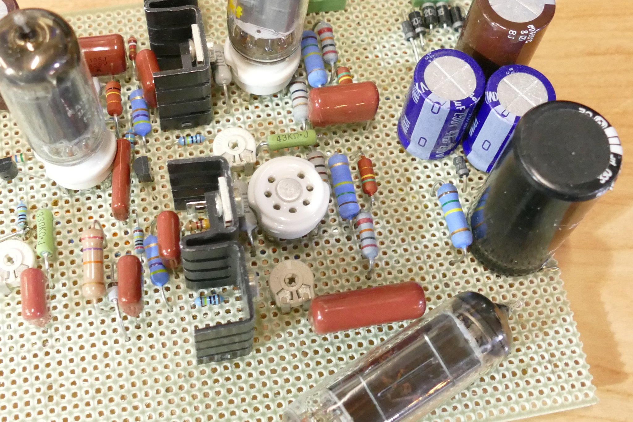

I have three types of 9 pin sockets and two types of 7 pin sockets. I have not used the riveted type 1 sockets in a long time except for "disposable" test boards or perf board prototypes. I learned to test fit a tube before using. The type 2 7 pin sockets that I have are almost too tight. Getting tubes in an out on a hand wired perf board proto results in broken solder connections. I have not tried them in a PCB yet but they would likely be OK.

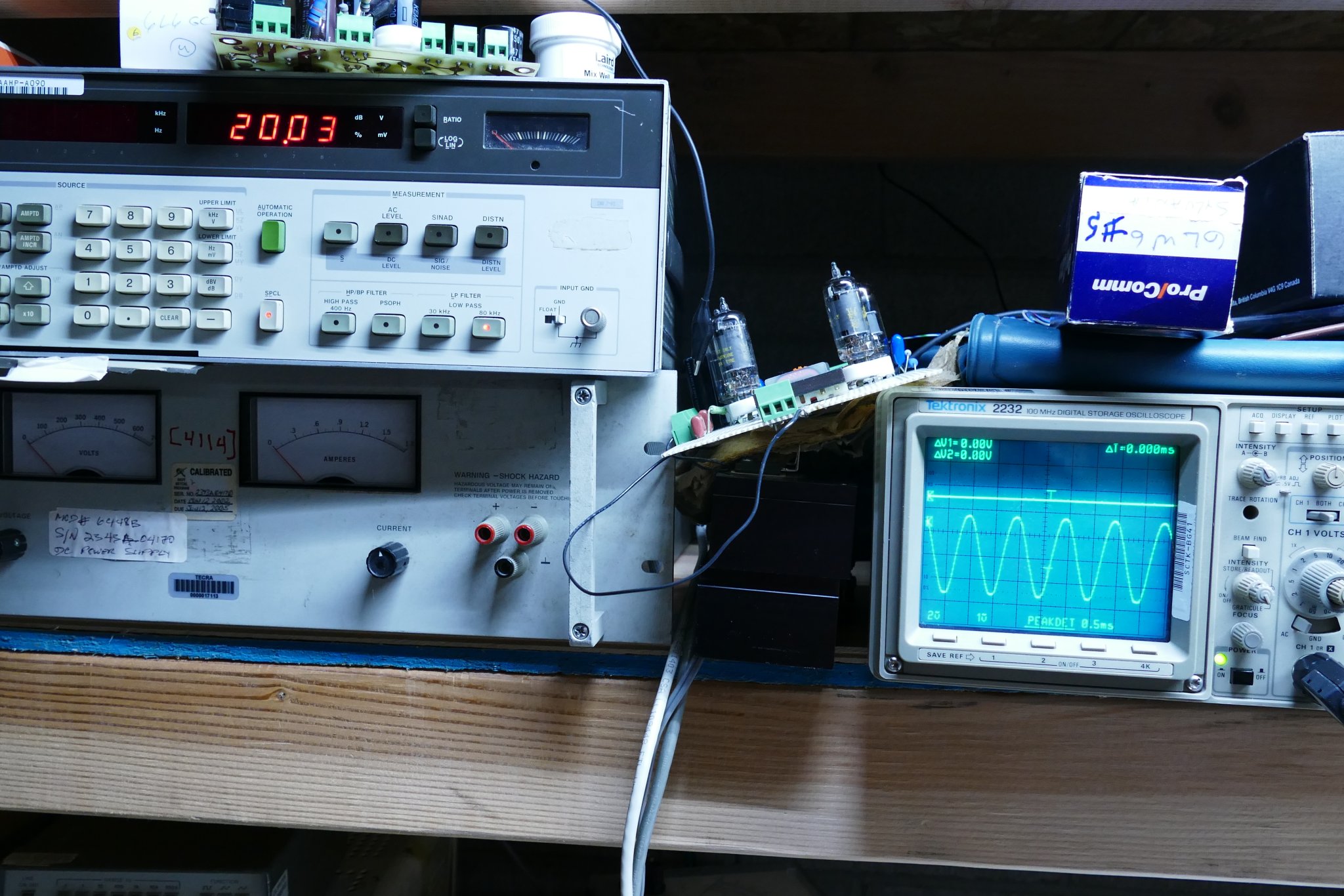

This is a perf board prototype guitar amp that squeezes 20 watts from a pair of 50C5 radio tubes using UNSET technology. The black plastic 7 pin sockets that I got from AES many years ago start to smell funny when you beat the tubes that hard. 50C5's are a 50 volt 6W6 squeezed into a 7 socket. They run very hot and their recommended operating conditions are at 100% of max rated dissipation. There is also a 7.5 watt heater inside the cathode. This board was left running at the 20 watt level overnight. The next morning the power meter said 20.03 watts at 3.76% THD.
