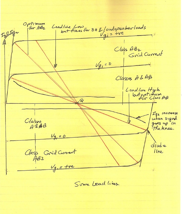

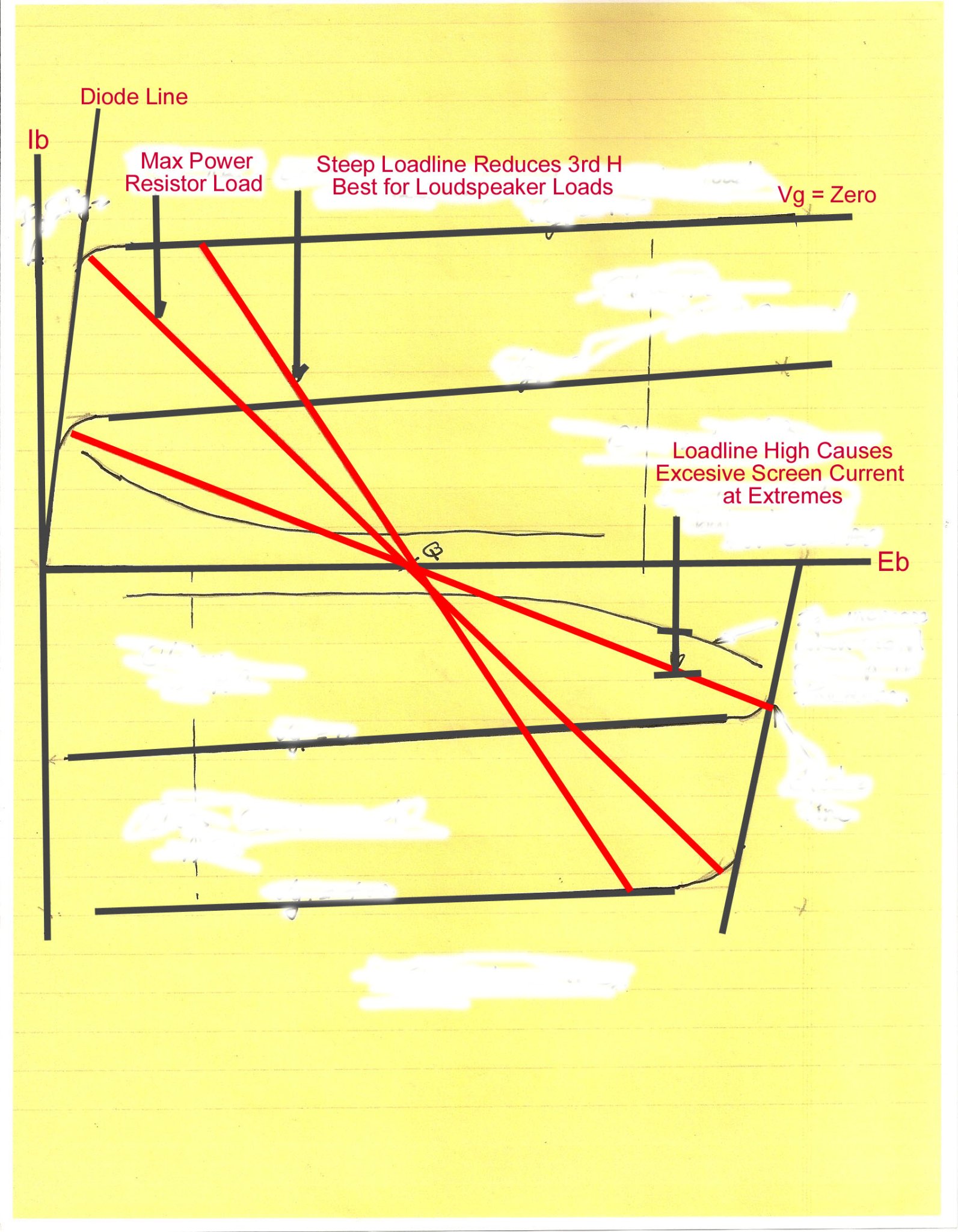

Unlike triodes, critical load for pentodes is important.
Ideally the loadline goes up into the knee of the pentode curve at G1 = Zero. But the location of the knee is dependent on the G2 voltage.
If the load impedance is set too high the loadline will drive the pentode screens into a high dissipation region as the signal increases.
Good design usually sets the loadline to lower impedance than optimum to account for a loudspeaker load with its resonances peaks.
And here are some examples of loadlines from my work.
All of this has a definite effect on the resulting D%. It spite of what some audiophool might claim.
BTW, I use Cookes Variable Constant as a starting point. 😀

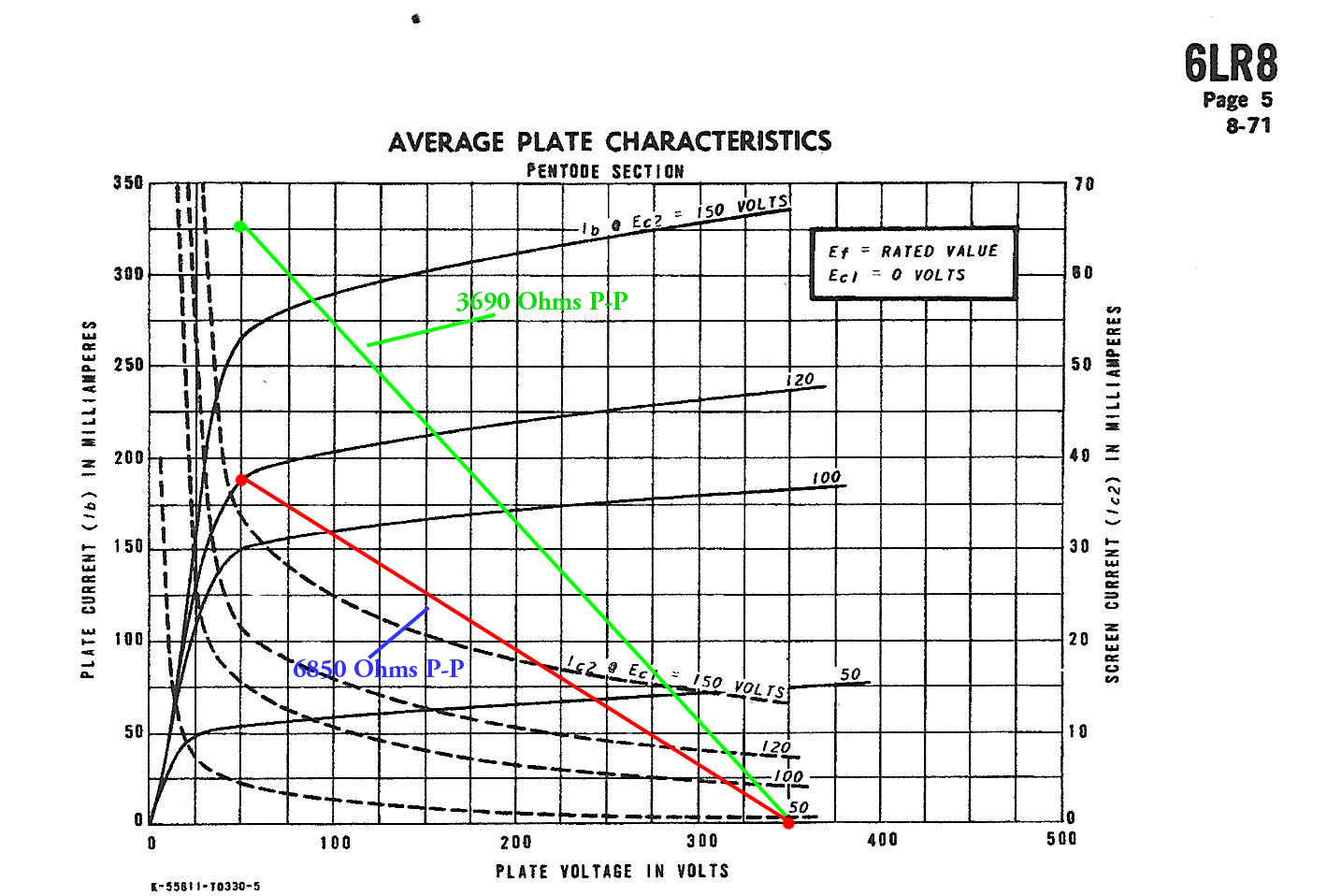

Here is the 6LR8 plate family of curves with G2 as the variable.
There are two loadlines plotted & the results given for the P=P impedance result.
Easy to see why selecting the correct combination of plate & screen voltage is critical. 👍

Well yeah - I just ran the numbers, and 20W (plus a little extra) is still available with the 6k6 transformer at 350V B+ . The screen current is peaking up, but I have efficient speakers currently driven to satisfactory levels by a Class A solid state amp with ~20W output capability. If I go up to 400V B+ and dial down the screen voltage a bit, it looks like I'll have more room to maneuver. Since I'm rolling the voltages on the DC-DC converter, that's not a big issue.
For the 6K6 load the screens need to run with 110-120V thru 1/2W, 1K resistors.

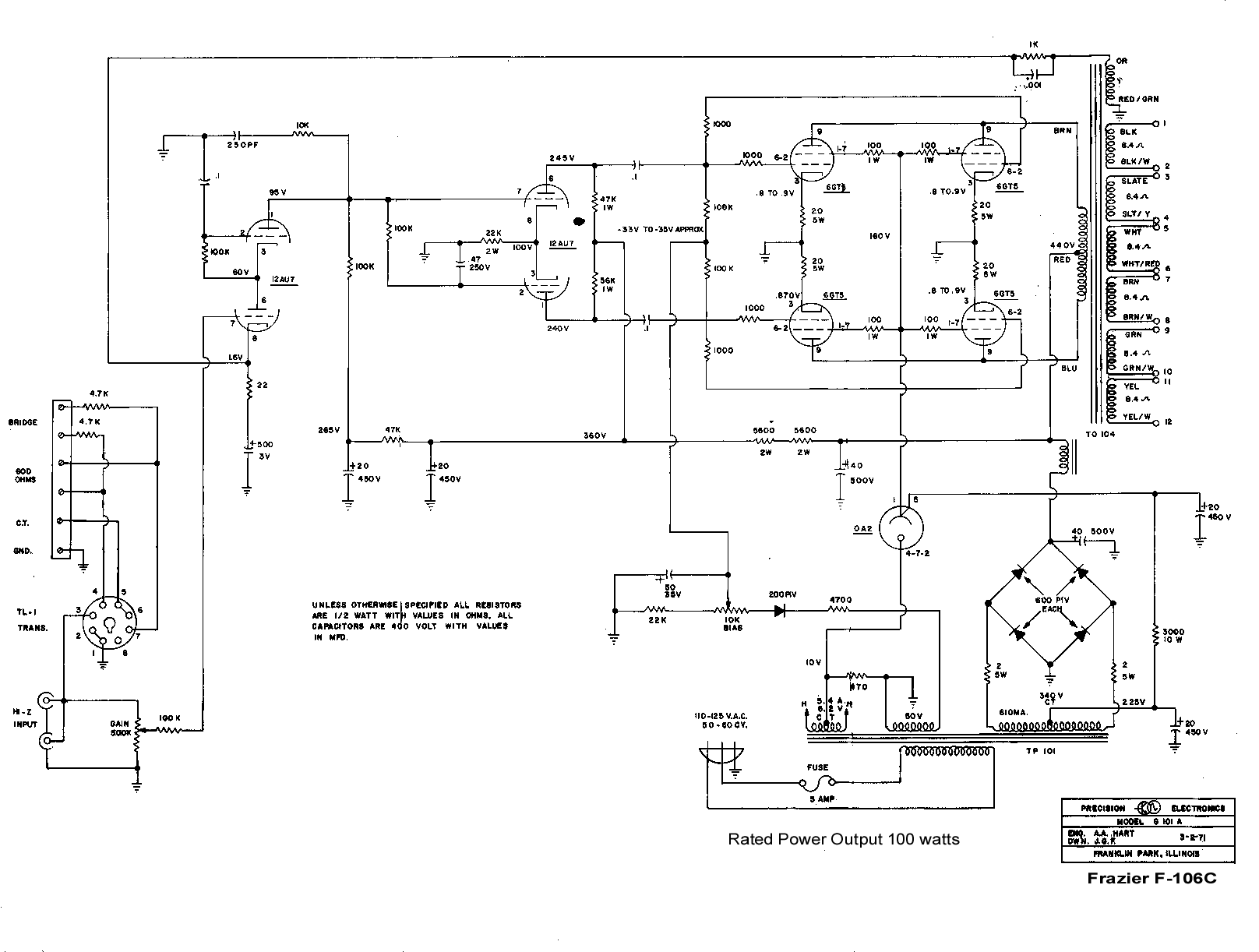

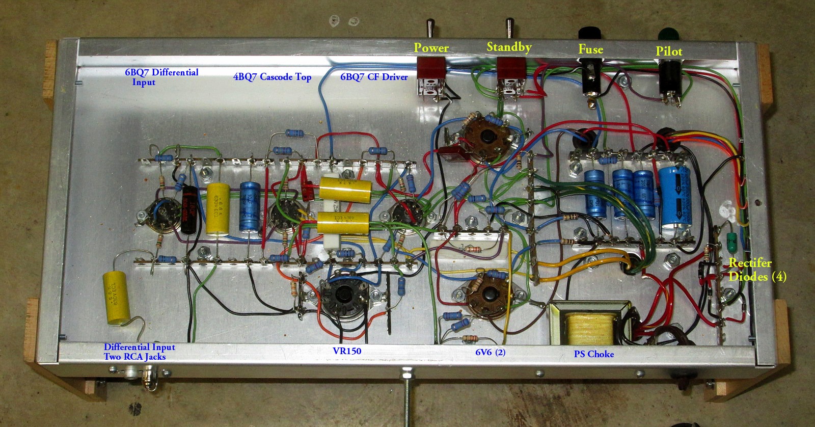

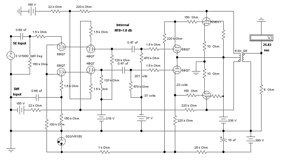

For the curious & lerkers here is a Cascode Differential Front end in a Class AB2 PP 6V6 Amp.cascode differential front end
Complete with a trick NFB connexion to the cascode upper grids. Gebuilt about 20 yrs ago.👍
