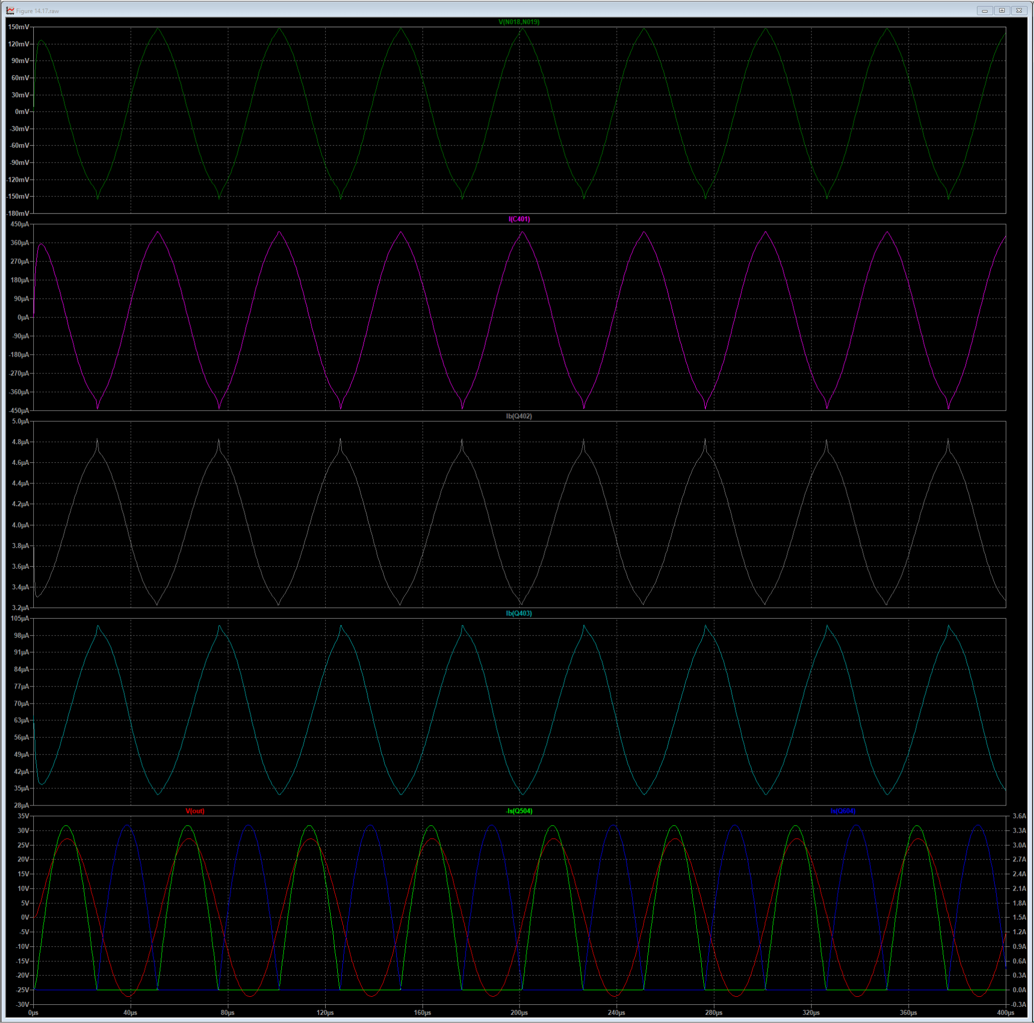

There is one thing though that I don't understand. the current plot of C401 (lower section) have some spikes.
I achieve to remove them if I increase C301/C401 from 10pF to 100pF.

Then I have done all the suggested tests of chapter 23 until the 20kHz distortion test. I get these results:
1kHz

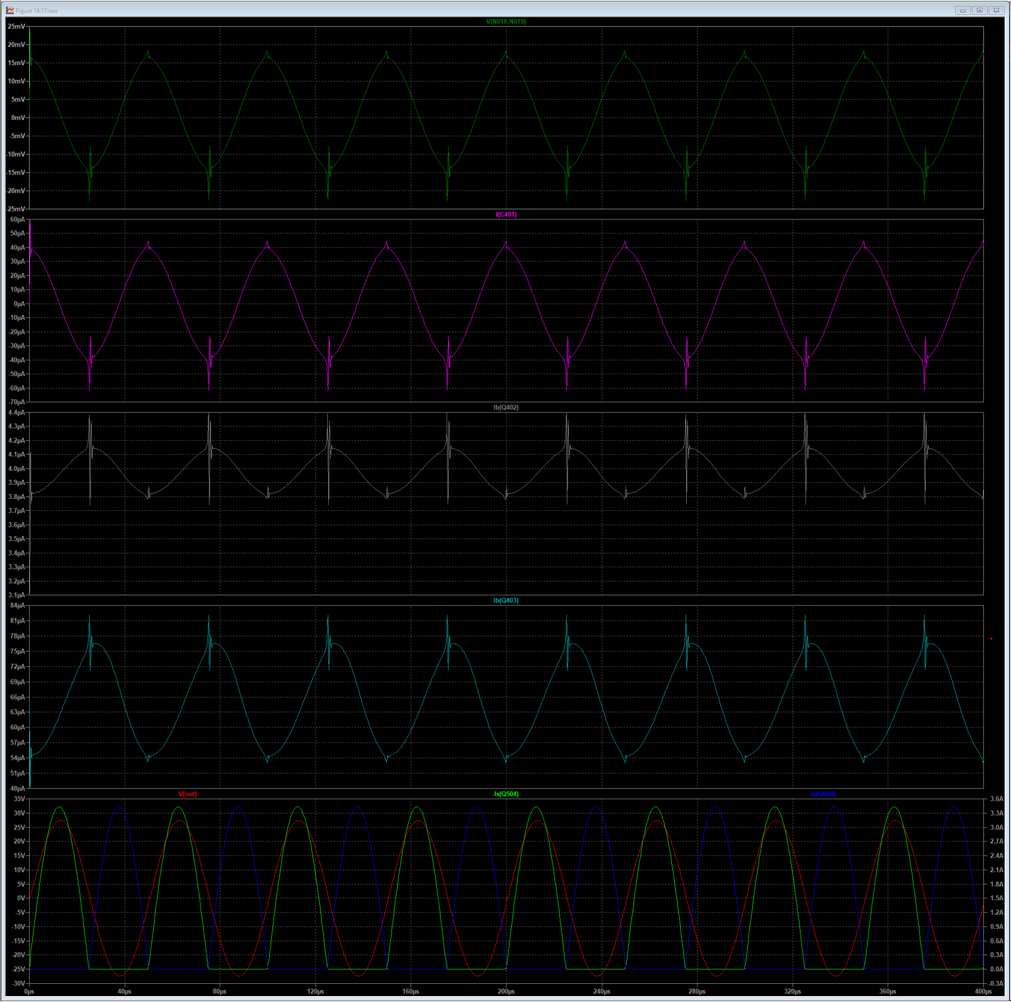

But the distortion at 20 kHz raise to these results:

Those spikes are the feedback reacting to the cross-over by jumping into action. Suppress the spikes and the feedback is doing less correction, hence distortion rises. Reducing those spikes and the distortion probably requires careful attention to the bias-point and switch-off sequence of the outputs and drivers. Lots of people have played with designs that never fully turn-off the drivers and outputs to reduce the transients like this.
Ugly spikes on current (collectors of VAS devices Q303/Q403).
Increase OS idle current (currently 24mA) to get rid of them. I just tried 270mA (Rv2 set to 222), and spikes are almost gone (acceptable at 20kHz).
270mA is of courser too much, but it shows that increasing it will improve the problem. 24mA seems too low....
You may also need to experiment with VAS current - it's only 6mA, kind of lowish....

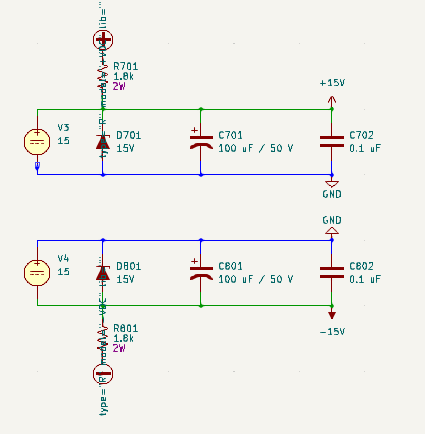

Also, if you are doing 'real' simulation, it's time to replace voltages V4/V5 with real stuff (Zeners, CCS, etc...).
That may work, but it will make your amp much slower. You want it fast, and without spikes 🙂
You need to find an optimum between compensation and currents in VAS and OS.
And then you need to sim it with squares, and then look at FFT plot.
And then make is stable (Phase margin and gain margin).
Good project for long winter evenings 🙂

Actually, I am not yet ready to design the Power Supply. In the real world, I am using my two Rigol DP712 Programmable Power Supply (55 VDC/3A).Also, if you are doing 'real' simulation, it's time to replace voltages V4/V5 with real stuff (Zeners, CCS, etc...).
Once two boards (stereo )will be finished and working, I will proceed with the Power Supply.
I'm not talking about main power supply. In input stage I see two ideal voltage sources, V4 and V5.
These are ideal voltage sources (a 'shortcuts' provided by ltspice), that in your real amp will be replaced by 'real' circuitry.
E.g. +15V voltage source can be done with R+ Zener from the positive rail, and -15V R + Zener from negative rail.
Or from separate, small, regulated PSU.

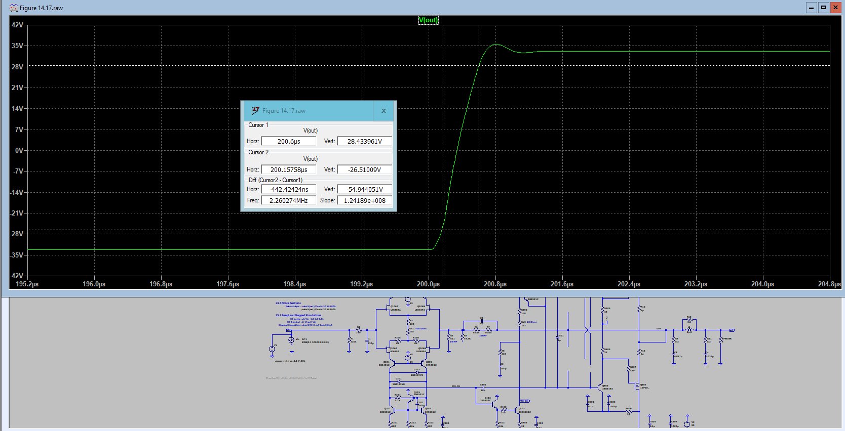

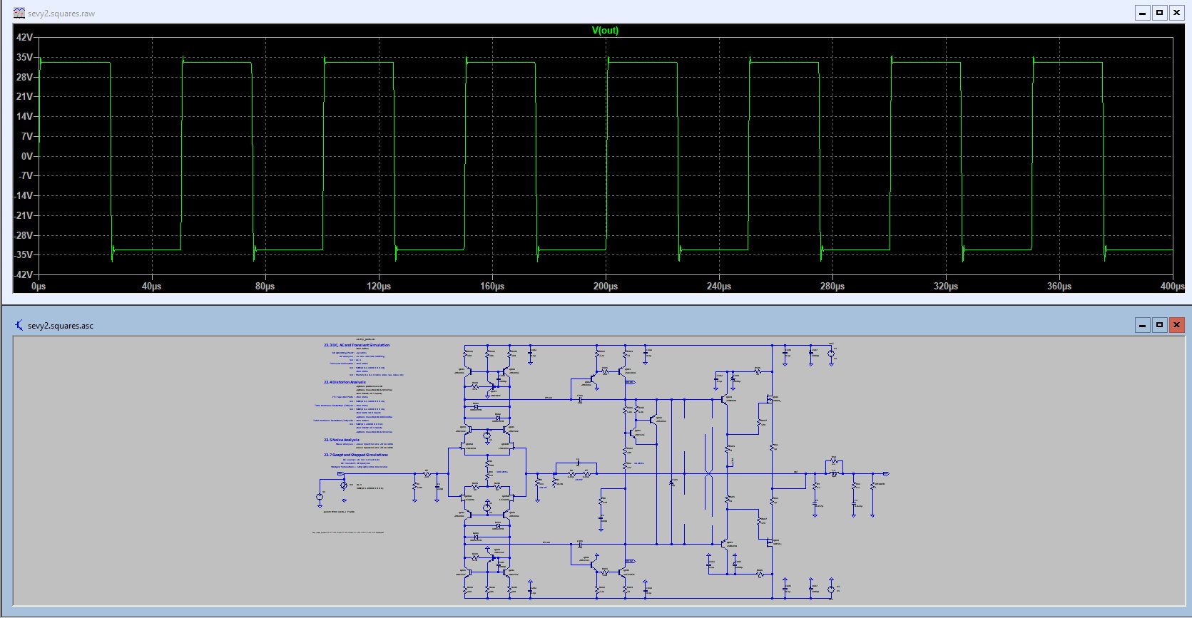

I did the Square-Wave Response test at 50kHz from page 561. The book says "Read the indicated slew-rate in the bottom right portion of the information box"
In my software version, I don't see that slew-rate fields. Is is the result of the "Vert/Horz" field? In my case it would be:
Vert: 9.6628135V
Horz: 1.0015008us
Vert: 9.6628135V
Horz: 1.0015008us
9V/us ??

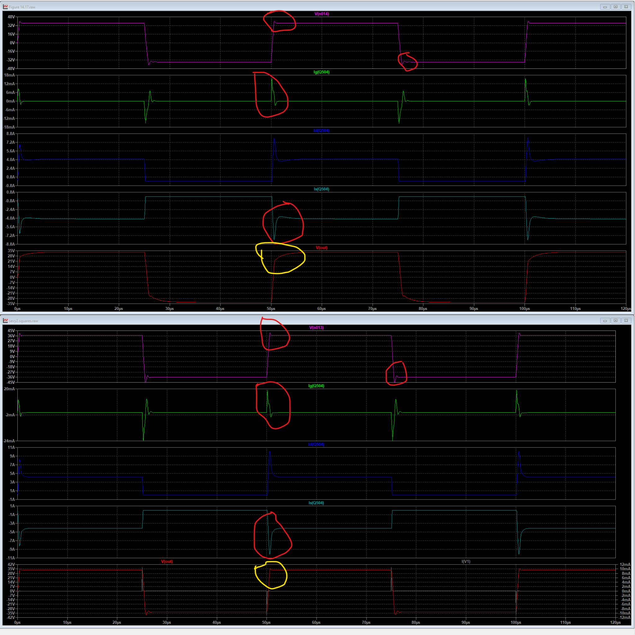

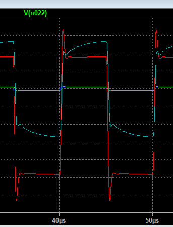

Here is my quick sim of square waves:
Slew rate approx 120 V/us.
These squares need to be fixed, as there is an overshot. Check at 1kHz first.

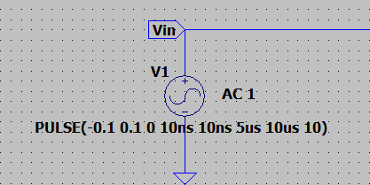

I removed some stuff (unimportant for the actual sim) from the schematic (protection circuits; usually I add them at the end) to avoid clutter.
Please note - the faster the amp (slew rate), the more difficult to make it stable in the actual build.
For a 100W amp, 20V/us is sufficient.

I don't get it...
I putted your drawing and mine side by side and checked everything. I added your parameters of the Vin and the two resistor 1uOhm at the source of each MOSFET.
When I compare the signals, I have exactly the same square pulse on both simulation until I reach the MOSFETs. The signal are the same before R507. They are very close at the gate of each MOSFET. But at the drain and the source, they differ.
Both MOSFETs model come from the same library. But it look's like they doesn't give the same result.
In the capture below, the upper traces come from my asc and the lower traces come from your asc.
Attach you asc file.
I added them so I can easily see what is the OS current. They don't have any other function.
What is idle OS current in your sim? In mine Rv2 is set to 222 Ohm. Idle current is 270mA, most likely that's why my squares look different.
