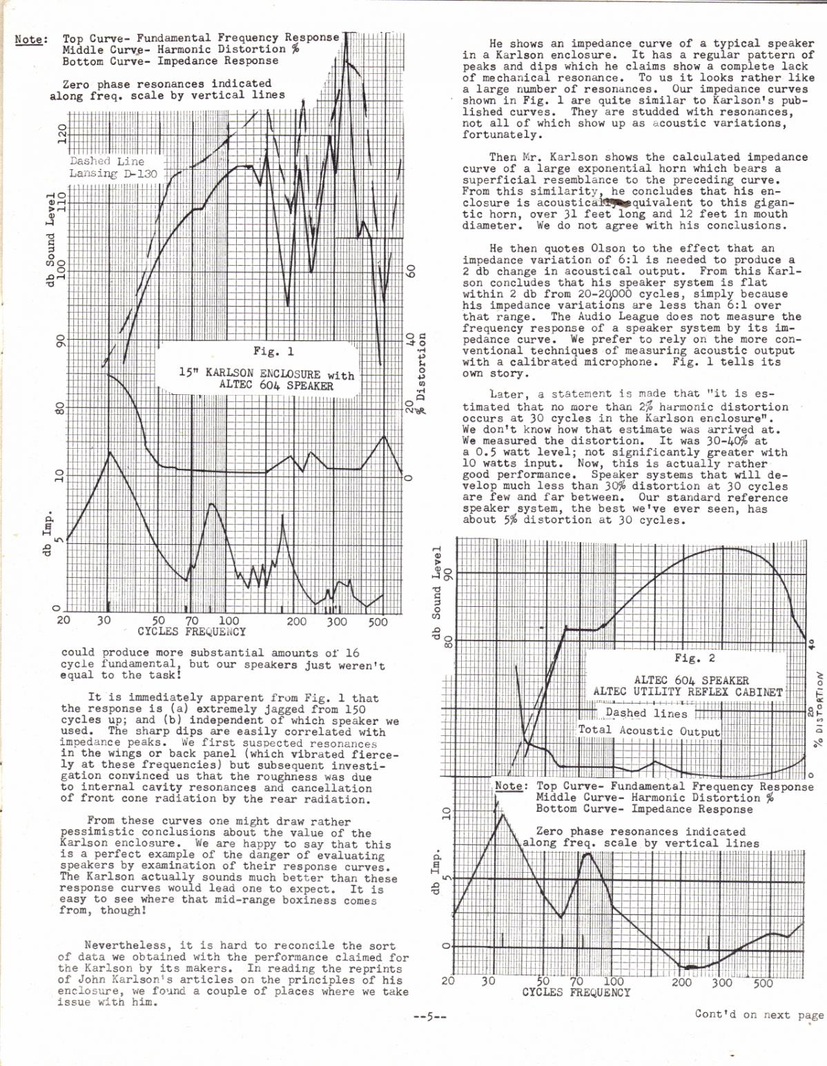

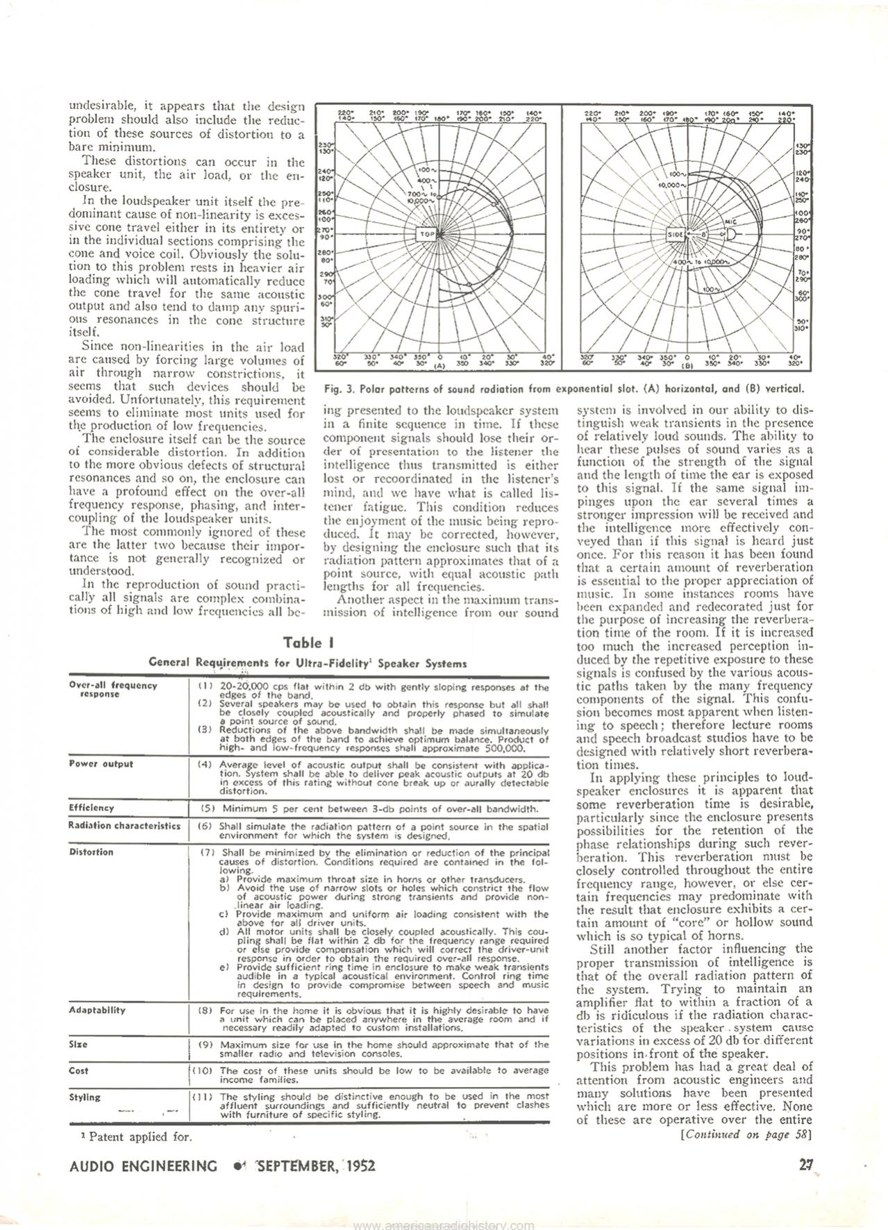

In this part is the 1952 Audio Engineering Magazine article
(Since I cannot go back and edit after 20 minutes to make a good table of contents, I’ll present this bit of history first - then plans in the next segment for the “heritage” lineup of Karlson Ultra-Fidelity models. - Then, hopefully links for the other Ks including GregB's Karlsonator series, and many ongoing threads by XRK971)

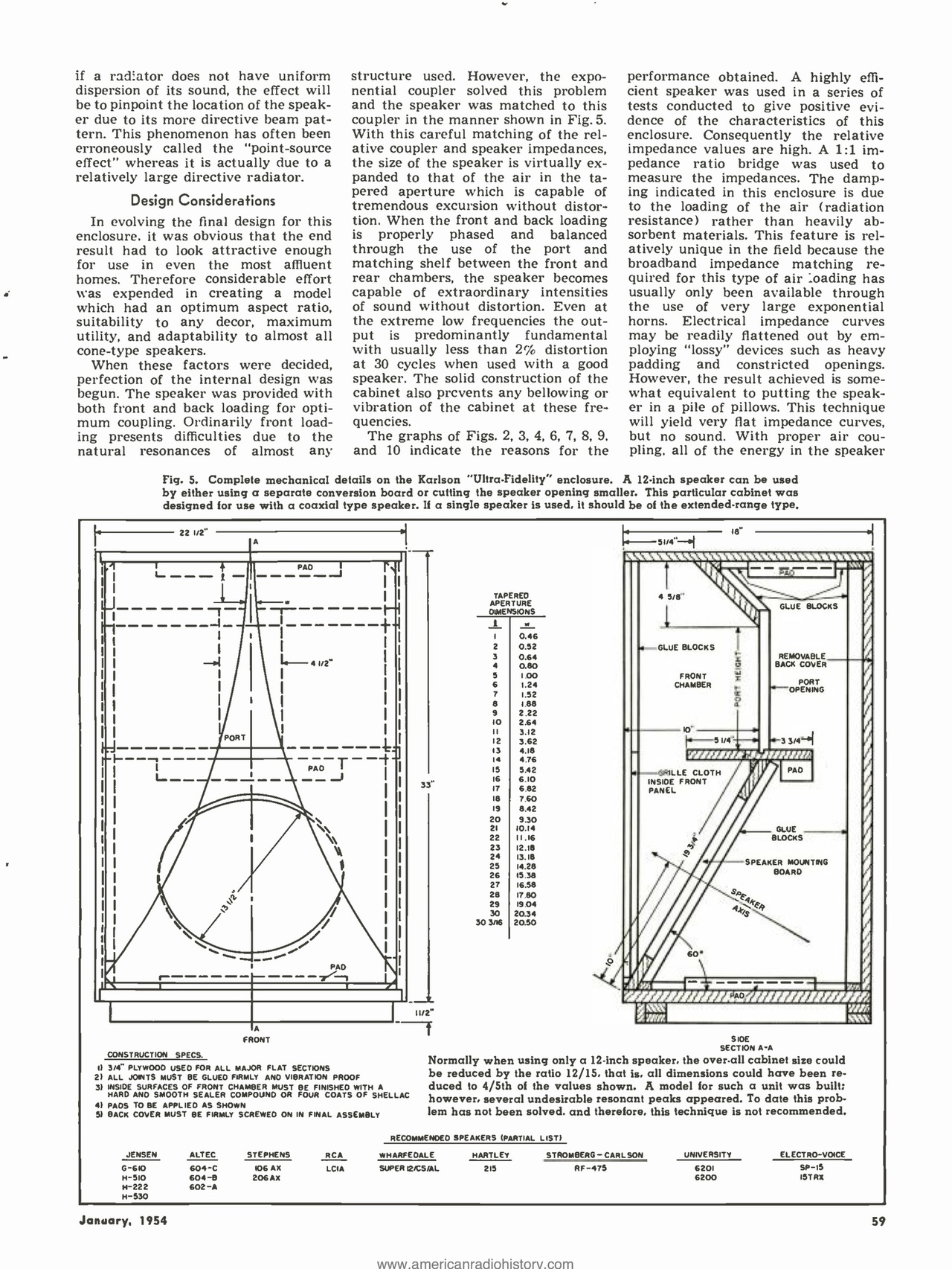

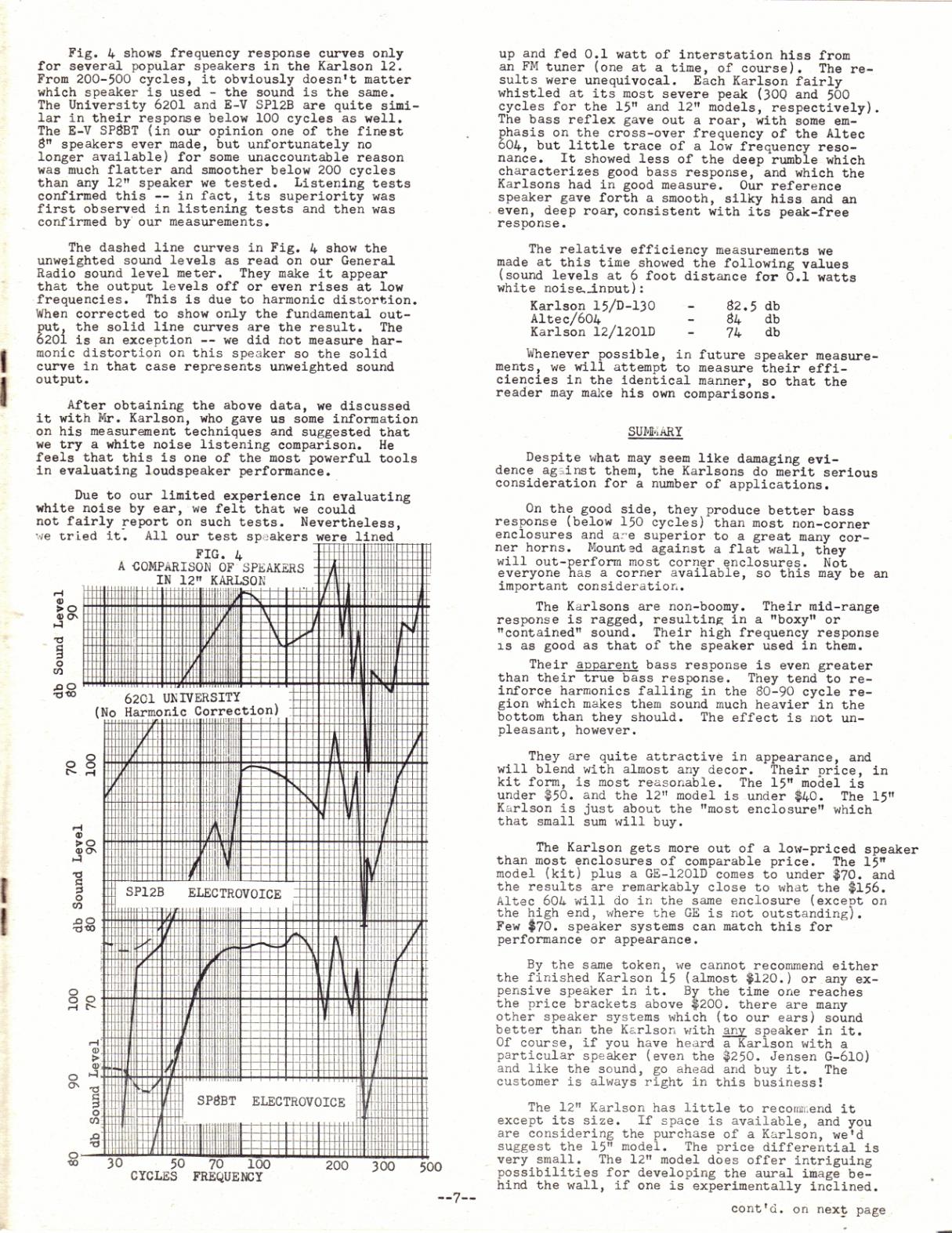

The Ultra Fidelity Heritage Lineup - 1952 introduction of 15K aka "K15" w. plan
As previously discussed, the 15 inch driver Karlson enclosure made its debut in the fall of 1952 at the pretigous HiFi Fair hosted at The Hotel New Yorker.
In the January 1954 issue of Radio and Television News, a second article was published with full dimensional details on how to build K15. The only change to K15 from that time on was narrowing of port width and shelf gaps, published in June of 1956.

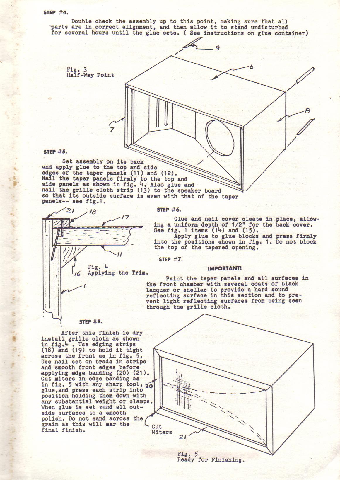

K15 should be braced to minimize cabinet "talk". Dowel struts from the front of the shelf to the wings works very well and likewise, a center strut from the rear shelf edge to the rear panel. Also, two on edge strips of plywood on the back panel works well to reduce flex as the lowpass shelf gap can put a lot of pressure on that panel.
It was another two years until the Karlson Twelve was introduced. In this 1954 article, John Karlson warns against scaling K15 by 0.8X, in practice
that works pretty well although the front shelf tends to deflect some highs from getting into the the upper part of the front chamber.
Reactions: 1 user

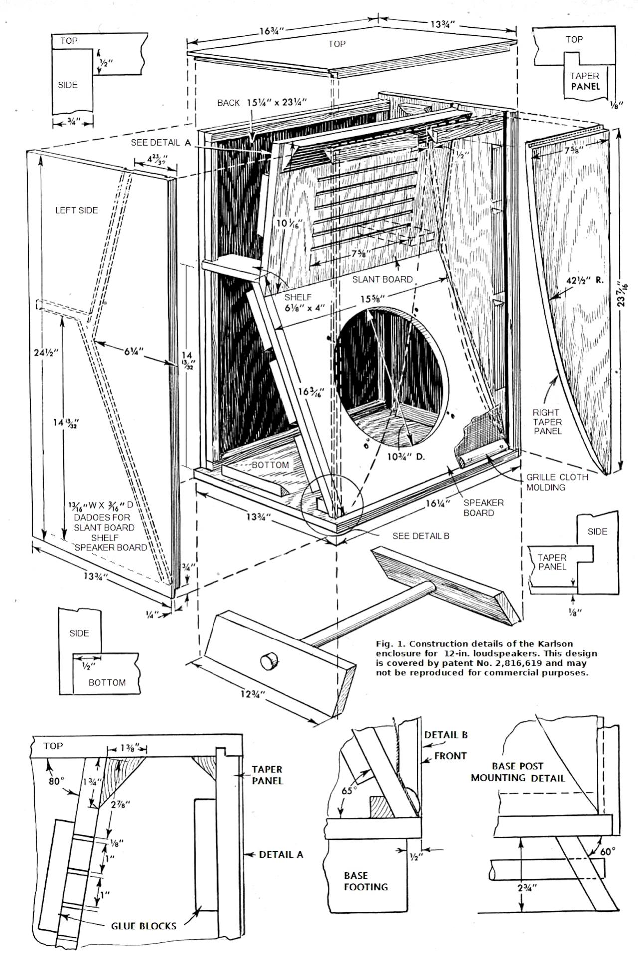

Ultra Fidelity in a much smaller package - The Karlson Twelve introduced in 1954
It was fall 1954, and introduction at the Hi Fi show of the little Karlson Twelve. At 3.3 cubic feet external bulk vs 7.3 for K15, this new "Karlsonette" presented a means for the public to try the Karlson concept with 12 inch fullrange and coaxial plus adapter boards were sold for 10 inch and 8 inch drivers.
This first K12 had a reversible port panel, and a 3 position movable bar adjacent to its rear lowpass shelf to allow some tweaking of impedance for the different drivers of its day.
Sometime in 1956, (with details published in the July 1958 issue of Popular Mechanics, K12 while retaining the same external dimensions, underwent a few internal changes including a distributive 6 0 slit port panel which was canted 10 degrees forwards and a two board "shelf" arrangement which double to brace the back panel. Many speakers sold at that time had rather high qts and it was common among many makes to see semi resistive porting.
(Note, Karlson never went back to the front shelf after K15 in the regular lineup. It probably was employed with the 18 inch Karlson console.)

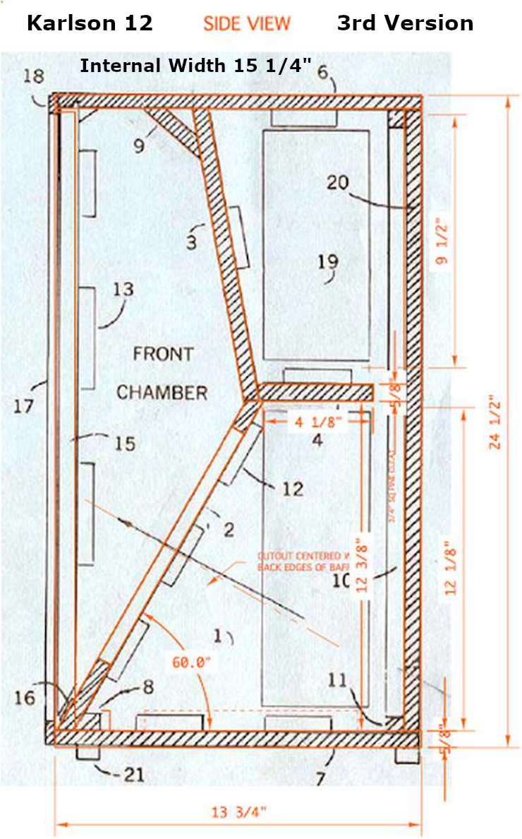

Sometime in the 1960's a "3rd K12" appeared, still the same size but in kit version, could be ordered with a blank port panel to custom port - or run with sealed back chamber. From the factory it had a 12 hole distributed port. (I've also seen factory K12 with 3 and 5 slit vents.)

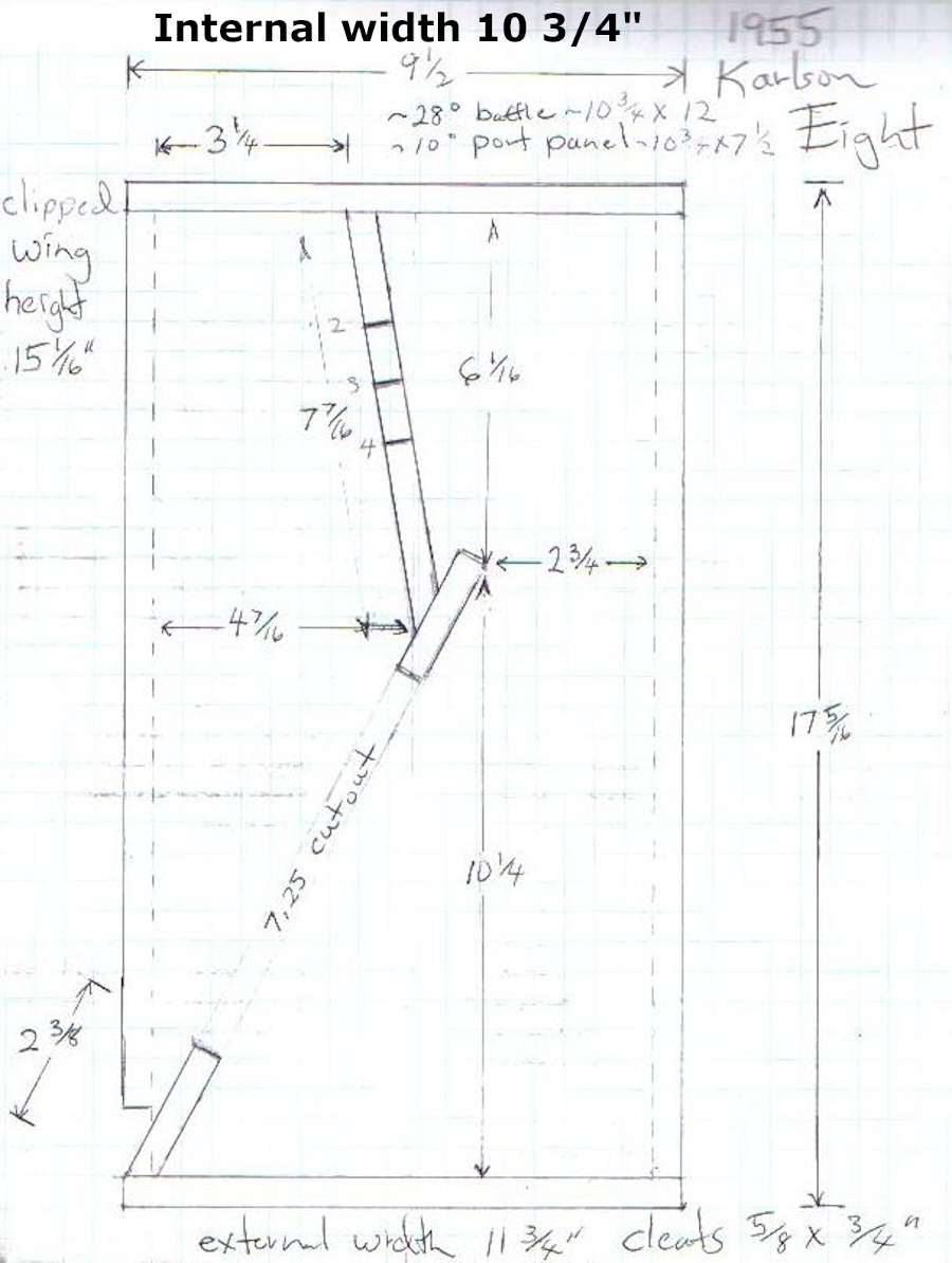

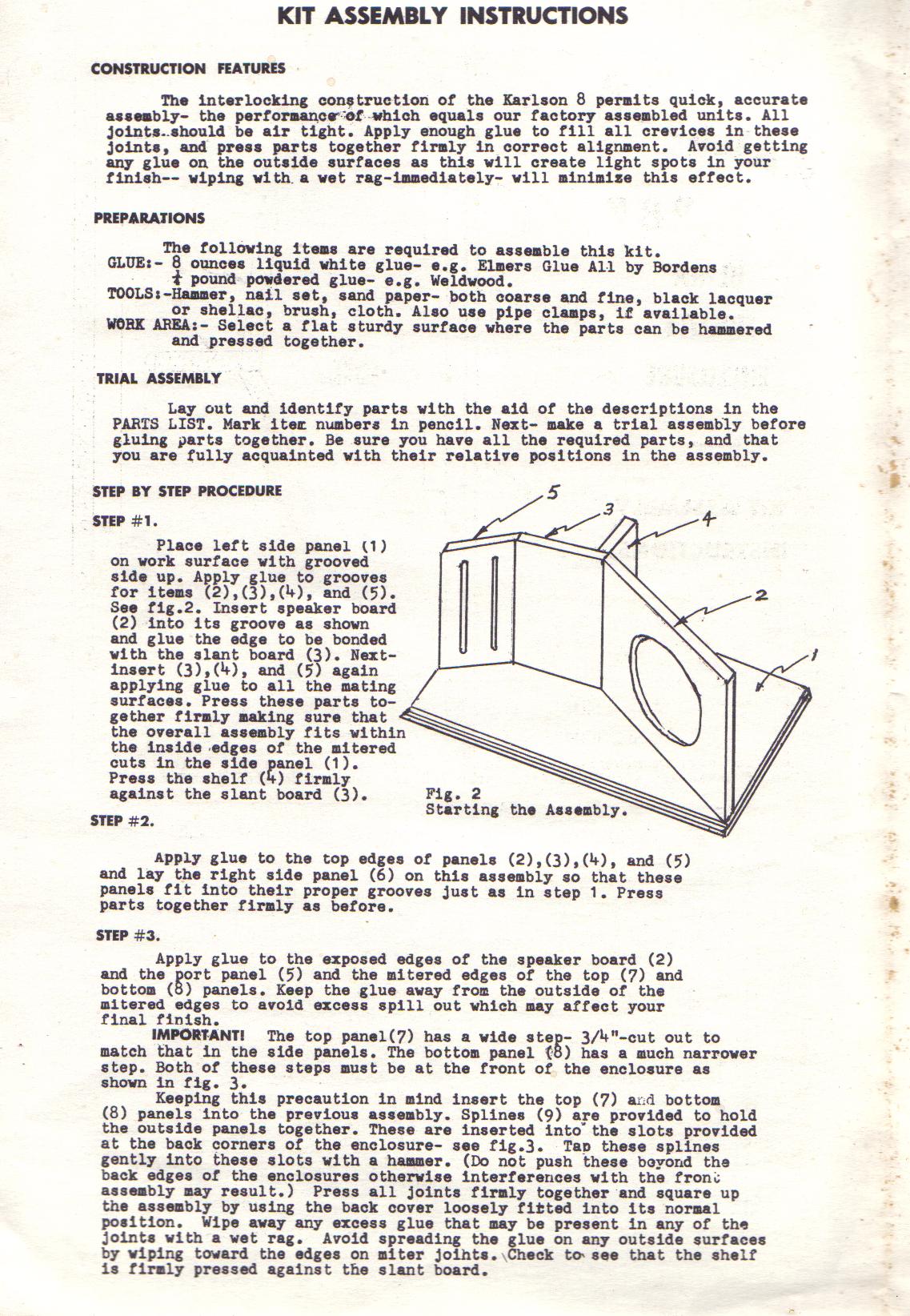

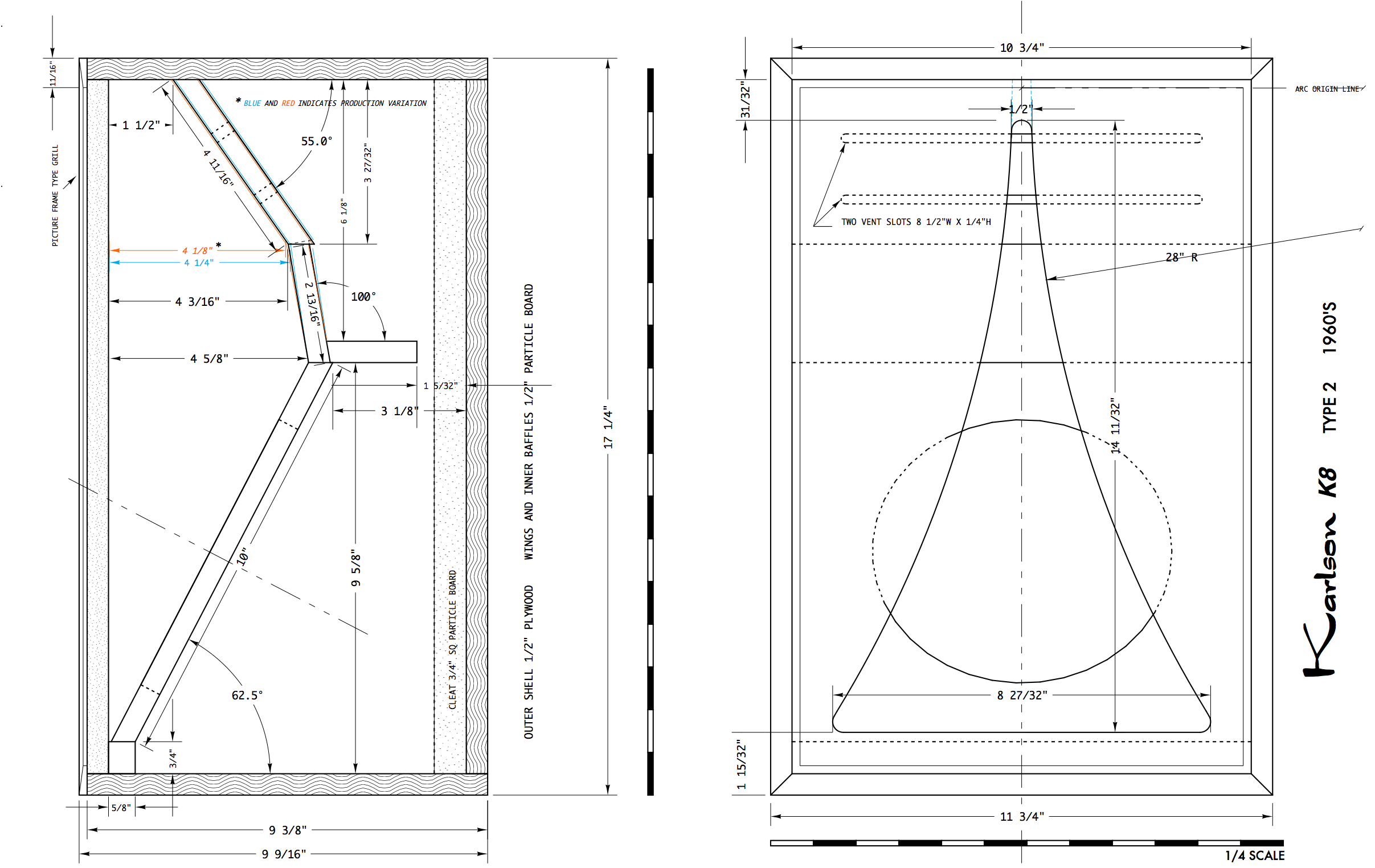

1955 - The introduction of the "Karlson 8"

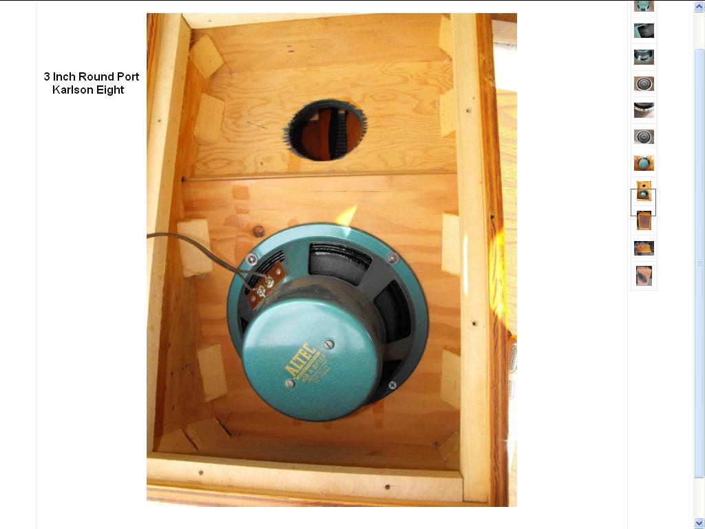

With decorative trim, the Karlson 8 aka "K8" was only 17.25" high, by 10.75" wide by 10" deep, nominal small signal tuning around 95Hz. Of course with some drivers it would work better with the distributive vent slit sealed or damped for ~ "aperiodic" results.
The first K8 had a 10 degree slant reflector port board. The 1960's model a two panel reflector. One version of the earlier model has been seen with a 3 inch round hole vent.

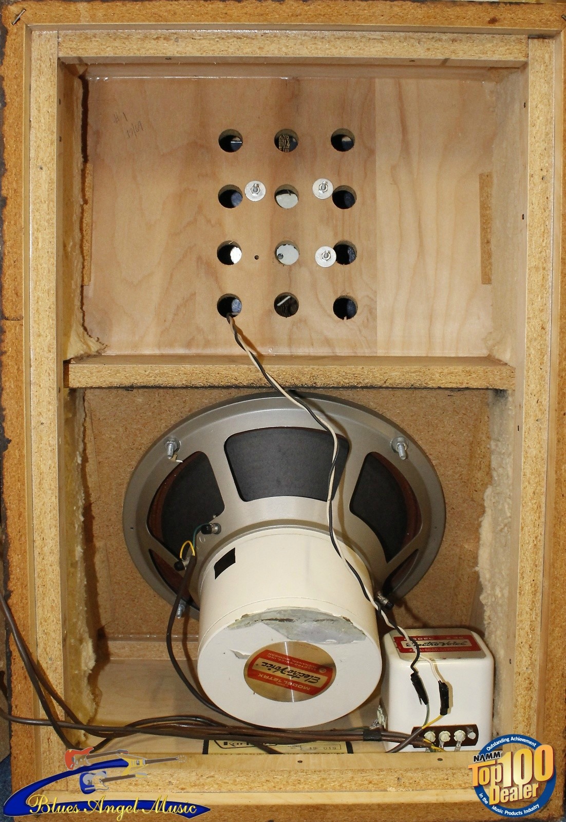

K8 - continued

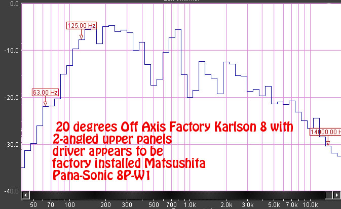

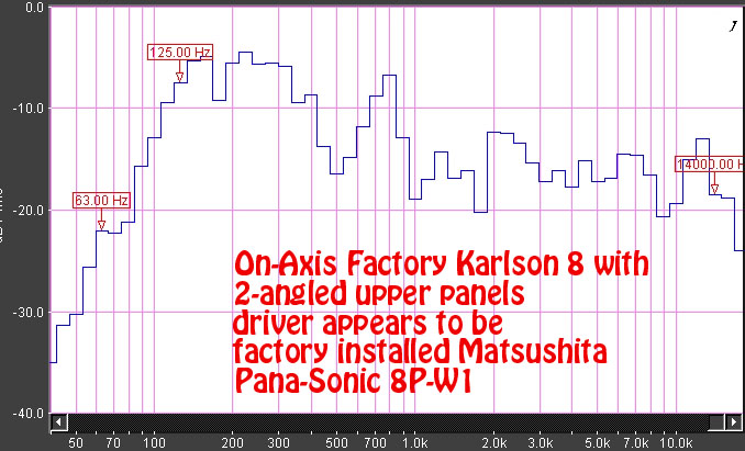

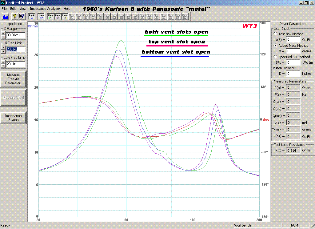

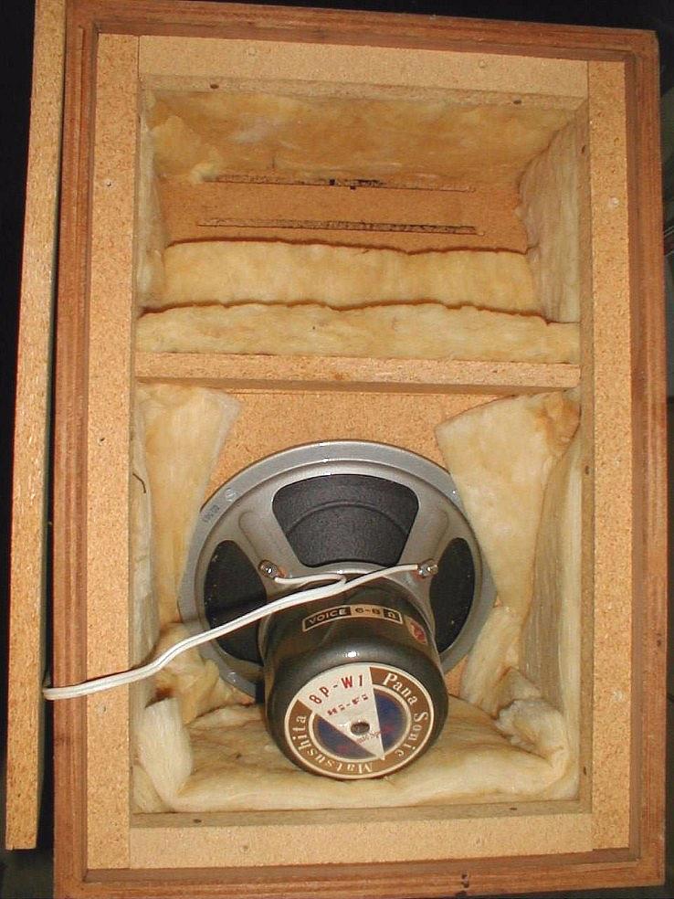

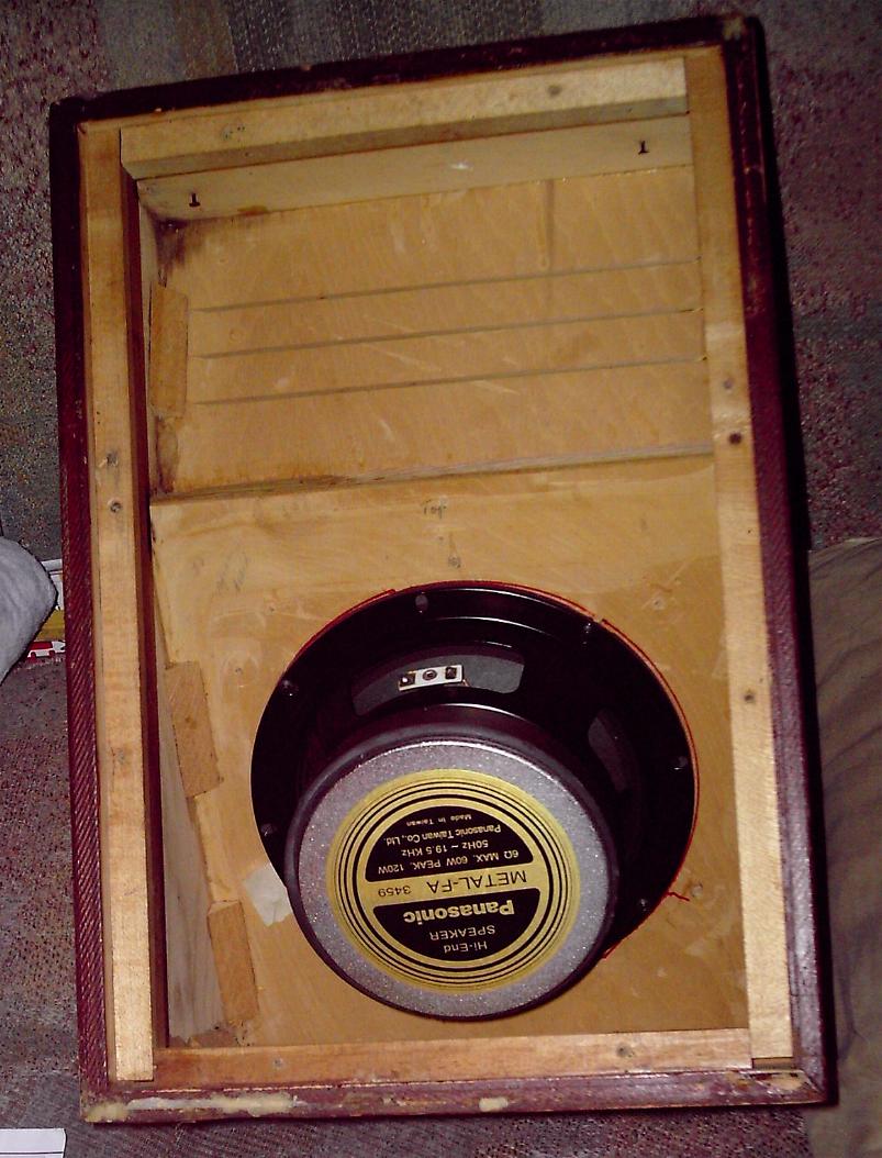

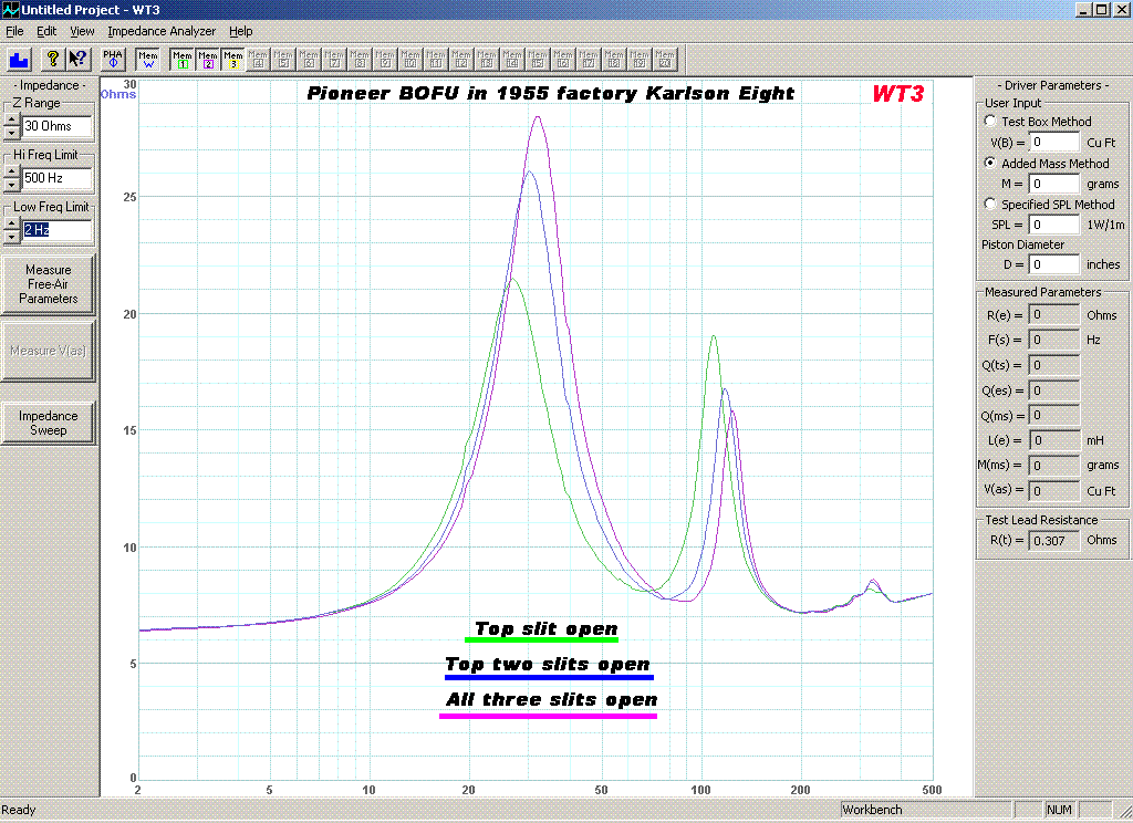

one very popular full range speaker of the Karlson 8's time was the Pana-Sonic 8P-W1 - unfortunately my sample was pretty much dead on arrival from Ebay.
Note the damping placement. This K8 came with fiberglass, Kim-sul paper insulation was common too in those days and nice to work with vs fiberglass.
For those not familiar here's a nice picture of that Pana-Sonic full range speaker with its ball diffusor
http://glowinthedarkaudio.com/national-panasonic-8P-W1/national-panasonic-8P-W1-2.jpg
Reactions: 1 user

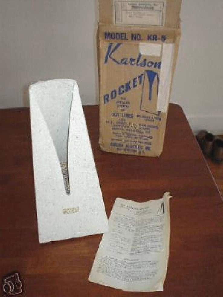

The KR5 Rocket Plus A Nice 1960's Karlson brochure showing the "K18" console
The little Rocket (1957) and Karlson's K18 console sometime in the 1960's appear to be the last of the Ultra -Fidelity entries before the entry of the X15 system (announced fall of 1965)
KR5 was covered more extensively in the following thread: NASA consultant John Karlson, his little KR5 "Rocket" and Rise of the Klam projectors
This Karlson brochure shows the 18 inch cabinet which laid the slot on its side and featured an upper chamber for midrange and treble drivers /and or horns.

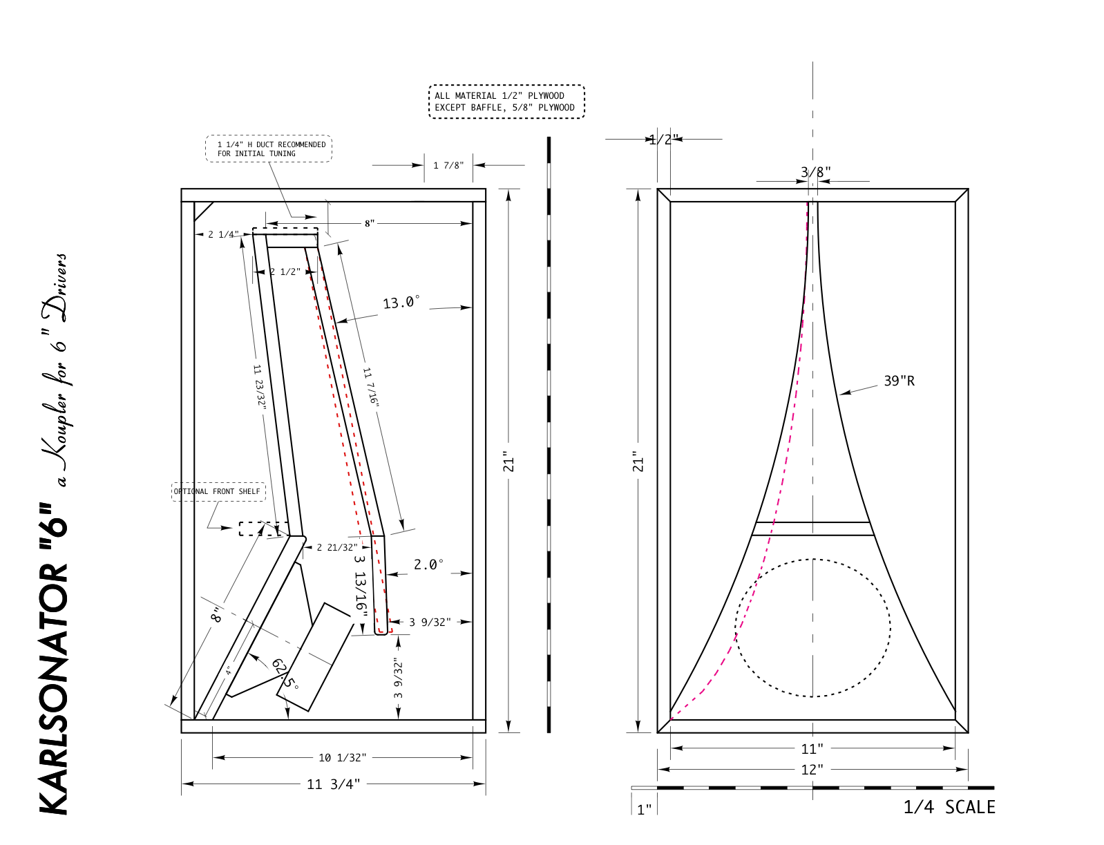

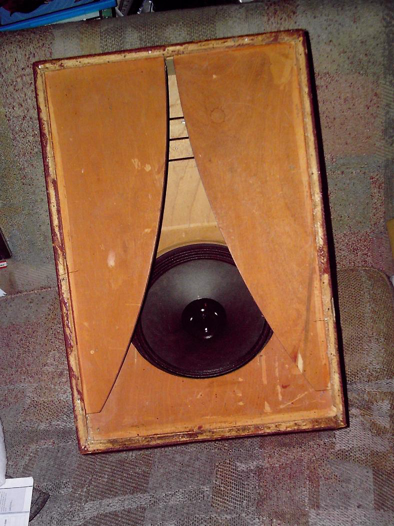

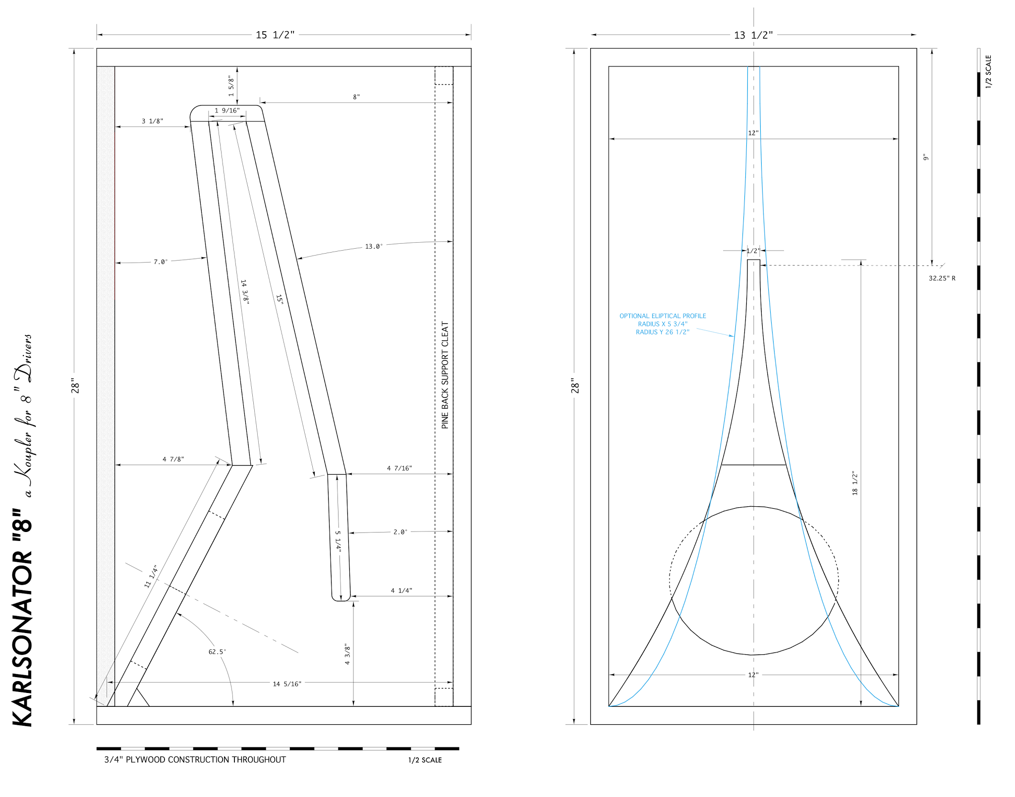

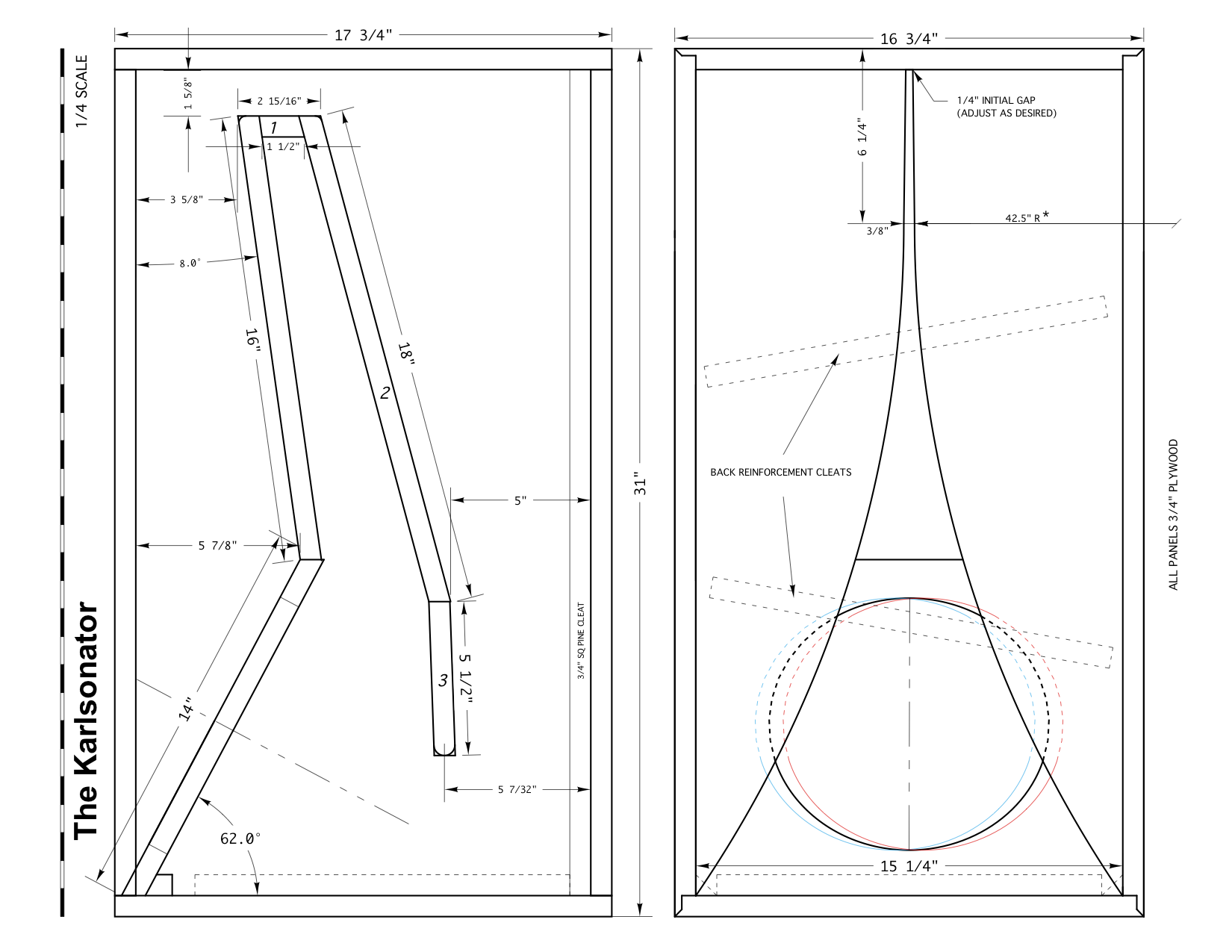

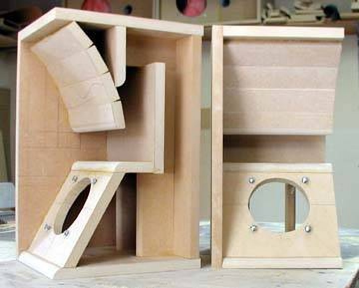

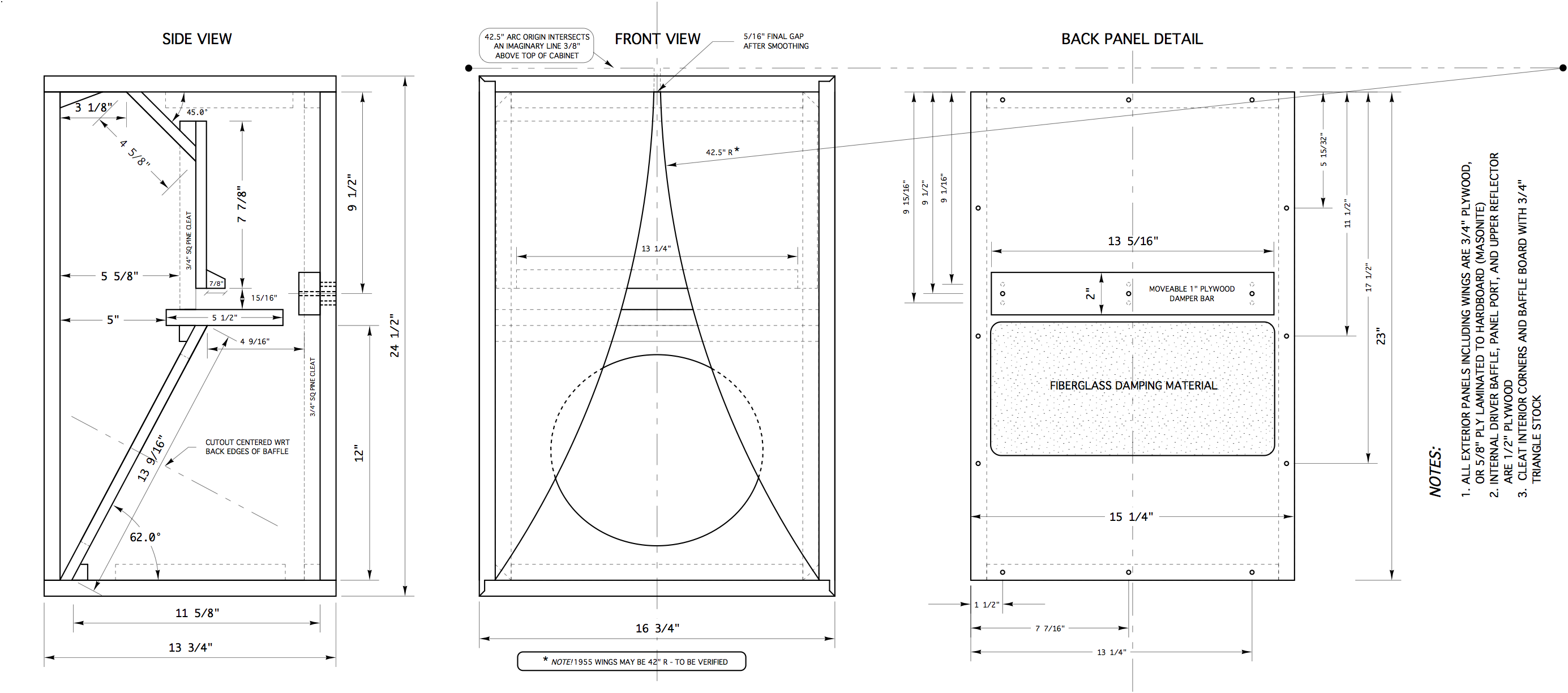

Fast forwarding to the current generation of Karlsonator and other K-variant
Some years ago, long time Karlson participant, luthier, and musician, GregB came up with a useful hybrid whose name is "Karlsonator". For a given size they are tuned quite a bit lower than the heritage Karlson speakers.
Greg drafted plans for 3 sizes originally: 12 inch driver, 8 inch driver, and 6 inch driver. Those are included here plus a plan for Mark Audio's CHR70 driver,
The prolific and gifted XRK971 created a whole new crop of this type with his scalable Akabak script.
Also, XRK971 came up with new alignments based on bandpass simulation named "XKi", and a Z-baffle KaZba arrangement for subwoofers,
THESE are XRK971's Current K-related threads:
Mini Karlsonator (0.53X) with Dual TC9FD's
The XKi:
XKi - X's ab initio Karlson 6th Order Bandpass
The KaZBa:
Rockin' the KaZba Dipole (K aperture Z-baffle Dipole)
A Speaker that Kicks Butt in Large Spaces
X looks at Karlson's slotted pipe tweeter

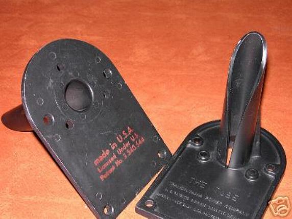

Later X15 cabinets employed the "K-tube" tweeter
The first X15 cabinets had a wood mini klam driven by a 3 inch cone speaker. Subsequent X15 used a slotted pipe driven by a one inch format compression driver.
The most famous K-tube is the product from Walter Alan Zintz's "Transylvania Power Company" called "THE TUBE"
These tubes produce a symmetrical horizontal pattern and asymmetric vertical pattern.
(Wolf von Langa bragged about the tube too.)
Karlson had an open end waveguide patent, and a jet nozzle /mufller patent.

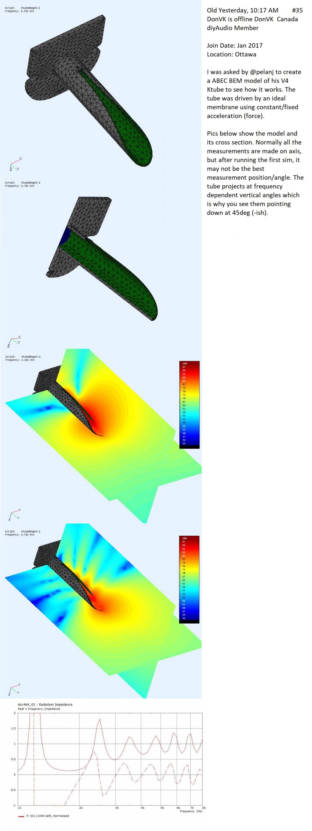

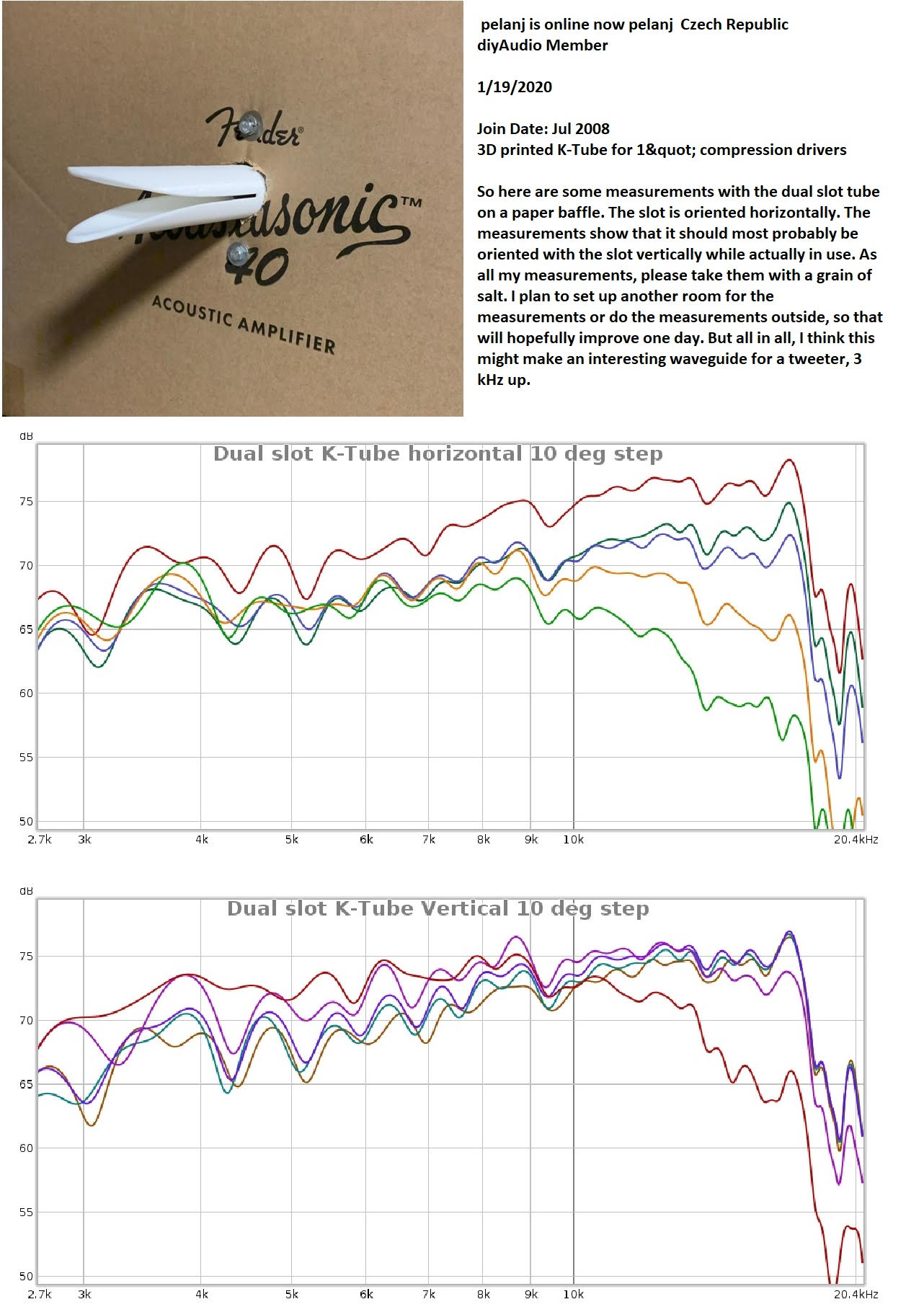

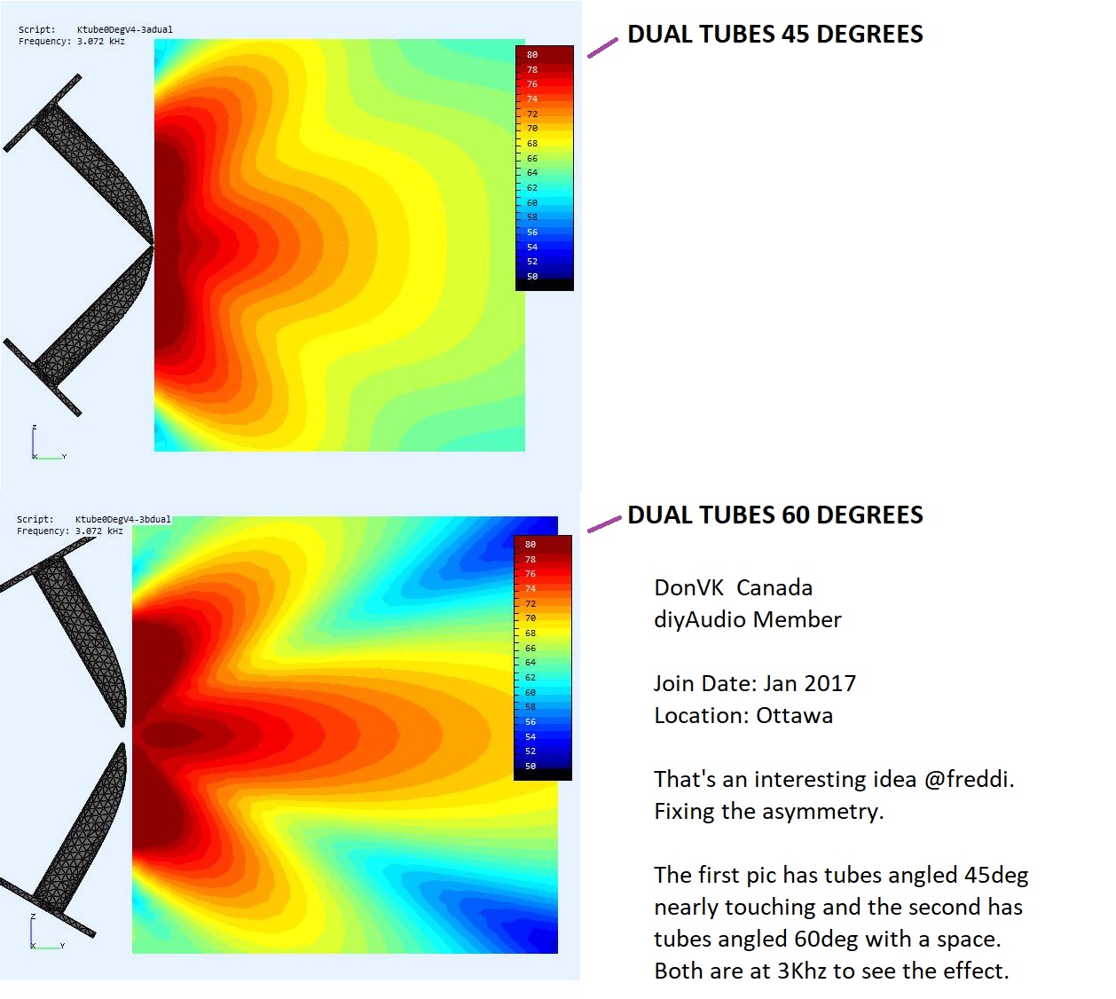

Lately through the work of Moray James with paper tubes and Pelanj with printed tubes that simulations by DonVK show the double slotted tube is also of value for hi-fi.
a few pictures

I recall an experimental rocket type enclosure for a 6x9 inch speaker that John built.
6x9 were a good choice in "those days" as they were becoming in demand as car radio speakers,
especially for the then new concept of providing front and rear deck speakers.
The 6x9 fit well into the allotted size and they had to take a bit of power.
The basic dimensions as I recall were a cross section to fit a 6x9 inch speaker,
straight sides, a back chamber maybe 3 to 4 inches deep, a front chamber perhaps 12 inches high.
The slot started at say 1/2 inch, and opened to the full width of the 9 inch dimension,
and the top was fully open. Again, the sides were parallel, and perhaps the back
was 3 inches higher than the front, i.e.sloping sides.
I have attached a sketch and a repeat of the sketch of the stereo enclosure
I build in the MIT hobby shop in 1961.
I do not know what happened to the 6x9 enclosure, or where it was used.

The first critical review - "The Audio League Report" October 1955 by Julian Hirsch
In many folks eyes, the late Julian Hirsch set the gold standard for objective testing of audio equipment.
This is the issue of The Audio League Report which dealt with Karlson's K15 and the relatively new twelve inch model.
