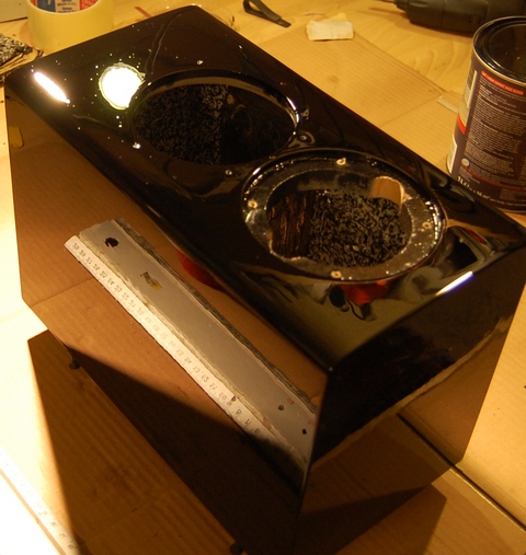

Guys, I found all papers on ebay, so I will give it a go. In parallel, I will be enhancing my lazy man's gloss technique.
Yesterday, I spray painted one speaker while the other one was rollered before, so that I can compare the two. Roller did a great job in gloss and left no marks. Spray can left some micro orange peel traces which reduced the reflection sharpness. Roller is also more fogiving when it comes to grit. I could probably get away with 600. Spray layer shows every tiny scratch and would require at least 1200 to smooth things up. I just don't understand why is there more dirt in the roller layer... I wonder if it's in the can itself?
Take 2 on lazy man's gloss; hairy roller, but higher quality. Smile is back on my face:cool:
Glowing dots are inevitable dirt particles, but reasonably low amount and size.

Nice.
You must have really rolled a thick coat to fill scratches. Try spraying a little thicker coat from a little farther away. A little drying retarder might help prevent the orange peel on the sprayed finish.
It's really going to hurt when you first hit it with sandpaper to bring it up to a mirror gloss. ;)

Back then, I ended up sanding again and finishing speakers with spray paint. I could not get rid of small particles which were driving me crazy, when applied with either brush or roller.
Now I am building a guitar, and trying to do give a gloss another shot. I have rather cheap factory built Ibanez in black piano gloss finish, and I cannot keep wondering: how the f*** they do it?? I'd have to (sand&paint&dry)*n for months to get close to that finish, and I am sure they just spray it couple of times; or is it that they polish it too?
I gave a brush&can one last go: after diluting the paint with approx 20% thinner, I ran it through a very fine paper filter: 1dl of paint took 1 hour to get through, so you can imagine the filter density. I am sure no particles made it through, and yet, after applying the paint, there they were again. Less, but still there.
So, I just want to know: how the piano/guitar/speaker manufacturers do it?

They don't just spray it a couple of times, that's for sure and yes, they polish it.
It might be airborne dust that is settling in your paint job. Use a faster drying paint and apply in a dust free zone.
Consider dipping for a small item like a guitar body - it can be smoother than spraying.
When paint is sprayed after being filtered as fine as you have, it's not the paint that's causing the "particles".
Its the dust that's settling during and after spraying. Try building a temporary spray booth out of NEW el cheapo plastic drop cloths with a moist tarp on the floor. When I spray I wear a Tyvek coveralls suit and latex gloves along with a spray hood.
I still get dust nibs that have to be buffed out. :) That's just how it is.
