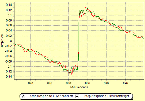

ShinOBIWAN,
Considering that your thumbnail was an actual measurement from the listening position it was quite impressive. But there seems to be methodical differences that makes this feature less relevant in Audiolense. A group delay correction handles this part pretty well already.
To the free lunch I was questioning;
Provided that the interchannel matching is done with wise moderation, it will not always look as good as in the sample you showed us. And by wise moderation I mean not correcting @ 10 kHz for 20 ms for instance. Many setups will require high frequency correction with very long durations to achieve the kind of matching you showed us and then I think it's better to settle for less.
Luckily for us, the hearing is also frequency dependant to a certain extent. The midrange is suspect no 1 when the image is disturbed in spite of a good frequency balance and a properly timed first arrival.
But if the channel balance is much off, I would expect that a substantial amount of time domain correction is still required to get the kind of result you posted. And then I wonder: Why settle for similarity when both the step responses can be made much better?

I was rather surprised to find out that the step respone you showed was from a corrected speaker. By the look of the response I assumed that you had simply done an interchannel balancing on an uncorrected measurement.
An IR view may tell a more precise story, but the step response looks more minimum phase than linear to me. Are you not correcting any of the time domain smearing fro the room boundaries? Are you doing the DEQX thing? (Full *anechoic* correction paired with frequency correction in the sweet spot)
I can understand why interchannel balancing can make a difference with such a correction.
That particular measurement wasn't made by me nor is it from my system. Its one Uli performed whilst setting up Acourate for one of his friends.
You'd have to ask him for specifics in that particular case. I used it as an illustrative example.
As already mentioned I can't comment on the example but in my own case I used the traditional Acourate method of driver correction or anechoic correction as you explain it and then measurement from listening position. Afterward the linearised crossover filters and the uncorrected room measurements where sent to Uli where they were worked on to achieve what we're discussing here.

BerntR said:It is difficult to answer that question. You must tell me what an Acourate filter is first.
You can choose to have Acourate generates min phase and linear phase double floating point filters.
I think you set the bar pretty high by this one:
Then came the channel matching "test" as a potential proof of evidence.
And now this:
I really didn't expect to find out that the designer was the core part of the solution. That sounds like a prototype to me. I was taking it for granted that you, being a super-user, could easily do this yourself.
The corrections I posted was made with standard Audiolense. The only exception was the transfer from IR to step response view.
ShinOBIWAN said:
Just to be clear, Acourate is more hands on but will do everything Audiolense does and more.
And now this:
The filters are sent to Uli because he's the one who's smart enough to figure out what needs to be done to achieve a result of matching pulse responses. He uses Acourate to achieve this. Theoretically anyone could do this with a copy of acourate but its takes someone above a casual user level to do it competently. So as it stands Uli offers the invitation to any Acourate owners to send their files and have the computations done by him. He's offers great support like that.
