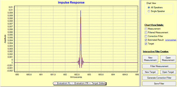

The only requirement is to apply a group delay correction procedure such that the left and right speaker have basically the same frequency response inside the subject time domain window after correction. The top end has a particularly huge impact on the impulse response close-up and have to be corrected all the way to obtain that kind of symmetry.
I have attached a simulated response after correction of L+R speaker together with the target response.
The simulation shown is simply the original measurement convolved with the correction filters. No other filtering applied.
The correction procedure used is an overkill procedure that performs a full time & frequency domain correction by the direct sound approach. And without any conditioning of the measurement. This procedure corrects every tooth in the comb filter with up to 50 dB. So a one-eared person with the head clamped in a fixed position, full climate control etc etc.... can enjoy perfect sound. 😎
Seriously, this procedure is not for real life use. Its usefullness is limited to testing the correction capabilities of Audiolense. The RMS of the corrected IR (not shown here) drops to -60 dB right away and the room decay is attenuated down to about -70dB shortly after. This is probably a big enough correction muscle for most user requirements in most practical situations.

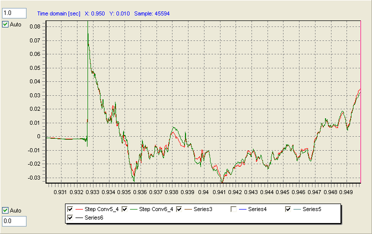

The brute force approach is a nice illustration but as you already admit not realistic and would actually sound bad.
What I was getting at was matching like you've shown with the brute force approach but still attaining good sound without over correction. Can Audiolense still closely match the pulses yet still have a correctly conditioned correction?
If I gave you two pulses(left and right) for a pair speakers I have can you get effective but not over corrected filters and closely match the time domain signatures?

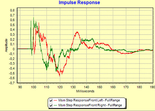

Attached thumbnail shows step response of uncorrected speakers. The speakers have a rather symmetric positioning. But the measurement position is asymmetric. Thus, the reflection pattern from the two speakers are very different.

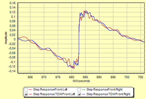

Next thumbnail is a step response after a group delay correction by the direct sound approach. The correction lasts for a frequency dependant window of 5 cycles, which is very moderate.
The channel symmetri is IMO quite good, allthough not as good as in ShinOBIWAN's example. But it remains to be seen which is more important: Correlation with each other or correlation with a target response.
Another thing worth mentioning: The step response after a group delay correction - or any time domain correction - will be less clean than after a minimumphase correction. The *direct* sound is affected by later reflections due to the time shifting in the filter.
So this figure isn't 100% comparable to the minimum phase (?) prefab element that ShinOBIWAN posted.

BerntR said:The following thumbhail shows the stepresponse from a TDW'ed simulation.
Are you saying the data your showing is a simulation or predicted response?
The measurement I showed above was an actual capture of a stereo source at the listening position.
