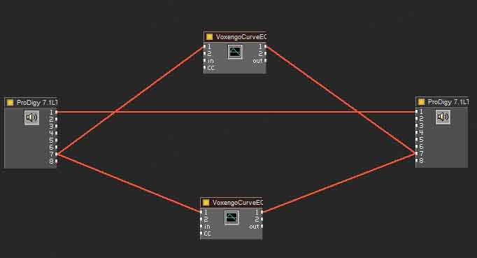

Ok, I feel pretty retarded, but I'm going to need some more help before I can correctly use CurveEQ (yes, I read the docs, I think they suck). Attached is a picture of the setup I'm currectly using, just a simple test setup with one instance of CurveEQ per channel. I have my line-input routed to input 7 and 8 and my microphone is connected to the left side of the line-input (coresponds to input 7 in console). I made a sweep wave file and I'm playing it through Winamp.
CurveEQ wouldn't register any input unless it was connected to an output (is this right?) so I connected it to an output on the card I don't use. My plan was to capture the input from the line-in and then once the spectrum was captured, save it, and use it in an instance of CurveEQ that was then actually connected to my real input. I used the little 'C' button and then played the WAV file in an instance of CurveEQ and it seems to work fine, from the monitoring lines I could see it slowly work it's way through the entire spectrum. One thing I found strange is that the spectrum was sloping to the upper-right as it went along and I know that my system can't have a constantly rising response, can it?
Anyway, once I captured the spectrum it told me that I had a spectrum available, but nothing appeared in the CurveEQ graph window, so I assume I use the 'M' button to match the specturm (how many points should I use? I figured about 30). Once I told it to match the spectrum it seemed to start another capture process and it said "matching spectrum". At this point I could again seem the input from my microphone being captured. I wasn't sure what to do so I figured I'd play the sweep again. Once it was through I hit the 'S' to stop the matching. Then what appeared was 30 points outlining what I can only assume is the difference between what was captured the first time and what was captured the second time. This really doesn't help me =).
I swear I've read the docs, but they seem really really brief on the SpectraMatch section. Shin, HELP! =)

Sure, I've looked at all of these cards actually:
ESI Juli@: Good card, uses Directwire and has ASIO2 support. Essentially the same from a software prespective as the Audiotrak Prodigy 7.1LT which works great. Only problem is that this card is 2-analog-in, 2-analog-out. So all you could really do is DRC a stereo setup, no crossovers.
E-MU Series: Looks like great hardware, it supports ASIO which is the important part. It is not known whether or not you can route inputs through software ("internal routing") so you'd have to buy it and see or call Creative and ask.
Audiotrak Prodigy: Audiotrak Prodigy 7.1 and 7.1LT are essentially the same card that has been laid out differently. The 7.1LT is the successor to the 7.1 and has a smaller form-factor (and is cheaper). It is also considered to have superior sound quality because of the new layout. The 7.1 is no longer available. The 7.1LT is available at newegg and other places. If you see references to the 7.1 at online stores, check their inventory, they're out of stock and haven't update their websites yet.
