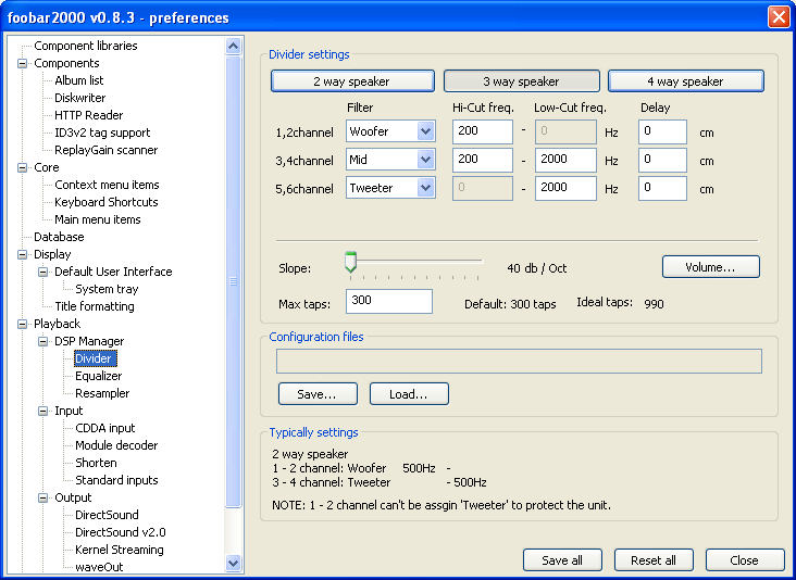

To offer a counterpoint to all this talk of this particular PC XO solution I'd like to post this discussion between me and Thylantyr. That way folks can make an opinion based on conflicting viewpoints regarding performance. Its not a question of who is right but rather give others an insight of the issues surround performance compared to other solutions.
This is the best place for this I feel and it saves cr*ping in noobs speaker thread from which this discussion has been taking place before this thread was created.

Originally posted by Illusis
Sooo...what would you(whomever) recommend as the most minimalistic set-up needed for simple stereo playback?
Here's an idea. Foobar 2000 as your media player with a diy frequency divider plugin. Download plugin here.
Description of the divider plugin from another forum:
1.1 Benefit
Easy to build multi-way loudspeakers without trying over and over
auditions and re-designing on LCR(passive) filters.
You can setup multi-way loudspeakers without any LCR,
actually we have verified 2 way with 18H52 x 2 + Raven R2 ribbon.
It sounds excellent!
Linear phase(group delay) , no interferr with other driver units
because of steep FIR filter. Just read the driver specifications
and calculate efficiency differences between drivers.
And offset level and select appropriate frequency for driver
combination. That's all for your multi-way loudspeaker design.
Incredible? Yes , for me it was incredible at first, that's it!
We have distributed Scan-Speak/Vifa (DST), Manger ,
Thiel & Partner , SEAS , Raven ,Audio Technology DK....
This makes us easy to build new driver based loudspeakers!
1.2 Feature: wriiten as follows,
Version 0.34 frequency divider plugin (DSP plug-in) foobar2000.org
These specifications will be changed without notice
Name: Fequency Divider Plug-in for multi-way loudspeaker drive
Usage: used with foobar2000.exe as components
Input: foobar2000.exe data stream (Currently tested was CD-DA,Wav 44.1KHz)
Output: foobar2000.exe data stream ,
Stereo , Stereo 2way , Stereo 3way , Stereo 4way frequency divider.
Multi-way environment is decided by CPU performance.
I/O Devices: depends on foobar2000.exe and plug-in support
Filter specifications:
Filter Characteristics: FIR / linear group delay
Calculation Method: Fourrier Transform with Kaiser Window
Data Precision: 64bit double precision calculation
Filter slope: depends on the number of Taps specified at divider menu.
If max = min(MaxTaps , IdealTaps) is selected,
- High frequency Cut slope is steeper than 90dB/oct slope.
- Low frequency Cut slope is same or steeper.
Attenuation of frequency out of range: -100dB (depends on bit resolution)
Add a multichannel sound card, maybe on the motherboard, and you're set.
Here's a screen grab of the Preferences in Foobar showing a 3-way crossover built with the plugin:

Vil and I discussed Foobar divider before. There seems to be a problem with the tweeter crossover.
Vil took measurements with divider and posted it in this thread.
http://www.diyaudio.com/forums/showthread.php?s=&postid=661511#post661511
I remembered playing with it and got the same weird response, I think a workaround would be to use 4 way for a 3 way etc.
The nice thing about divider is adjustable taps, in theory you could be down to 5ms delay with a 400-500hz crossover
You have a minimum of 60ms with waves lin eq

have u tried to use the tweeter as a midrange ?
just limit it's highs to 40khz or so ,and measure it ?
