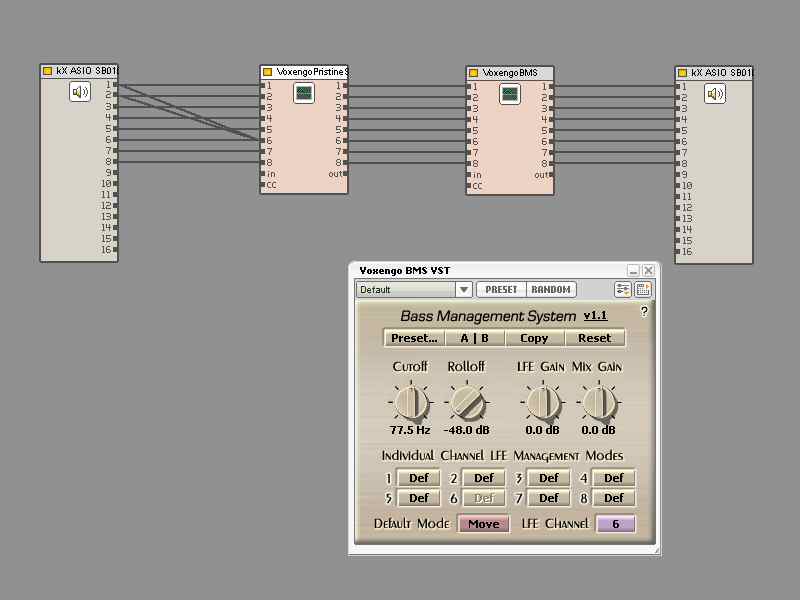

I see, OzOnE 2k3 posted an image with the Audiotrak routing panel on the last page. I somehow assumed this was your card.
I'm not sure I remember anyone ever getting console to work satisfactorily as a PCXO for universal playback of any audio stream in conjunction with an M-Audio card. I've been out of touch with this thread for so long now though that could have changed.
M-Audio don't have loopback so you'll loose physical outputs from having to route the audio manually in order to avoid conflicts. Last time I looked only the cards from RME, Lynx, Audiotrak and the Emu 1820/1820m could do this. I can confirm that these cards all work flawlessly with Console:

Sorry for the confusion. The screenshot of my Audiotrak driver was given merely as an example of how I have Console set up in the hope that cowanrg might be able to find a method for his card.
Hopefully, I'm sure the Lynx card will have internal routing of the audio channels, and can also bridge between WDM / DS and ASIO.
I think Console is an excellent method for applying DRC, EQ, XO, speaker delays, and anything else you can think of. Plus, it allows you to apply almost any VST effect to any combination of channels.

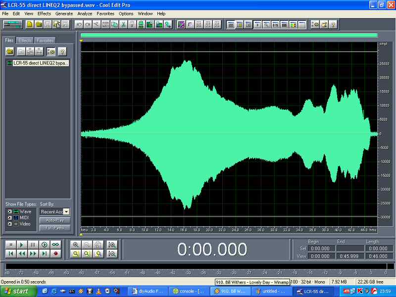

I might be going a bit off topic here, but I've just made a sweep measurement of one of my M&K LCR-55's using my home-built mic preamp and Panasonic WM-61A capsule....
All DRC and EQ effects were bypassed, the mic was positioned about 20cm from the speaker, and a quilt was placed over the mic / speaker to cut out the room noise etc...
Does anyone here think that the frequency response in the attached screenshot looks fairly normal for a direct measurement? I know the frequency response of your average speaker is never going to be completely flat from the start, but does the screenshot point to any major problems with my mic and / or preamp?
The first big peak is around 160Hz. Could this possibly be a problem with my mic? (I would have used the FFT function on Cool Edit, but it usually crashes.)

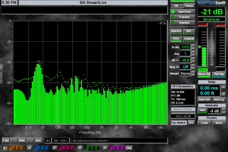

I've attached a screenshot from Smaartlive which shows the general frequency response of my mic. This was taken with no signal playing, only the noise of the PC fans (I know - I need some fanless PSUs!). The big peak around 50Hz is definitely mains hum, and I'm confident that it's just the cheap cable I'm using. I will get some decent audio cable very soon.

Hi OzOnE,
can you show the sweep measurement with a sweep in the range 150 Hz to 20 kHz instead of 20Hz to 20 kHz. This means that you do not have 50 Hz in your source signal. What is happening then?
If SmaartLive still shows 50 hz then you first have to get rid of the 50 Hz problem, maybe it is a problem of a groundloop. Try then e.g. to disconnect earth from the PC (isolation taper at the main plug)

Hi, Uli,
The rest of the noise above 150Hz is mostly fan noise and noise induced on my cheap mic cable. The big problem is the 50Hz noise, but I think you may have an answer.....
I realize that ground loops can happen when you are connecting between two bits of equipment, but I didn't think you could get a ground loop (as such) on a mic input when there's nothing connected to the other end?...
But then again, is it possible to get noise or mains hum 'induced' onto the ground level of the PC / mic? I never thought of disconnecting the ground pin of the PC before, but seeing that the amp, TV, and DVD player all have 'floating' grounds, I can see how the PC and sub being grounded might cause problems.
I actually have an extra cable connected between the chassis of the PC and the amp already - The noise on the mic input is even worse without connecting the grounds together directly.
I will try disconnecting the ground connection of the PC some time. Thanks for the suggestion!

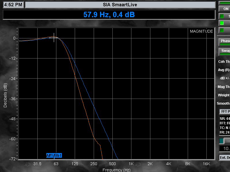

I was going to post this in new thread, but I couldn't find a suitable place for it, so I'll stick it here for now (@mods - please move this post if it's in the wrong place!).....
I've just been playing with Smaartlive, and testing the crossover responses of my Denon amp (to see how well I could match VST crossover filters to the Denon's) - The following was done by sending pink noise via the SPDIF input on the Denon, then measuring the response from the 'Pre-Outs' using the sound card's line-in.....
My Denon AVC-A11SR is set to 'FIXED THX' (80Hz) crossover mode, and I always assumed before that the crossover filters should be applied to the speakers no matter which mode the amp was in (apart from EXT IN of course)....
But, to my great surprise, the Denon does NOT apply 80Hz HP filtering to the main speakers if it is in DIRECT or PURE DIRECT mode!!! It does however always apply the 80Hz LP filtering to the sub output in all modes. This is not really explained properly in the user manual, and is quite worrying for non full-range speakers like mine!
I normally listen to music in DIRECT mode, and this meant that my poor M&K LCR-55 front speakers were starting to clip quite early on when approaching higher volumes, as they are only really rated from 85Hz to 20KHz!
A test tone at around 30Hz confirmed that the front speaker cones do indeed wobble in and out in DIRECT mode. The HP crossover filter is properly applied when in STEREO mode, and the sub then handles the all the bass duties as it's supposed to.
This issue was no doubt affecting my DRC measurements for a couple of reasons ie....
1. The LCR-55's aren't really designed for frequencies below 80Hz. They're not THX certified, but afaik many THX speakers aren't rated for much below 80Hz either.
2. The bass output from the sub probably 'conflicts' with the front speakers as I don't think the Denon compensates for the sub and front speakers all playing frequencies below 80Hz!
(Obviously, the idea with an HTPC is that the crossover filters will be applied at all times.)

Hi OzOnE,
you have posted two pictures. The first showing the recorded sweep and the 2nd is a FFT picture.
It is not clear to me if both pictures belong together. What is the frequency range of the sweep. The FFT picture goes up to high frequencies with a quite high level (is this really only noise above 150 Hz).
So I propose that you do a logsweep measurement from 150 Hz to 20 khZ and a 2nd measurement from 20 Hz to 20 kHz. This will result in 4 pictures (2 sweep recordings, 2 FFTs). Then we can clearly see what happens around 50 Hz.

I'm certain it's definitely mains hum on that mic. I don't know what that high frequency 'ramp' was in the second image, but it appears to have gone now? (It was probably something looping back wrong in DirectWire?)
I've made some progress since posting those images, and I have a VERY good sounding DRC filter now. I few things made the difference with the resulting DRC filter: firstly, I was able to get rec_impASIO to work properly....
The main problem before with rec_imp was that I was expecting to see the impulse peak when I opened the recorded file using Cool Edit, but I can only seem to see the impulse when I open it as 0.24 format??
I know that DRC is supposed to work with 16.8 format PCM files as default (with BCInFileType set to 'F'), but I can only see the peak under Cool Edit when I open the file as 0.24 format? The peak is much lower in amplitude than the Aurora generated impulse, which I'm guessing is due to the fact that I have 'Autorange Result' (normalization) enabled under Aurora (as per Jones Rush's guide)?
When I try opening the file in 16.8 format, I don't see the peak at all? This is strange, because it still appears to work fine with DRC? I know that DRC is actually working OK when using the rec_imp files because I can see a correct impulse response under Pristine Space.

I have tried the Bass Management plugin a few days ago, and it seemed to work OK, but doesn't have enough channels to include my back surround speakers....
I tried editing the source using SynthEdit, but I couldn't figure out how to add extra inputs and outputs to the software. I looked all through the help menu, but still couldn't see how to work it?
Also, the channel numbers don't match up with the ASIO standard numbering for each channel, so it's a bit fiddly to connect up in Console.
I've have Voxengo BMS working atm, but the only thing it's missing is that it doesn't perform LP filtering on the LFE channel. I need this to work really as without LP filtering on the DRC filter, I can hear speech etc. through the sub.
The reason I need LP filtering on the LFE channel is because I prefer to use a separate DRC filter for the subwoofer when listening to 2 channel music. So, on the attached screenshot, you can see where I've connected input channels 1 and 2 through channel 6 (LFE) on Pristine Space first. This lets me use the separate DRC filter on channel 6 of Pristine Space before it passes to the Bass Management plugin.
I think that BMS performs a LP filter on the low frequencies from the main channels, but it doesn't LP filter the LFE input (normally channel 6), so it passes full range from input 6 through to output 6! If only it had LP filtering on the LFE channel it would be almost perfect for what I need.
The only other things that would be nice is a way of choosing separate rolloff settings for the LP and HP filters. The reason for this is that I'm fairly sure my LCR-55 speakers have a 2nd order rolloff already (like THX speakers), so it would be great to be able to choose a 2nd order HP (12dB/octave) for the main speakers, and a 4th order LP (24dB/octave) for the subwoofer.
The result (due to the front speakers' own 2nd order rolloff) should be a good 4th order HP and 4th order LP.
So, the question is - does anyone know of a better way of handling the subwoofer output when playing 2 channel music into Console? The idea is to create the same kind of processing as my Denon amp does to extract the low frequency bass from 2 channel music, while still allowing the LFE channel from DVD's etc. to pass to the sub. All this, while keeping the levels correct, and doing the proper LP and HP crossover filtering!
I really need permanent crossover filtering on all speakers so they match with the sub properly, and so I can do the sweep measurements for DRC correctly with the proper crossovers in place.
And does anyone know how to use SynthEdit, so I can add the extra things to Angelo's plugin? If I can edit things in SynthEdit, that would be the perfect solution, as it already has some decent (yet simple) crossovers etc.
Edit: Actually, scrap that last part - I've just found how to add new inputs / outputs to SynthEdit.... You just connect the "spare" input or output to a filter (or something), and it creates a new one. This should have been obvious really!
I should be able to add some extra bits now, and I'll post the new plugin on here if it works.
Thanks.
OzOnE.

Hi all,
I think I'm getting somewhere with SynthEdit. It's an excellent program, and not too difficult once you play around with it for a while.....
I've now added the extra channels to the Bass Management plugin, and I think the channel order is correct now for ASIO (well, at least on my Audiotrak under Console?)
I've also added an attempt at switching between a 2nd order or 4th order LP for the sub output, but I'm not sure where to put the switching part and filter in the audio chain? When I put it near the input, it didn't seem to switch between the two filters, so I put it between the 10dB boost instead.
In the attached screenshot, I've tried to capture the slopes of the two LP filters for the sub output using Smaartlive. I don't think it looks right, but it's a start. Hopefully someone can figure it out.
I first tried cascading two 12dB filters to create the 24dB filter, but it didn't seem to work, so I downloaded a 24dB filter module instead. I'll attach the new BassManagement 7.1 source and the new LP filter module in the next post.
OzOnE.
