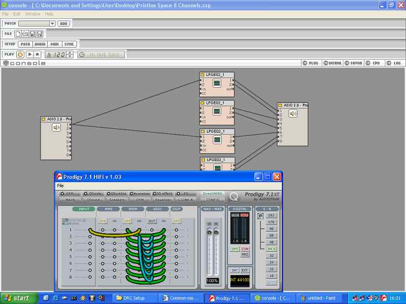

Hi all,
I think this is my first post about DRC in this forum.... I wanted to share with everyone my progress so far in case some of what I've found is helpful to anyone....
I've been following the DRC thing for many months now, and initially started messing around with my old SB Live card, knowing full well that it resamples, and probably wasn't worth my time.
So, I finally bought an Audiotrak Prodigy HiFi 7.1 card about two weeks ago, and I've got it set up on a separate PC with all 8 channels connected directly to a Denon AVC-A11SR amp on the EXT IN inputs.
I also got hold of some WM-61A mic capsules (a bit difficult to get hold of in the UK), and built a quick preamp with an OPA2604 opamp....
(I'm using the normal.drc file included with the DRC package and sampling at 44KHz btw.)
The first impulse I recorded with a modified WM-61A and the original preamp sounded pretty boring and a bit harsh with the "flat" target curve on DRC. So, I changed the target to BK.txt, and it was much warmer and solid sounding... Maybe a tad too warm if anything.
The main problem I'm having is working out which is the best method of recording the speaker / room impulses, and which method most accurately represents my room??
So, I spent a bit of time earlier comparing impulses recorded using the Cool Edit / Aurora method, and using rec_imp. Once I figured out how to use rec_imp (again), the resulting DRC filters sound VERY similar.
I think it's safe to say that either method is worth using, as they both seem to produce extremely similar sounding filters. In fact, I must explain that I don't have a proper loop back signal when using rec_imp, and I'm looping back a digital signal instead using Directwire on the Audiotrak driver. So, the slight difference in sound from the Cool Edit method is probably due to the direct loop back.
It's difficult to explain, so I've attached a screenshot instead.
With the Cool Edit method, no loop back signal is used, but with rec_imp, I've bodged it a bit to make it work. In the screenshot (attached), you can see that I've connected the left channel of the microphone input (line in / mono in this case) to WDM input 1. I then use rec_impDS to record the sweep via the DirectSound (WDM) interface....
I also have to loop back each of the 8 ASIO outputs back to WDM input 2, so that rec_imp receives a direct loop back signal (the reason for looping all 8 outputs is because the sweep is obviously only output on one channel at a time. ie. it doesn't "stay" in one place.).
But, here's where it gets much more complex.... Because I eventually want to record the log sweeps of each speaker for 6.1 / 7.1 surround, the WDM (DirectSound / Windows) output is redirected into the ASIO inputs, I then use Console to be able to route the signals to any "real" output channel that I want.
So, when I record a sweep of say the "front left" speaker using rec_imp, I simply connect ASIO input 1 (sweep output from rec_imp) directly to ASIO output 1 (real front left output to amp). I also connect ASIO input 1 to ASIO output 6 (subwoofer), as you can apparently record the main speaker signals with the sub still connected, and DRC takes care of the rest.
But then (wait for it!), I realized that I should have some crossover filters for the main speakers so they don't receive the really low frequencies, which could possibly damage them. So, under Console, I'm using the "LinearPhaseGraphicEQ 2" VST plugin on each output channel to work as crossovers at 80hz.
Once I've recorded the impulses for each speaker, I run them through DRC (using normal.drc / bk target), then I use Voxengo Pristine Space VST as the 8-channel convolver. (Thanks to ShinOBIWAN for the tips, and whoever else who has mentioned similar progs!)
Ok, so the questions are....
Does anyone here think the LPGEQ2 filters are good enough for using all the time (even while recording the sweeps through them)? The reason I chose this plugin is because it has very low latency, as I want to stream TV audio through the PC. I also had trouble finding anything better so far. Would the slight latency of the filters / ASIO affect the log sweep recording?
Do you definitely leave the sub connected while recording the sweep through each main speaker? (my sub is an M&K VX-4, which unfortunately is sitting in the rear-right corner of the room).
Is there a way of calculating whether or not the log sweep you've recorded has a decent SNR, and if the mic preamp gain / input level gains are correct? ie. "quality" of log sweep recordings?
Does anyone know if the Denon A11SR still applies the bass management (crossovers) when using the EXT IN inputs?
If you untick the "autorange result" box in Aurora (for convolving the sweep with the clipboard), is this then similar to the way rec_imp works? ie. NOT normalizing the impulse(s)? I only ask because I want DRC to correct the relative channel levels as well as everything else.
Oh, and btw, the seriously bad (hollow / harsh) results I was getting with DRC before were due to not having a preamp connected near the mic, so I was getting a huge "peak" of noise at 50Hz on the recordings (mains hum). This happened with both the SB Live card, and the Audiotrak Prodigy, so it's not just a sound card problem. Please make sure you find a decent mic preamp! (I'm still using two bits of cheap audio cable joined together, so that doesn't help either).
OzOnE.
P.S. Apologies for the huge post - I may have to trim it down a bit in future. 😉

I did some more messing with DRC yesterday, and found that I can't seem to make a DRC filter which sounds as good as the very first one I made when I got the Prodigy 7.1.... This measurement was done by simply connecting the front outputs of the card directly to the EXT IN inputs on the amp and measuring each speaker in turn. The right channel output of the sound card was left connected to the subwoofer pre-input on the amp.
The only difference now is that I now have all 8 outputs from the sound card connected to the 8 pre-ins on the amp, and to measure each speaker, I'm connecting each channels virtually using Console / ASIO ?
Would there be any obvious reason why doing the log sweep measurements while sending the WDM output through ASIO / Console would affect the results?
I don't think it has to do with the 'fake' loop back I'm using with the Prodigy drivers, as the results are very similar between using the Cool Edit method (no loop back) or rec_impDS (digital loop back)?
The original DRC filter I made sounds much warmer and nicer than anything since. The only thing that has really changed is directing the sound via Console during log sweep recording? The mic / preamp is the same, the mic position is the same, the volume and all levels are roughly the same (within a few dB's)?
I suppose I'd better try a more direct measurement tomorrow without going through Console. The original idea was to use rec_impASIO to measure each speaker automatically (using a batch file), since rec_impDS only 'sees' two channels. But how do I handle the loop back signal with rec_imp? Can it be left out altogether?
I was also getting audible clicks and glitches when using rec_impASIO (buffers might need increasing) - is it generally preferrable to use ASIO instead of DS for recording the log sweeps?
Oh, and has anyone else found major differences in the frequency response between unmodded and modded Panasonic capsules?
OzOnE.
P.S. Again, sorry for going on a bit, but DRC throws up so many questions!
