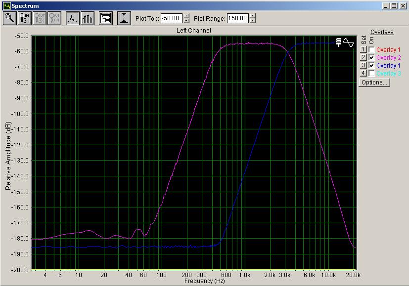

Hello folks out there,
reading this forum I found a lot of discussion about audio filters, ringing, steepness, linearphase and all that stuff.
Some time ago I started a project building a real nice standalone (96kHz, digital in, analogue out) fanless BruteFir engine. The engine is up and running now and I currently operate an active tri-amping setup with XOs and DRC on it. The audible result is really phantastic!
During the last months I read through a bunch of research literature regarding linear phase filters, audibility, room correction, jitter theory and all that stuff. I decided to share what I have learned during this project with you hoping it would help you on your way to your optimal High End Stereo System.
Today I will start with XOs.
I have prepared an article for you with my research, thoughts, experiments and tools regarding the "Perfect" XO for High End Stereo Systems ( see: http://freerider.dyndns.org/anlage/MyDrc/Perfect-XO-for-High-End-Stereo-Systems.zip ). In this article I also reference some freeware tools for XO calculation and coefficient generation for BruteFir or other convolvers.
Hope this material would be useful for you.
Charly

Read your paper, very interesting. Anymore details you could provide about your particular implementation (hardware and software) and also if you wouldn't mind showing examples of the files that you generated and how you implement them. I generated a few filters using the spreadsheet, but when I graph them using Excel they seem to simply oscillate back and forth between ~1 and ~-1. Is this correct? I'd like to try to implement these, as well as DRC filters, using BruteFIR when my dedicated hardware arrives.

there is pretty interesting Linear Phase EQ :
http://refinedaudiometrics.com/products-plpareq.shtml
they say " Phase Linear Operation is achieved by processing your sound in both the forward-time and reverse-time directions through classic filters - all in realtime. This completely removes the phase warping caused by IIR filtering "
so thats not FIR but IIR filter with linear phase . I tested it , phase is really linear , and there is no frequency ringing up to -140dB .
>>>>I believe this is how the Weiss EQ1-LP equalizer performs its linear phase filtering
yes , thats true . more info is here :
http://www.weiss.ch/eq1/images/eq1-lp_update.PDF
Vil said:they say " Phase Linear Operation is achieved by processing your sound in both the forward-time and reverse-time directions through classic filters - all in realtime. This completely removes the phase warping caused by IIR filtering "
Who sais it's fot FIR filteren. Since it uses both future and past samples, I bet this is simply FIR filtering, but they don't want to tell you
