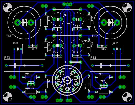

What do you think of this PCB?
The blue lines are on the soldering-side(bottom), the red lines are on the other side(top), and the picture is viewed from the top side, where the tube, and all other tings will be.
The tube is an E88CC, and the schematic is the schematic, that SY posted in the beginning of this topic, except the input-trafo.
On the PCB there are 2 schannels.
All resistors are 0.6W 1% metal-oxide type.
Here's the PCB:
http://sziget.mine.nu/~danko/aramkor/tube-amp/sy_preamp_pcb.png

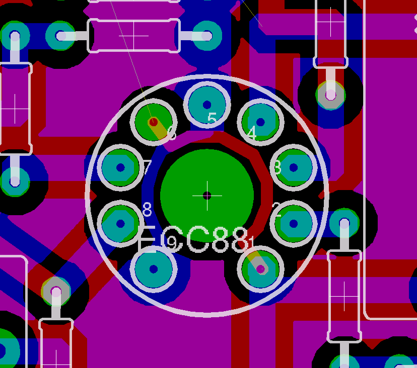

Yvesm said:
Danko.
It seems that you could feed the pin 4 shortly by routing the track between pin 1 and 9 and below the tube (I see you already have a thru hole for the pin 1.
The same way, pin 9 may be routed to pin 5 below the tube.
Something, like the attached picture?
Eagle is a pita to route analog signals :xeye: :bawling:
Why?

Danko said:
......What do you think of this PCB?
.....and the schematic is the schematic, that SY posted in the beginning of this topic...
I don't see any LEDs and emitter resistors in your CCS. I do see CR networks at the inputs, which do not exist in the original schematic SY posted. Also, your grounding is quite confusing and you're mixing power and signal grounds, which can't be good. You might wish to ask SY if he uses separate RC networks in +B supplies. Also, in SY's design, pin5 is not connected to the ground plus your routing of pin4 is too complex; try rotating the tube by 180 deg.

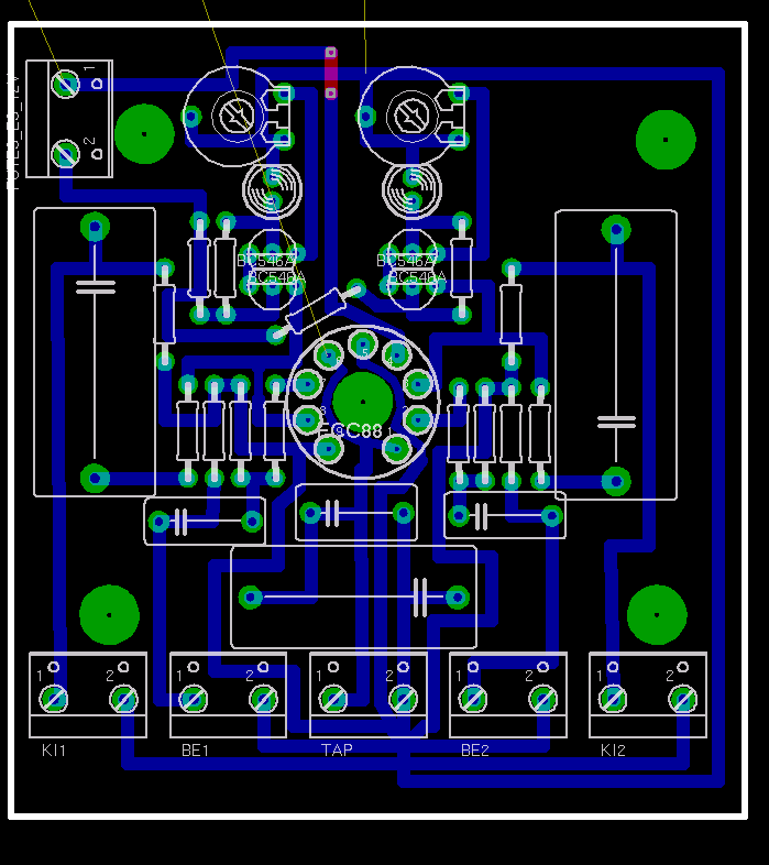

Making PCBs with huge grounding planes is not always the best of approaches. As an exercise, I would suggest designing the board as a single-sided PCB. The picture below shows a similar design of my own (battery-powered tube buffer, ECC86, FET CCS, autotransformer at the output) that migh give you a clearer view of what I am talking about.
Milan

Milan, I used a common raw supply and separate RC filters. I thought I was clear about that in the text, but apparently not. I'll edit to emphasize this. Thanks!
I will never be able to look at multilayer board drawings and figure out what the heck is going on. I'm glad there are guys like you around.
Yes, I left you the input trafo, becouse I dont need it, and I put an RC-network to the output.
Huh, thanks! I will redesign the PCB, to something like yours. I will try to make a central GND-point, and route all gnd into that point.
I will reduce the track width, becouse I see that you use thinner tracks.
The drawing is better but maybe I should highlight a couple of things regarding SY's original schematic (not any variation thereof):
1) pin5 can't be connected to the ground,
2) CCS can't be connected to the ground but to -12V PS,
3) +B supplies should be separated.
However, if you wish to do a variation of SY's design (CR network at the input and so on), I think a new thread might be in order.
Milan
P.S. It is a common view that routing tracks under the right angle should be avoided.
