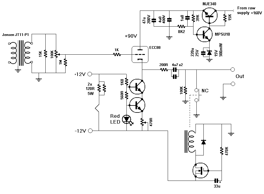

Sy,
- why did you put a 4uF/400V in the "B+" ? What if I put there a 200V capacitor?
- what voltage rating should be the output capacitor?
- what voltage rating should be the input capacitor, if I would like to omitt the transformer ?
- what specific transistors do you recomment for the current source?
- If I have a separate winding on my transormfer for heating the tube, do I need that 2x120 resistors paralell near the current source?
Thanks! 🙂
P.S.: I tried to edit my previous post, but it took me too much, and the 30minutes editing period expired, I couldnt edit that post 🙁
You're right, I forgot to spec the transistors. I used NTE199. There's nothing special about that choice- it was based on what rattled out of the coffee can first when I shook it. Anything with a BVceo of 50V or better, an ft better than 10MHz, and a beta of 100 or greater will work. The NTE is a 50V device, ft of 90MHz, beta of 400, and costs under a buck.
The plate bypass cap can absolutely be a 200V device. I used a 400V cap because that's what I had on hand. If I were to rationalize, I'd say that it was to give me more flexibility on tube choice. For this tube, the extra voltage rating isn't needed.
The output cap will never see more than 15V. It can have any voltage rating you like. I had some Rifa caps with a 160V rating that I used, but a 63V Wima will be perfect there.
Likewise, any input cap will never see high voltage.
The heaters here are running on DC. If you use your winding (presumably 6V?), rectify and smooth it, chances are that you'll still need the dropping resistors, but you'll have to recalculate the value.
What about BC546B ?
Thanks!
What do you recommend? What "MKx" type?
Or it doesnt matter?
Yes, the heater is running from stabilized DC. Do I need thoose series resistors, even if I'm using soft start for the heating?
In Post #20, you wrote:
Yes, you can build one without the input transformer, but you may find it of great value even with your simple setup. I'd probably RC couple if I were to go the non-transformer route.
You mean under "RC couple" a single series capacitor with the input, and a resistor, between the GND and the capacitor, aren't you?
I just used some off-the-shelf rectangular power resistors for dropping the heater voltage. In theory, since the ECC88 has parallel heaters, it should be fed by a voltage source, not a current source. I'm not convinced that it's a big deal either way, so a resistor splits the difference in a Solomonic fashion.
Input RC? My personal inclination would be to use 0.1uF and 1M, inserted between the wiper and the grid. That choice is based on careful consideration of the position of the low frequency rolloff traded off with grid leakage current and my religious belief in not using large coupling caps whenever possible. And dictated mostly by what I have in my coffee can, which at the moment is flush with 0.1uF caps.
Using the same PS for heaters and CS biasing doesn't look good to me.
Would it not be better to use 12V for heaters supply? Power waste would be smaller, and, more importantly, you would be able to isolate heaters PS and CS bias circuit PS.
Milan
Milan, I'll give you a sneak peek- the +/-12V supply will power an opamp in the next version. I hate that output capacitor and will show how to be rid of it.
The heaters are actually a positive here- they have a very constant draw and help load down the 12 volt regulators. This was a trick I picked up from Dave Berning.
AFAICT, a heater is a heater. It is just a resistor that gets hot. Before the 1930s, heater resistance was not tightly specified: apply rated voltage and it would work fine, but the current was not always what the book said. Then came series-string radios and especially TV sets. If a tube heater's resistance was way off from nominal, it would over- or under-heat, and work poorly. So they got more careful about heater resistance, and about the change of resistance from cold to hot. At first only for the 5 tubes used in radios, but TV sets used about every tube in the book, so they made all heaters to tight specs for voltage, current, and warm-up.
Since utility power is basically voltage-source, it is usually most efficient to feed heaters a voltage source. But whatever turns you on.

Did you say regulator? Since I got drafted into child care today, I'm running behind on drawing and write-up for the power supply. As a quick preview, here's a drawing of the B+ regulator (and yes, there is some definite logic to using a simple two transistor job).
