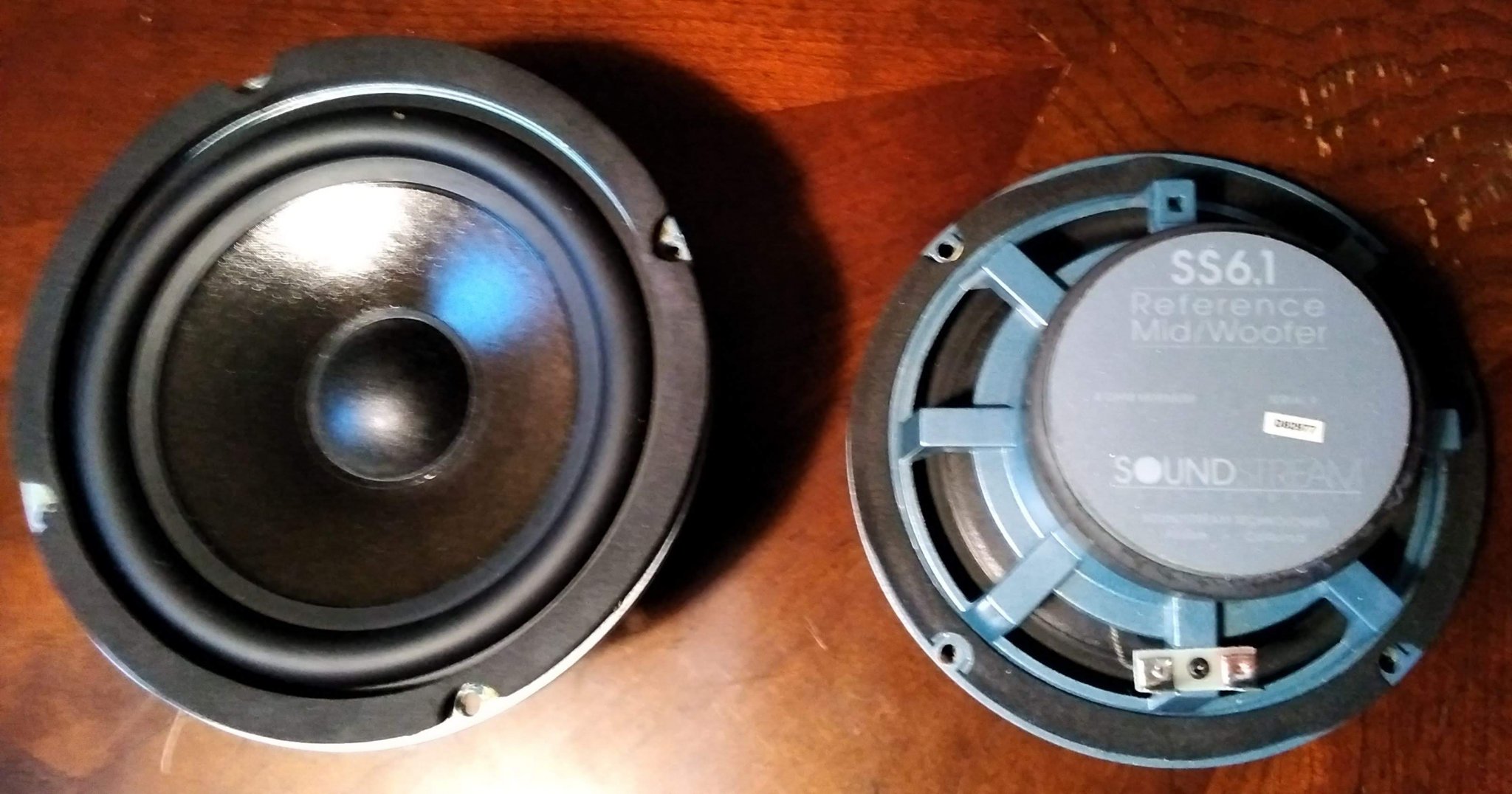

A Hail Mary! T/S Parameters or other information on (old school) Soundstream SS 6.1 Reference 6.5" woofers?
Hi, all!
I realize this is a long shot, but might anyone have any information (complete T/S parameters ideal!) on these drivers (pictured). I bought these in 1996 (wow... been a while!). I've brought them out of storage and am putting them in a new install (considering making mid-bass enclosures). I've scoured the internet and NOTHING. I even contacted Soundstream and couldn't get an answer.
So... hoping that the stars align and there's an old-school car audio Soundstream aficionado who might have a clue!
Thanks in advance for your help!
Yep, that is all I could find too
Basically seems like the passive crossover they had was 24 db
which had impedance compensation as mentioned by manufacture.
other than that they mention recommended 3000 Hz crossover
with active systems.
So seems about the norm for soft dome tweeter.
and to calm the usual breakup from a woofer around 3 to 6k
if for midbass and using a sub.
they would likely be fine in a sealed box around .8 to 1.5 cubic feet
far as a reflex alignment , unlikely

Thanks for your input, Dragon. I think I'm going to abandon the idea of doing a sealed enclosure in the door and just run them IB. I've treated the heck out of the doors, so we'll see how they perform!
Depending on where your located, might be a local speaker geek willing to measure them for you. Even better if your willing to ship them to someone for measurements.
That's a good idea, Planet. Frankly, that never even occurred to me. There's an audio shop that's been in business over 50 years now (seriously) right down the road from me. Maybe I'll give them a call. Fingers crossed!
