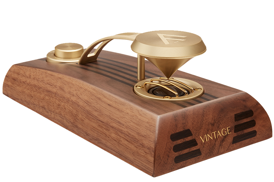

Also Fyne Audio, (the guys who quit working for Tannoy after it was sold to china, I hear) they produce the SuperTrax, an up firing tweeter with a reflector, made for 16khz to 60khz, with the idea you might not hear it, but you can feel/perceive it.
the product
https://www.fyneaudio.com/product/supertrax/
the blurb
https://www.fyneaudio.com/supertrax-series/
