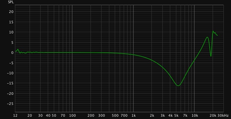

I did some work tonight with REW, calculating the predicted combined response at each ear based on the differences in timing of each signal from the 3 speaker array with about 1 foot spacing and listing about 7 feet back to a side panned signal. I think this clearly shows why it works so well. Below 1000 Hz it's mostly phase that gives us directional info. At 1500Hz it's a mix. By 2000 it's mostly level difference. You can see that the array starts to create a level difference around 1000 Hz that gets stronger for a while until it looses power, and eventually at higher frequencies actually goes backwards. This has prompted me to roll off the extreme highs on the side channels. I thought I was hearing that! My attempts at measuring were showing that reversal too.
In any case, I think this calculated response difference of between each ear for a side panned signal provides a solid explanation why the 3 speaker array works to create a wide stereo soundstage. This doesn't show the phase difference that's happening below 1000Hz, but it is happening. I should add that I think if you start getting strong level differences below 1000Hz through recursive crosstalk reduction it's going to create a strong impression of sound sources right next to your ear, because that's normally the only way that can happen. So it's great for special effects, but for normal musical listening we don't need that much crosstalk reduction.
